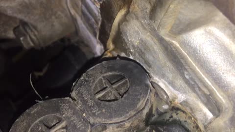

Furthermore, I noticed a water leak coming from something that sits just behind the thingy that the plug leads come out of? I do not know if that is the coil? But the leaking thing is behind what I think is the coil. (Video attached) Please tell me what this is called and how the leak can be fixed?

Thanks for the video. It is hard to tell form the video where the part is that is leak is located. also, can you film about the part to make sure coolant is not leaking from above and dripping on it. Trial and error is sometimes the only way. We will get through it though.
I believe your car has a timing belt correct? If so lets pull one spark plug and do a compression test. this will tell us if the camshaft has jumped a tooth.

Thank you, I will try film the part later and post it. I do know the radiator has coolant leaking somewhere but not enough to cause overheating. I used to top up every four days or so. Now with this new leak I top up daily. Seems like some flange or perhaps thermostat housing? Not sure where those are located.
