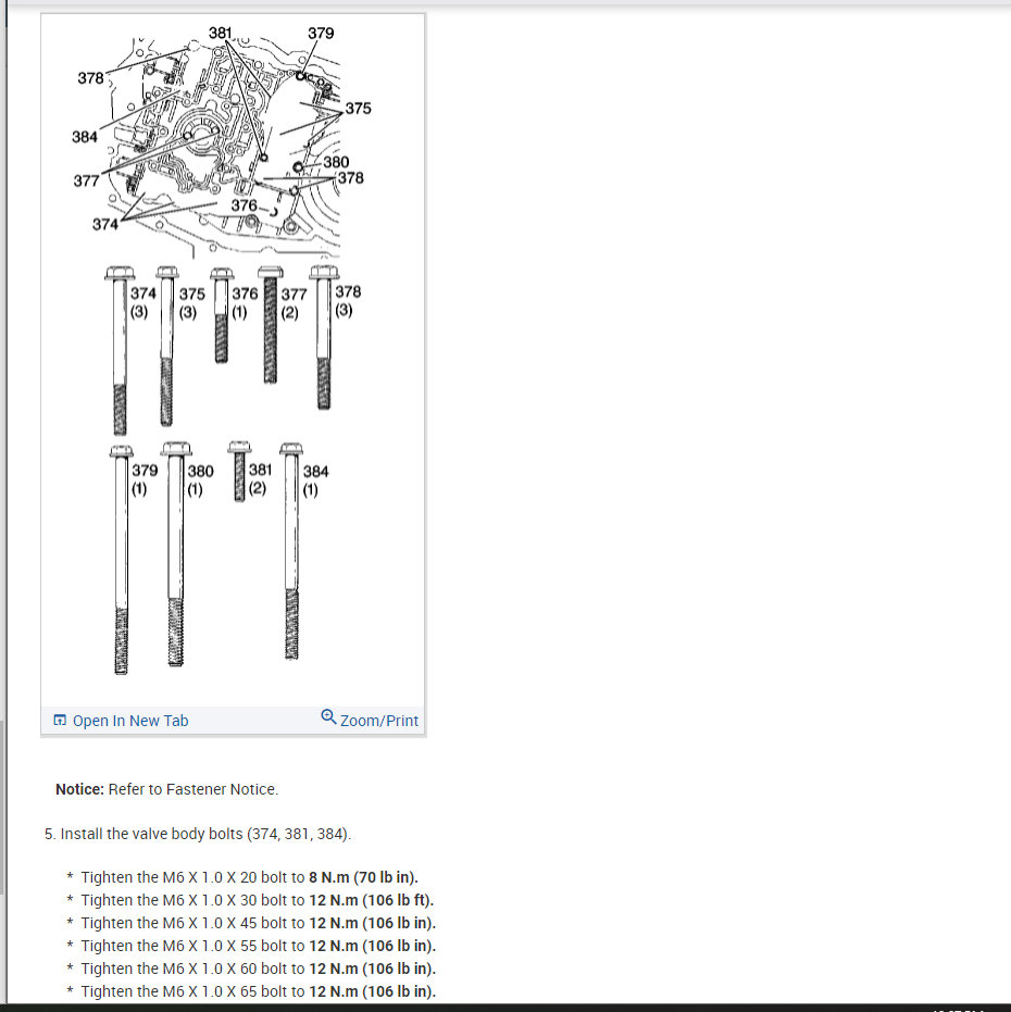

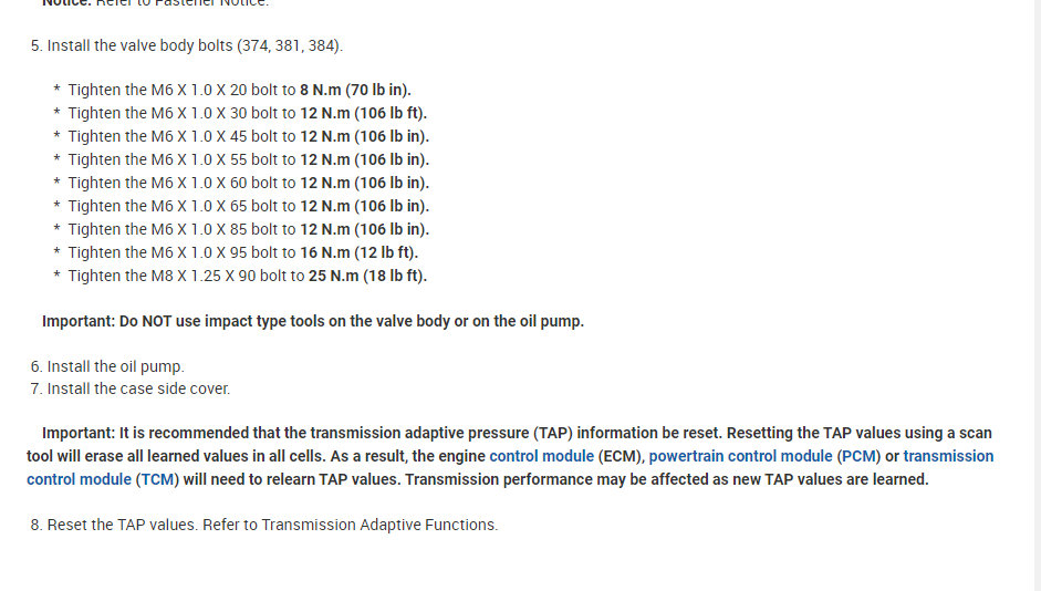

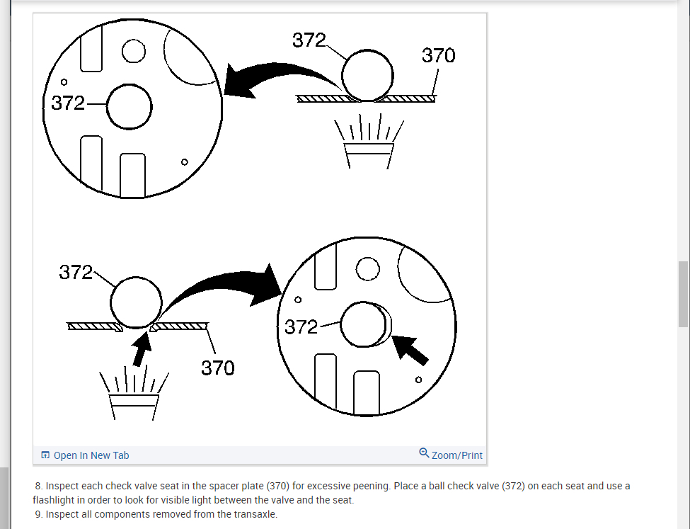

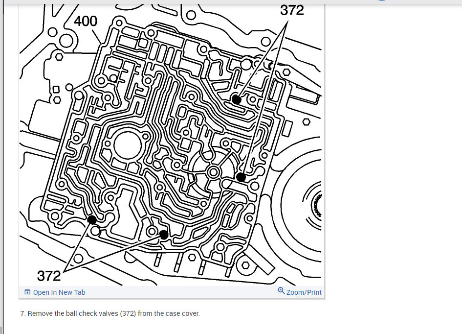

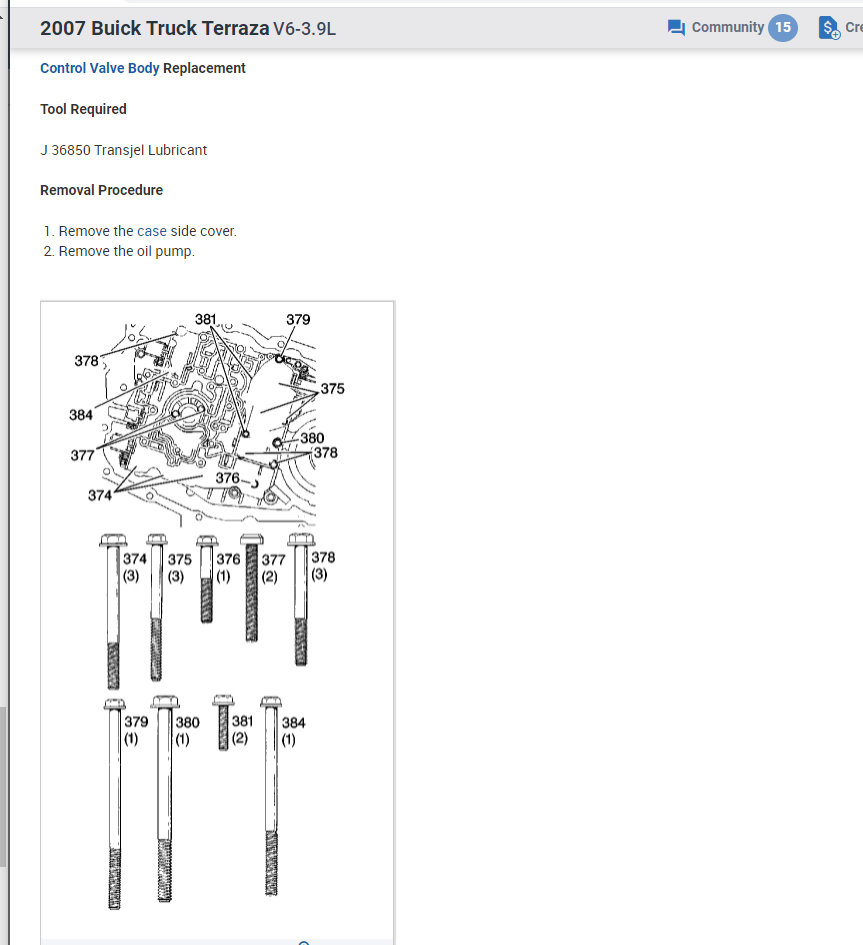

I can try for a video but it is currently in the shop. Are the valve body/solenoid issue something that can be changed without tearing the transmission apart?
Jun 18, 2021 at 8:00 AM

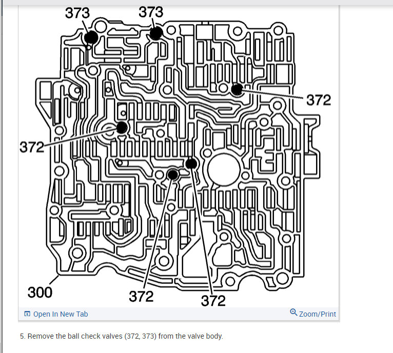

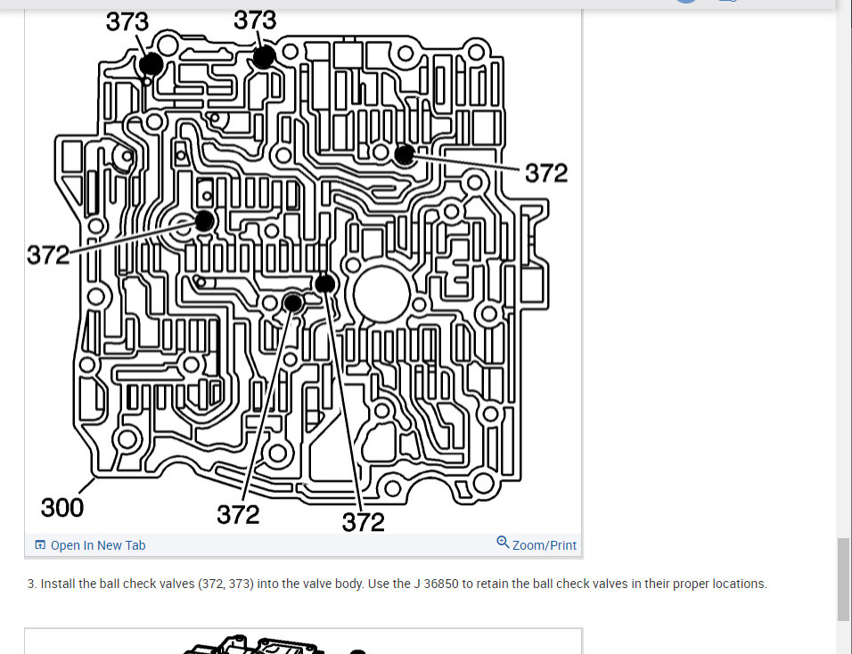

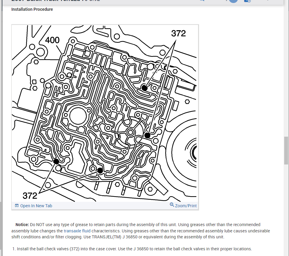

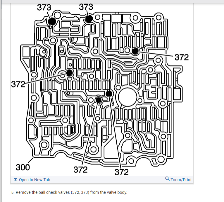

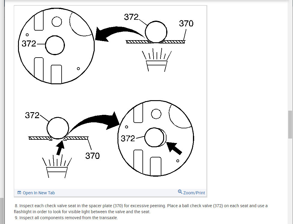

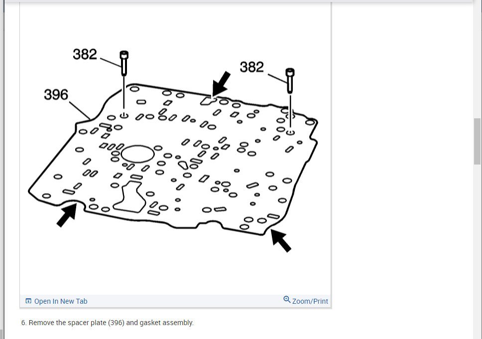

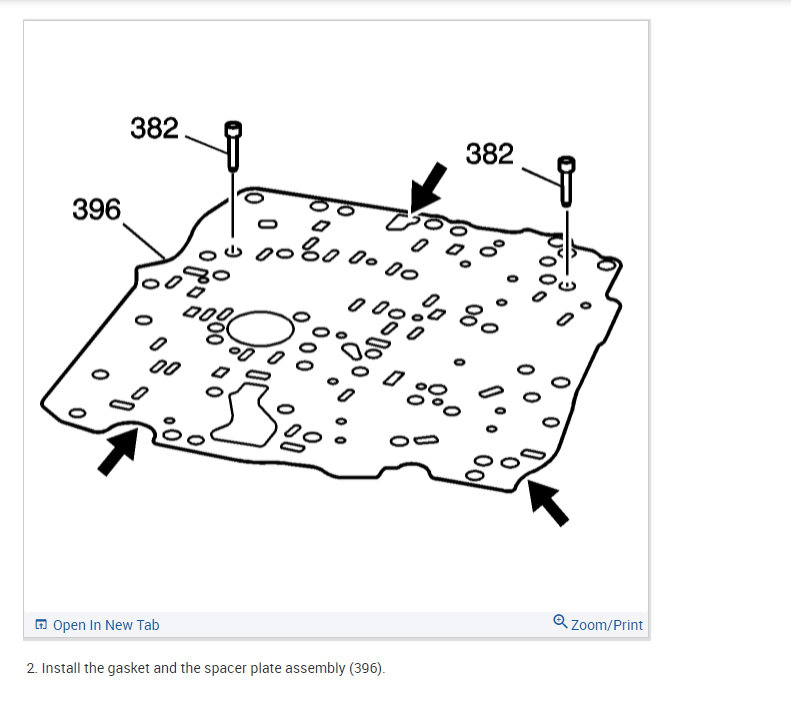

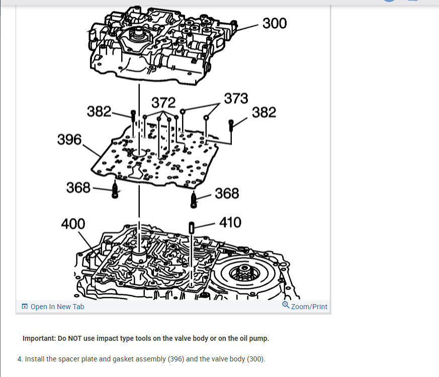

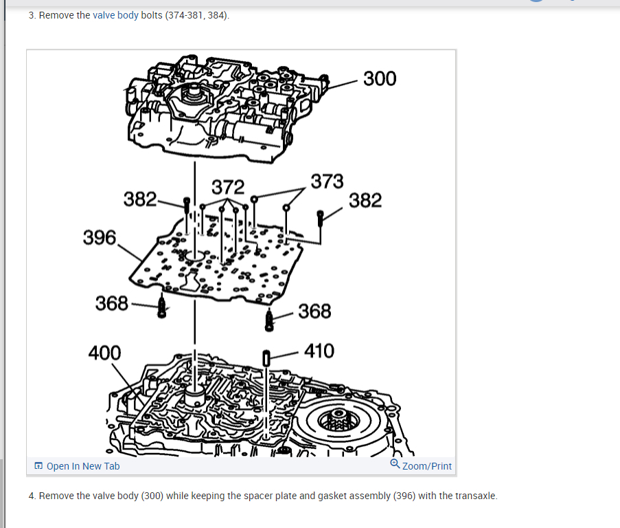

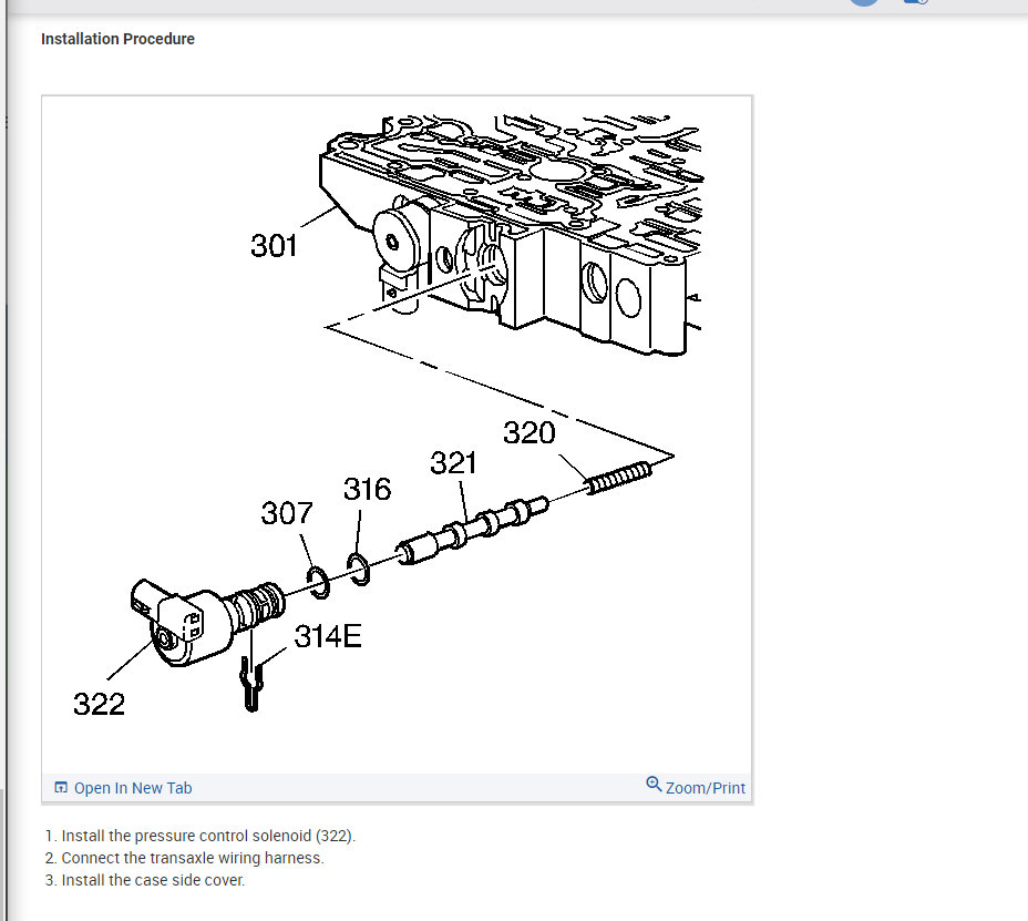

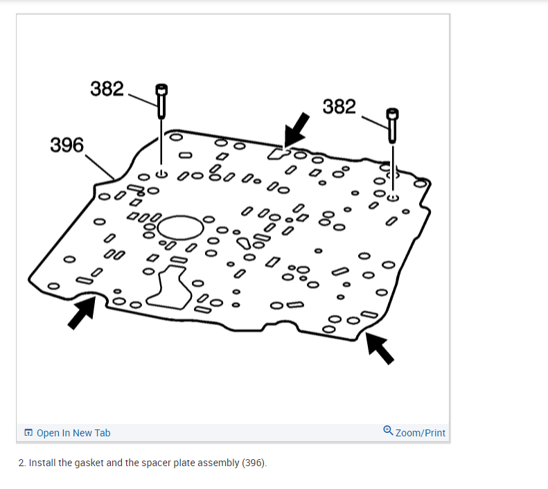

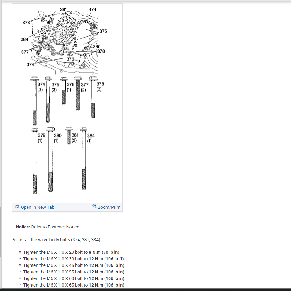

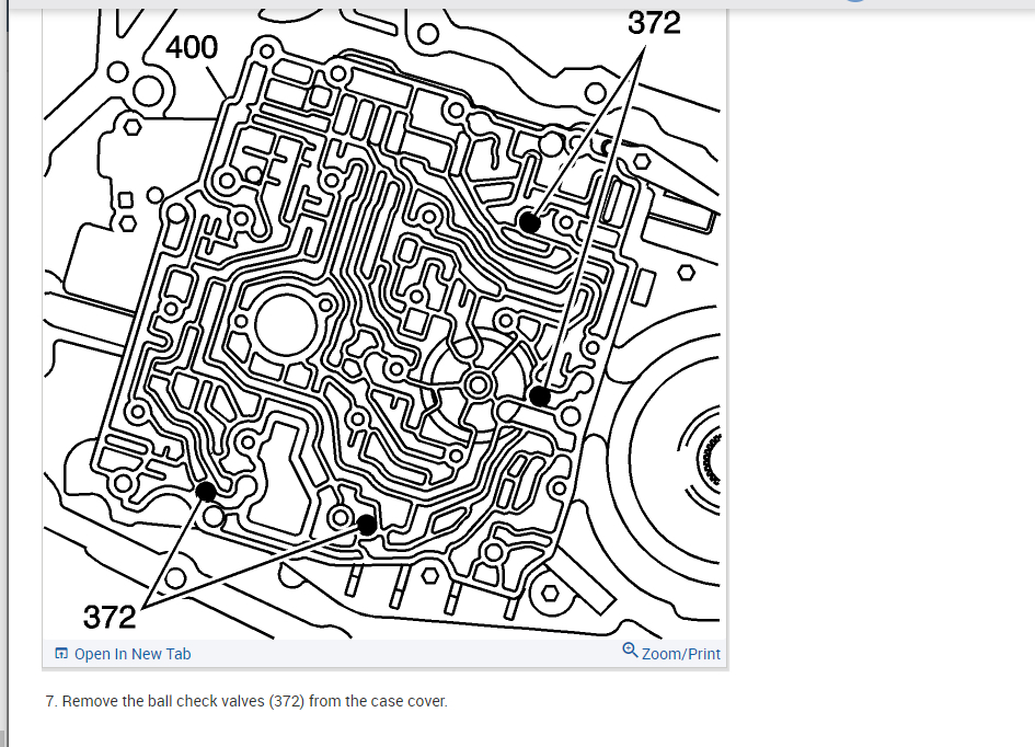

You do have to remove the side pan but you do not have to remove the interior portions of the unit.
I attached the entire process for your review.
Jun 19, 2021 at 7:10 PM

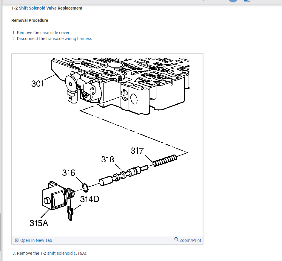

The shop has finally come back with it being a solenoid, and wants $1,400.00 + tax to fix it. My husband is mechanically inclined, but is this a big project to undertake? Or should we just pay to have the "professionals" do it? I tried to do the video, but it just didn't work well.
Jun 23, 2021 at 4:05 PM

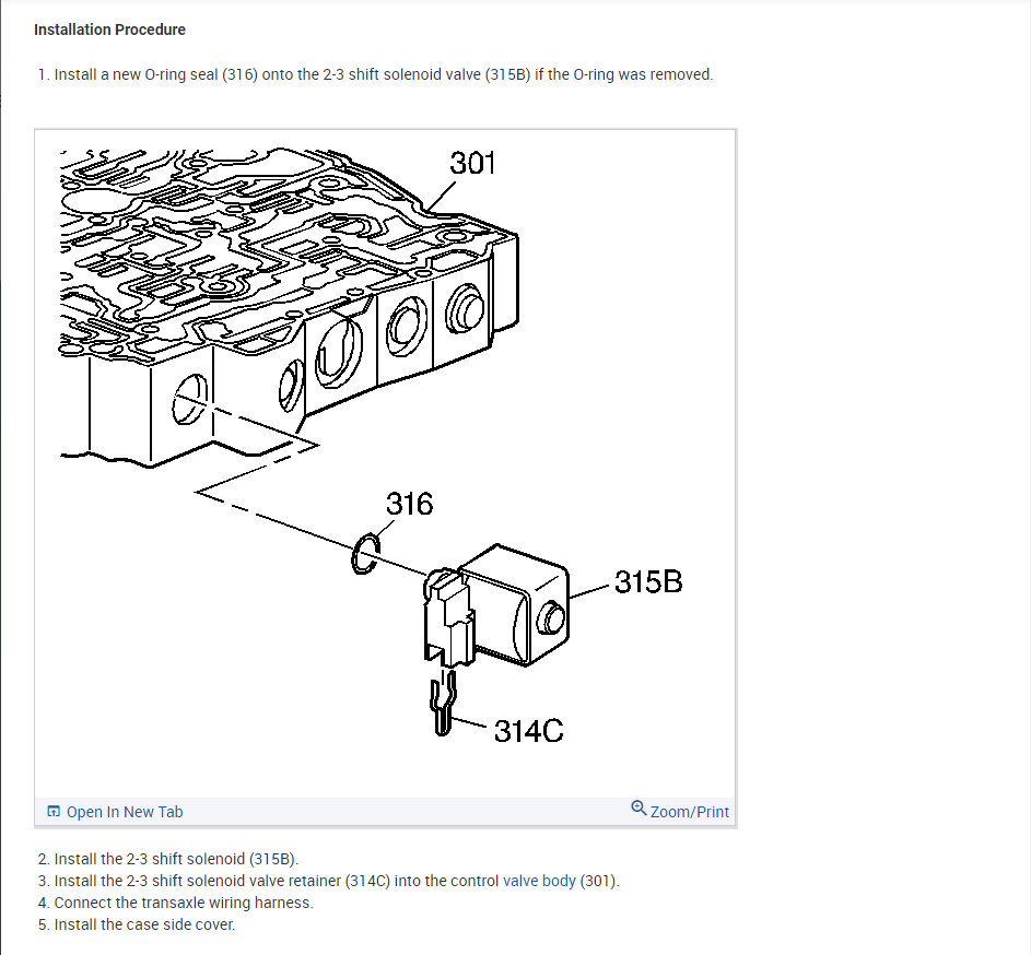

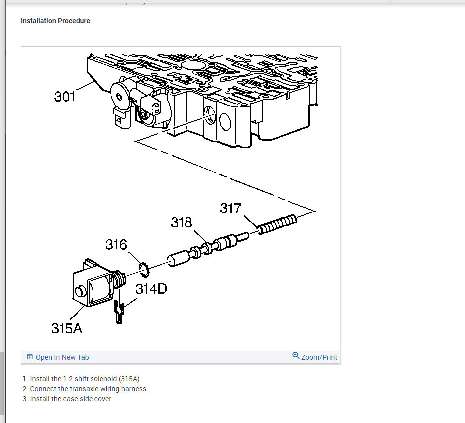

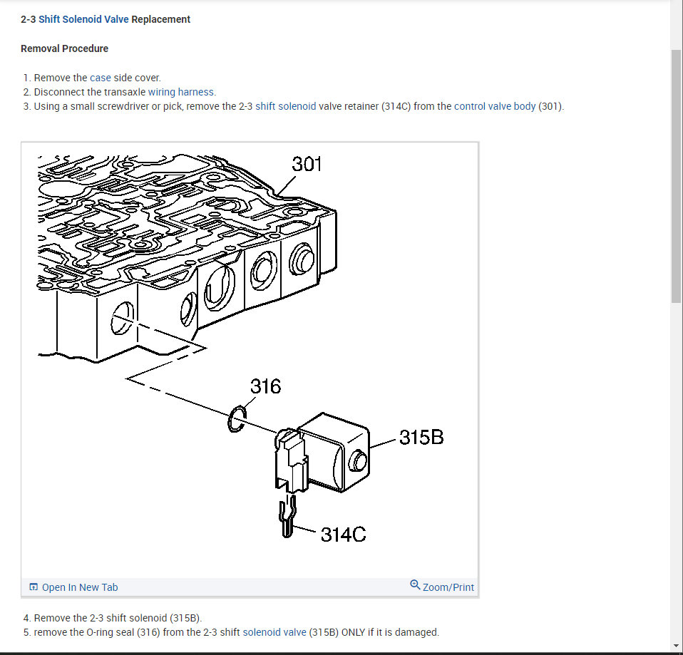

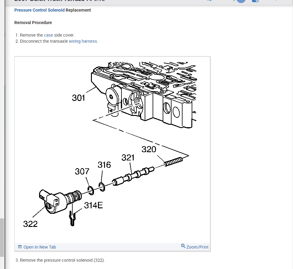

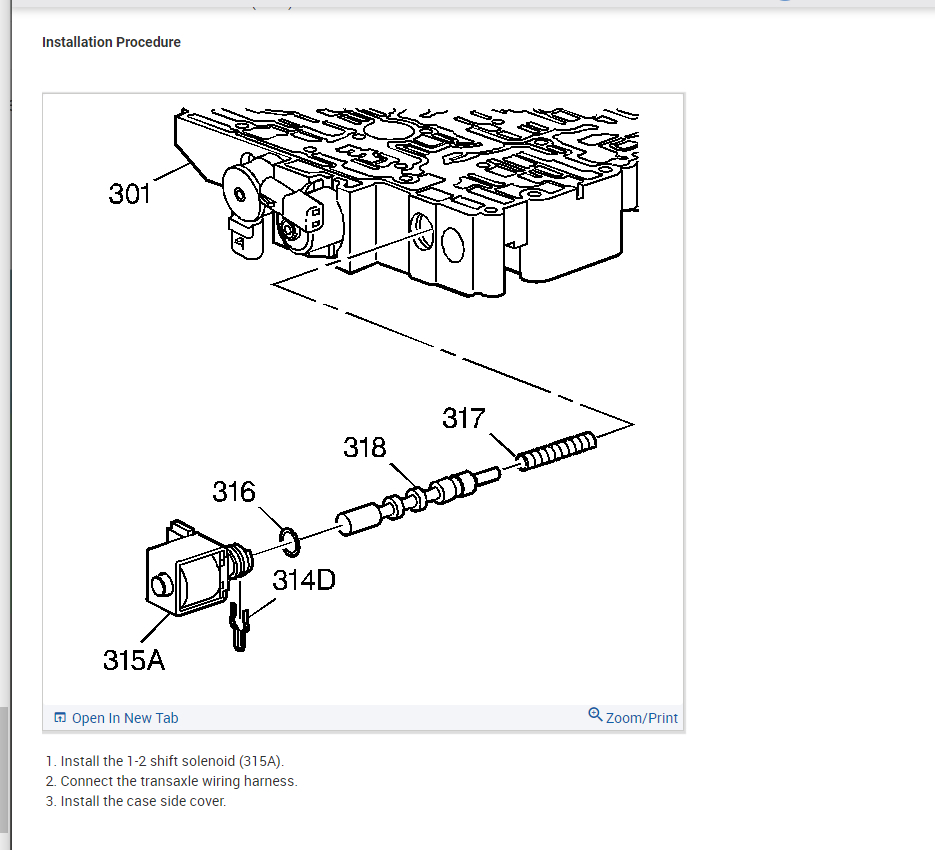

This is a pretty big job. You have to remove the pan, remove the valve body and then remove the faulty solenoid. I attached the valve body process above and will post the solenoid process below depending on which solenoid is the issue.
$1,400.00 does sound high so I suspect they are replacing all of them or the entire valve body. Do you have a copy of the estimate that they provided? Can you get a picture of their right up where they diagnosed it?
Please see the info below and let us know if you have questions. Thanks
