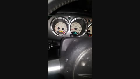

JSTURNER00
  • 10 POSTS
Here is the video of the engine:

No need for a compression test that is not the problem. lets clear the codes then turn the key on without starting the engine to see what comes up. Here is a video:
