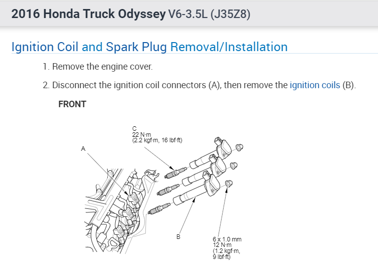

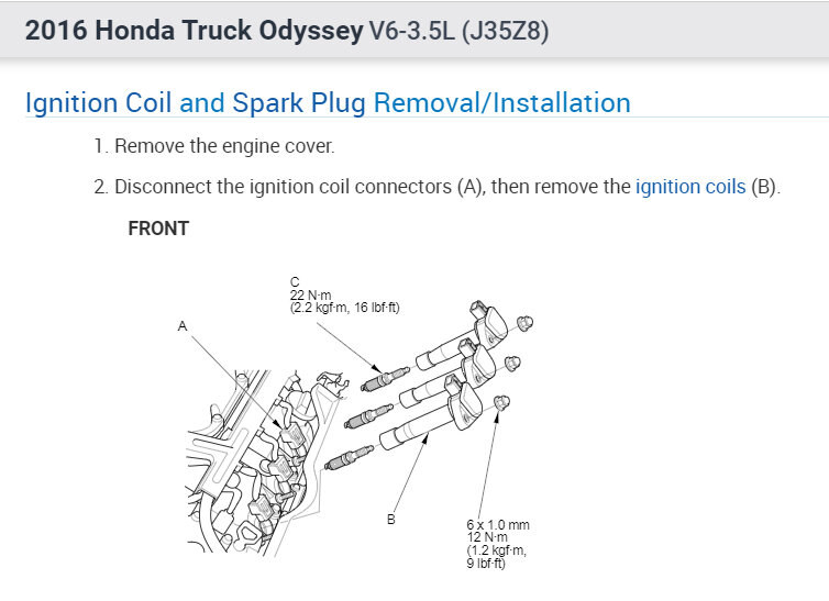

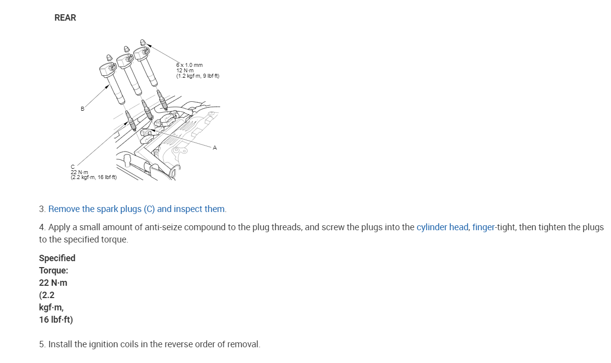

Yep, this happens when the engine misfires, I would replace the spark plugs to start and run the codes because you may have an ignition coil going out. Here are guides to help and the instructions on how to do the job on your car in the images below:
Here is a generic guide to help you step by step with instructions in the diagrams below to show you how on your car:
https://www.2carpros.com/articles/how-to-change-spark-plugs
Spark plug Type NGK DILZKR7A11G
Gap 1.0 - 1.1 mm (0.039 - 0.043 in)
Check out the images (below). Please let us know if you need anything else to get the problem fixed.
