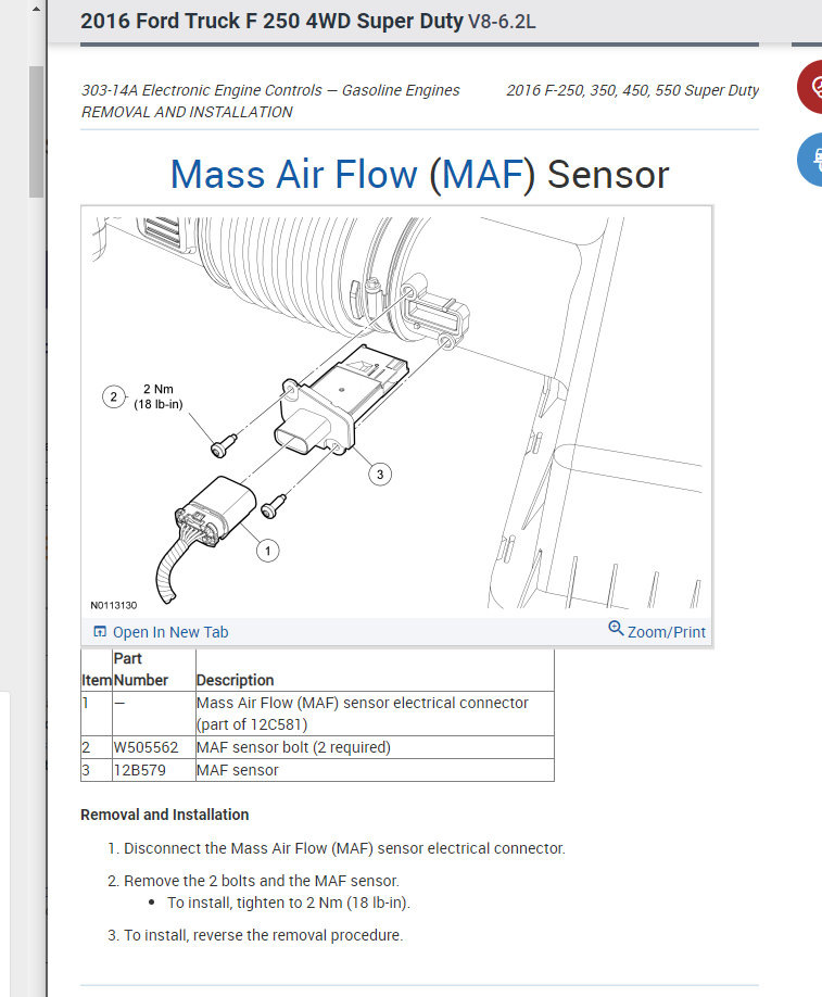

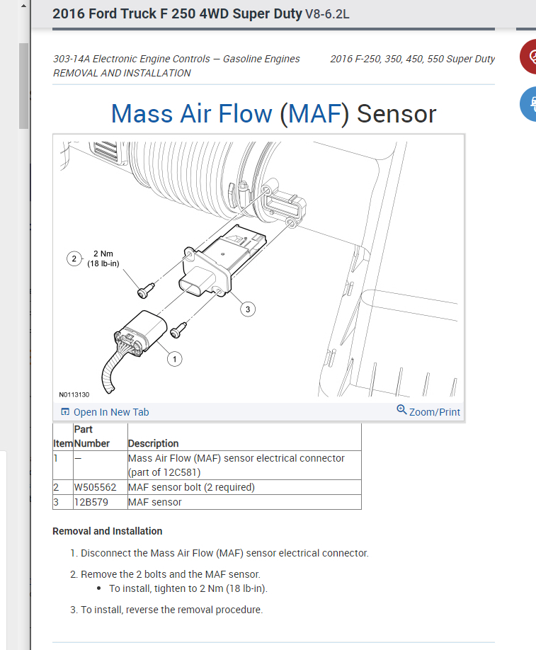

Below is the info from the manual on where this sensor is if you want to do this.
Please let us know what you find with this. Thanks

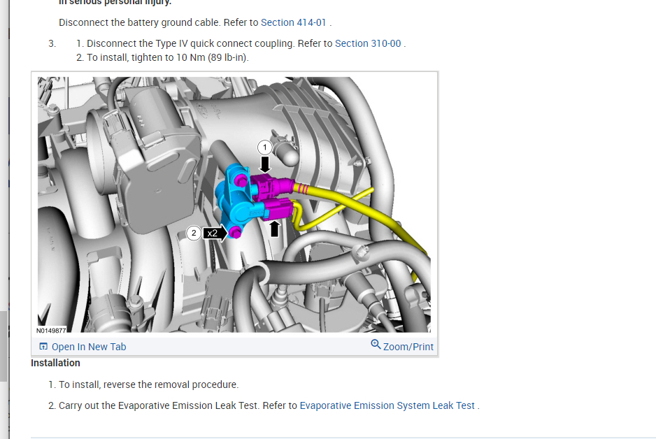

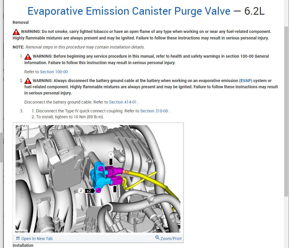

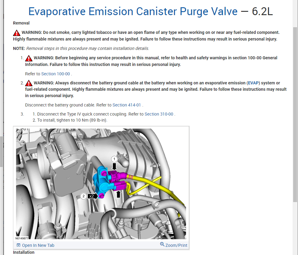

There are not many other things that would cause an intermittent hesitation but I just thought about this earlier today. Two other things to do are the PCV valve and the purge.
However, if you don't mind trying them one at a time that will prove out what it was?
I would suggest starting with changing the purge valve. This make the most sense as when the purge is supposed to be off, but if it is stuck on then it will continue to dump fuel vapor and cause the air fuel ratio to be incorrect.
I have seen this happen on many other engines but not to the point of it causing such a large hesitation as you are describing.
However, if it were me, I would change this out and then see if it happens again.
When you remove it and it looks like there is black/dark chalk on the inside then that is the charcoal in the canister that is breaking down due to fuel being in the canister. If so, you need to change the canister as well.
Please run through this and let us know what you find. Thanks
