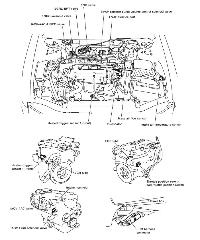

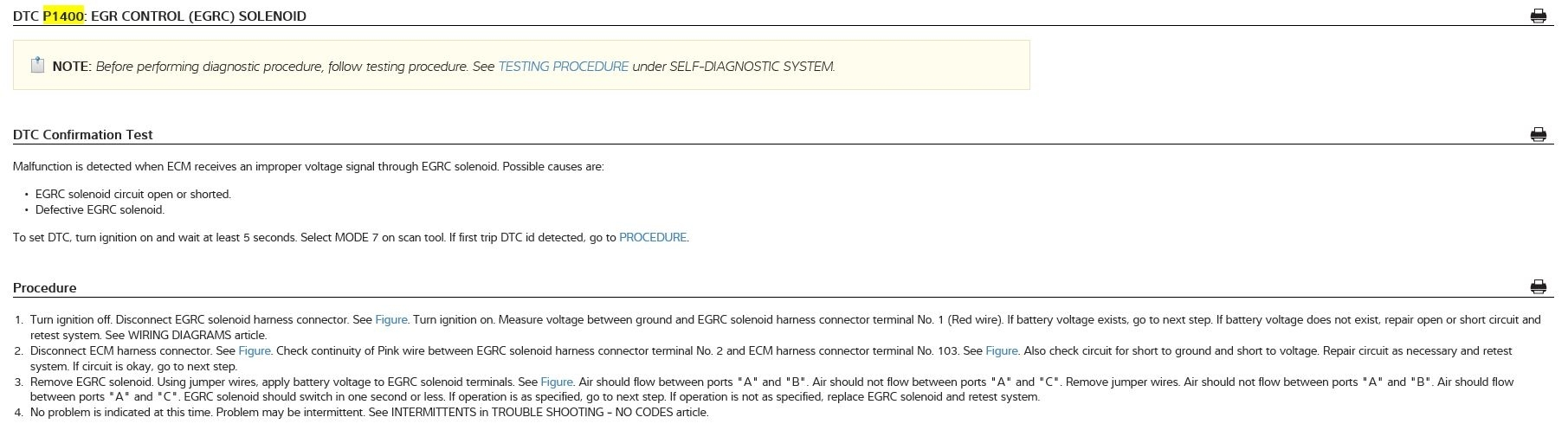

When I pull out from a stop there is no acceleration. I will have the gas pedal almost to floor and it will still barely get above 20 mph, then it will surge forward jerking the car. Then on an incline or hill it will bog down it seems. When I bring the code up it is P1400.
