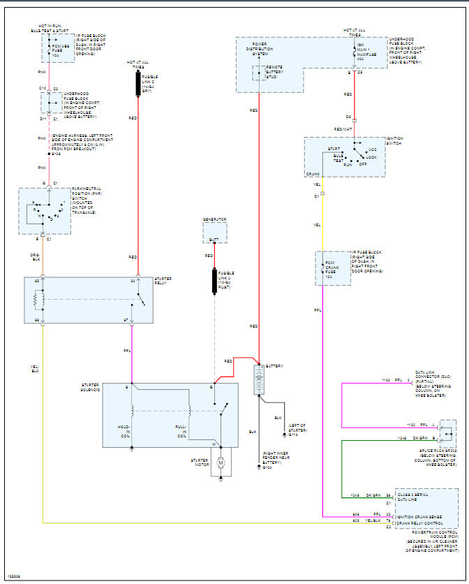

Good evening,
I will attach a wire diagram for you to view.
You need to do some voltage checks to see why it will not start.
The fuse block is under the hood by the battery and you need to check all those fuses.
Jan 25, 2021 at 9:43 AM (Merged)

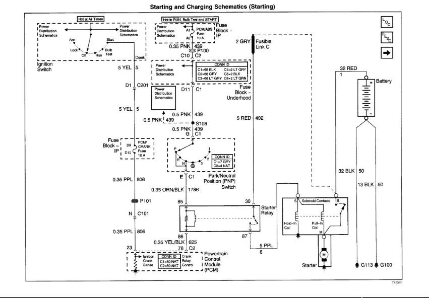

Hi, thanks for the donation. I'd have to make sure the battery has a full charge and the connections are good. Did you try cranking in neutral, when the problem occurs? Is the security lite on, when the problem occurs? The purple wire at the starter solenoid should be hot with the key in the crank position, if it isn't, you need to backtrack the circuit. Some of the national brand autostores will test your starter for free,but, you have to take it off and take it to them.

When/if the starter refuses to crank, with key in the crank position, the purple wire should be hot.
Have the trouble codes checked, both generic and manufacturer specific. We need something to point us in the right direction? It may not be the starter at all, I can't tell yet?

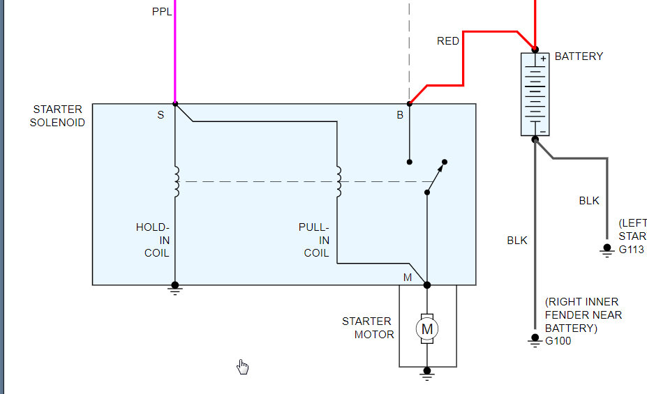

The last thing we need to do is check the voltage at the starter and find out what the voltage is at the starter. I attached below the complete diagram and a close view of the starter. Let us know what you find with this and we can go from there.
Thanks
