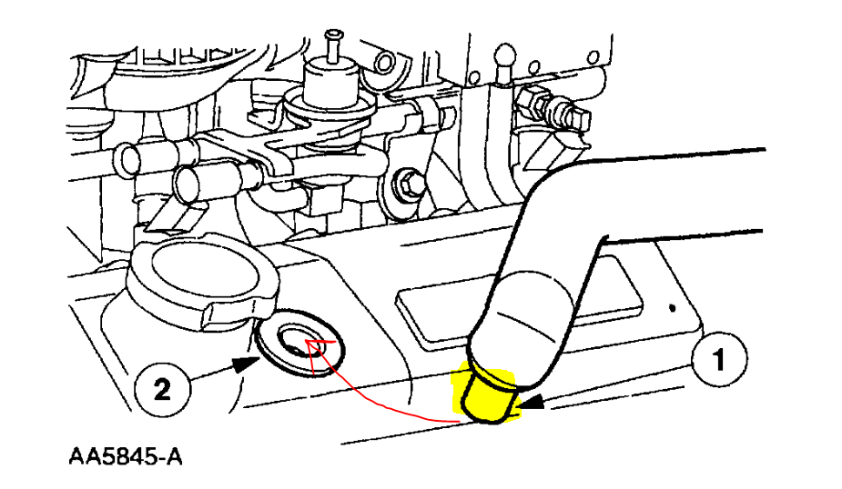

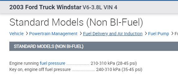

If you look at pic 1 below, it shows the PCV valve. Check the hose and the grommet that the PCV presses into for leaks. That is on the driver's side valve cover. Pic 2 provides the manufacturer's fuel pressure specifications. Make sure to pay attention to how quickly the pressure drops when the key is turned off.
See pics below.

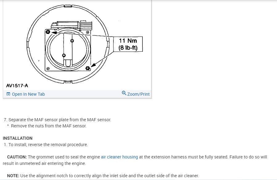

You are very welcome. As far as the spark plugs are concerned, they should be replaced, but they wouldn't cause a lean mixture.
As far as cleaning the MAF, here is a link that explains how to do it:
https://www.2carpros.com/articles/mass-air-flow-service

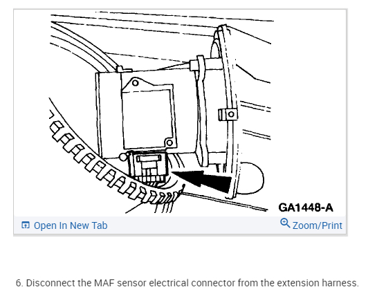

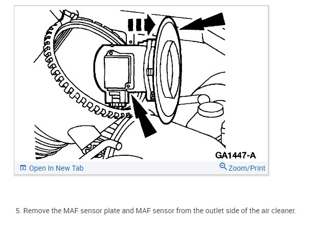

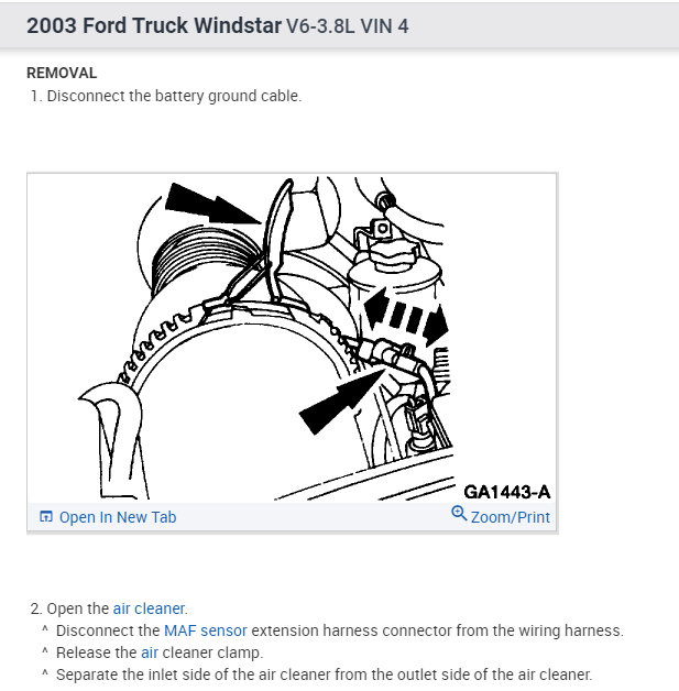

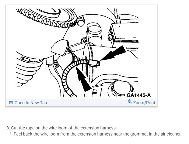

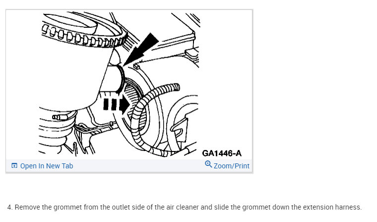

If you look below, I attached the directions for replacing the MAF. I'm not saying to replace it, but the directions will help you with accessing it.
Let me know how things turn out.
See pics below.
