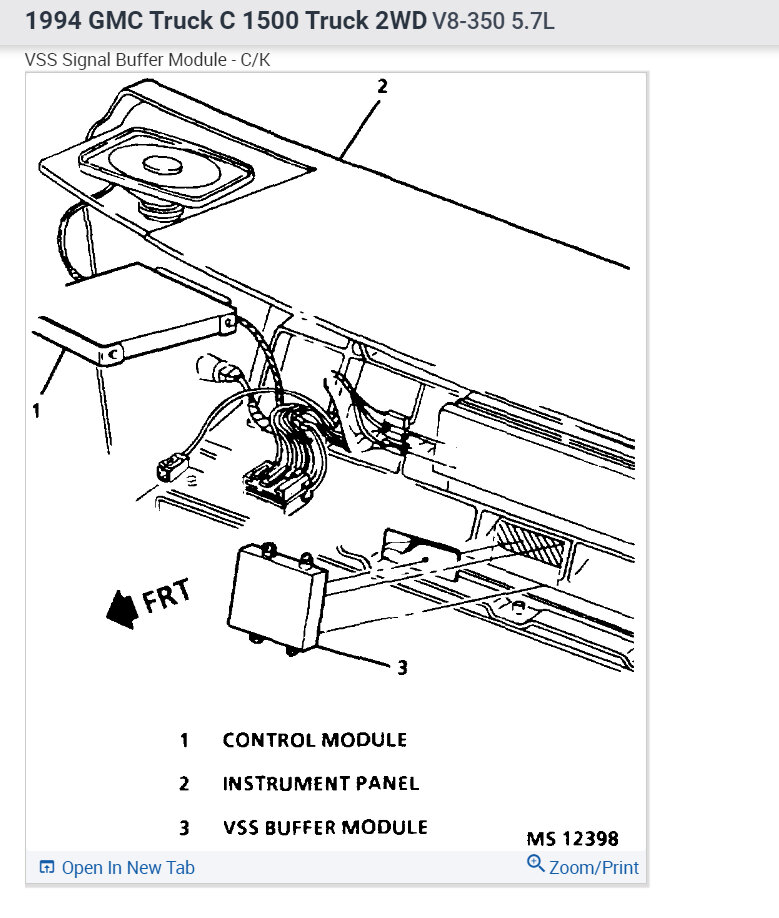

There is a speedometer buffer module just behind the instrument cluster. Here is the location so you can change it out to fix the problem. Check out the images (below). Please let us know what happens.

Yes, I’ve changed that out already with 3 different modules with the same numbers on it QDM followed by some numbers it’s about the size of a deck of cards a white plastic box.
Mar 13, 2023 at 11:52 AM
  • 4 POSTS
It’s behind the glove box on my truck next to the brain box.
Mar 13, 2023 at 11:54 AM
