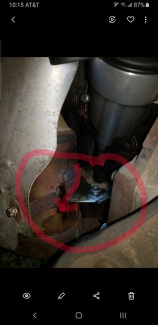

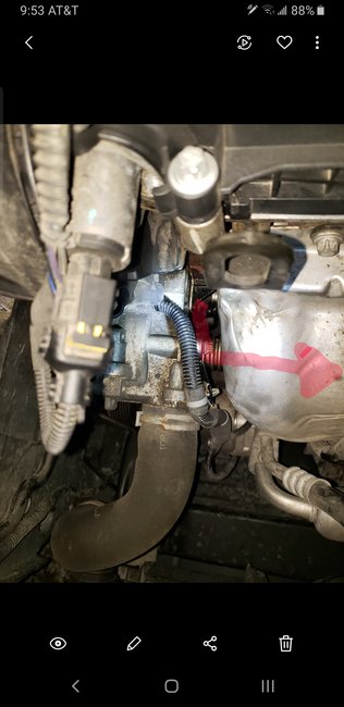

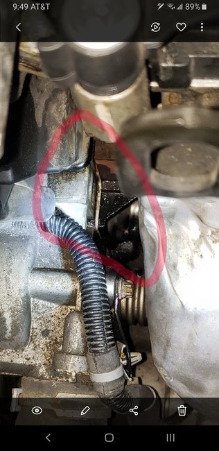

Roy was so awesome I came back for more help on another issue lol. I have a leak that i think is coming from either the oil pump area on the front of the engine or from the back side of the water pump. it seems to be dripping onto the right side of the catalytic converter below the front manifold. Pictures show it better but looks as if it travels across behind manifold and ends up smoking when it hits catalytic converter. I tried to take a better look but didn't want to take off the dipstick to pull heat shield off at 8:00 pm. it is definitely wet in there all the way across front of engine. but i can't see where it is coming from. No noticeable leaks and it is only after driving it 10 minutes or so that it seems to do it. I had it running in drive for 15-20 minutes today looking at it and it never started smoking. Thanks in advance for any help.

Have you noticed if the engine coolant is low? Based on the pictures, it appears to be coming from the water pump. Interestingly, after about 10 minutes, the cooling system pressurizes and that is when it would be most likely to leak. It's hard for me to see in the pictures, but can you tell if it is motor oil or could it be coolant?
Do me a favor. Here is a link that explains how to pressure test the cooling system. You will need a pressure tester but most parts stores will lend/rent one to you. This test is done on a cold engine. If the leak is the water pump or a hose, you should be able to locate it.
https://www.2carpros.com/articles/radiator-pressure-test
Try that and let me know. If you are confident it is not coolant, let me know.

Could be coolant i couldn't tell for sure with both fluids pretty new. Coolant was low a few days ago but i figured i didn't get it all the way full or had air. With all i have done to it the last month it is mostly new, lol. I thought it might be the pump as well but it seems dry on pulley side and at the seal. Will it leak out of back side of housing? Really wet in and around those three areas on back of housing. Both my fluids are about same color amber so hard to tell. Thanks.

It could be. The gasket on the water pump may have failed or there could even be a hose leaking (heater hose). I attached an exploded view of the water pump so you could see the gasket and how everything is positioned.
Also, there is a weep hole on the water pump. It can leak from there if the seal or bearing is going bad in the pump. It's a small (approximately 1/4") opening near where the shaft enters the pump housing. Actually, it is on the housing itself.
Honestly, I would pressure test it. I feel it would help locate the issue.

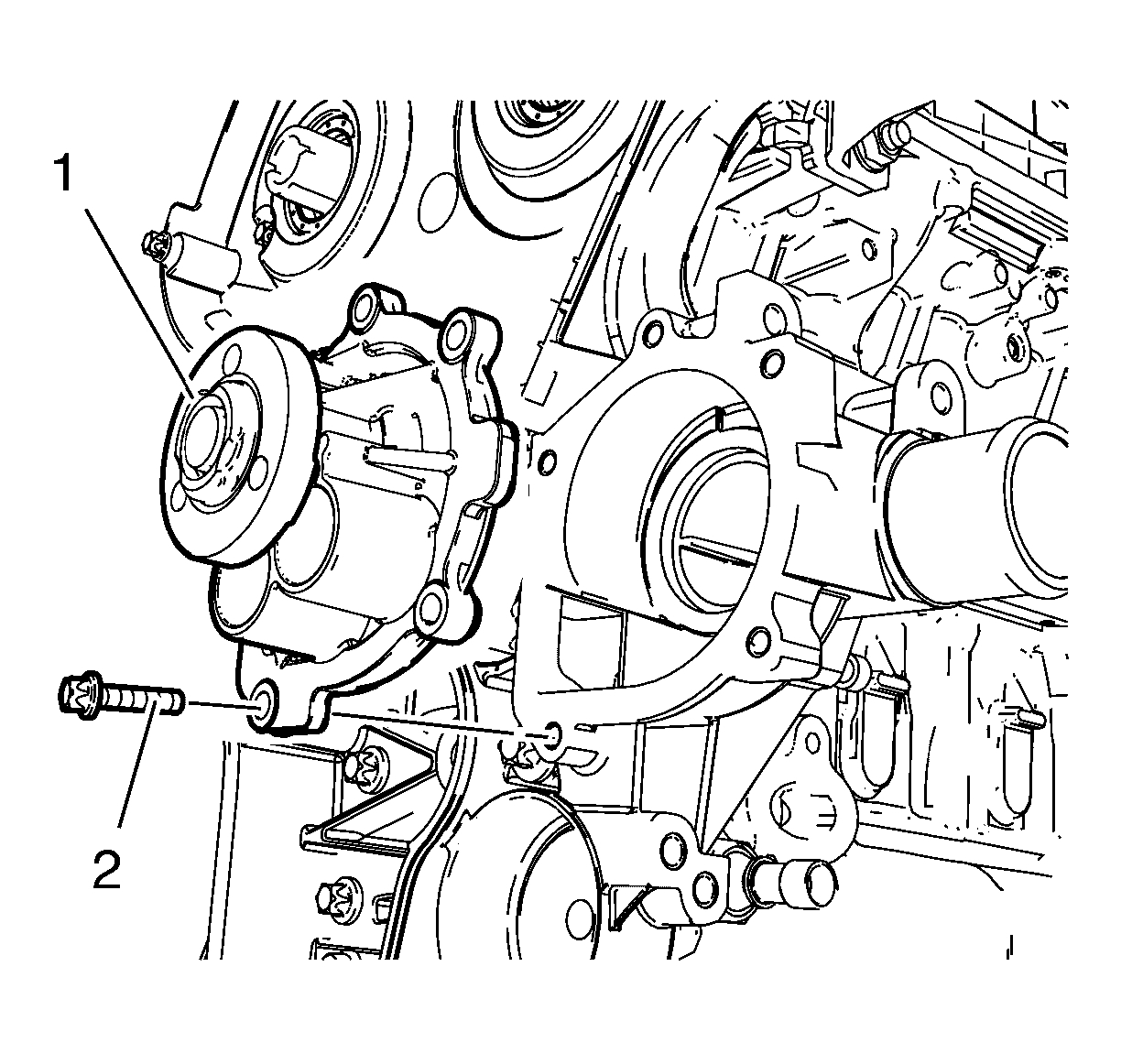

I don't know if you want them, but here are the directions for replacing the pump on your vehicle. The two attached pictures correlate with the directions.

3. Remove the 5 water pump bolts (2).
4. Remove the water pump (1).
5. Remove and DISCARD the water pump seal ring.

4. Install the water pump (1).
Caution:
Refer to Fastener Caution See: Vehicle > Technician Safety Information > Fastener Caution.
5. Install the 5 water pump bolts (2) and tighten to 8 Nm (71 lb in).

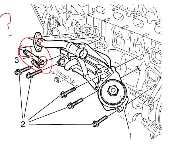

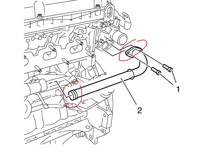

I attached a picture of the cooler assembly. I circled one pipe that I believe you are referring to. If I ac correct, there is an o-ring at both ends. The second pic shows the outlet pipe and again, there is one at both ends.

The one on the right is the pipe. Both ends have have an o-ring but it seems it supposed to have an inner seal on that pipe. I can order it i just don't know where it goes exactly. Inside the cooler, then insert pipe with the o-ring?

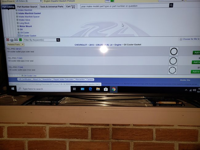

Fel pro 36121 and 71346. one says inner other says outer.

If I recall, there is one on each side. When you remove it, was there two on one side? That doesn't sound right to me. Also, make sure the o-ring didn't come off and is lodged where it mounts or has fallen.
