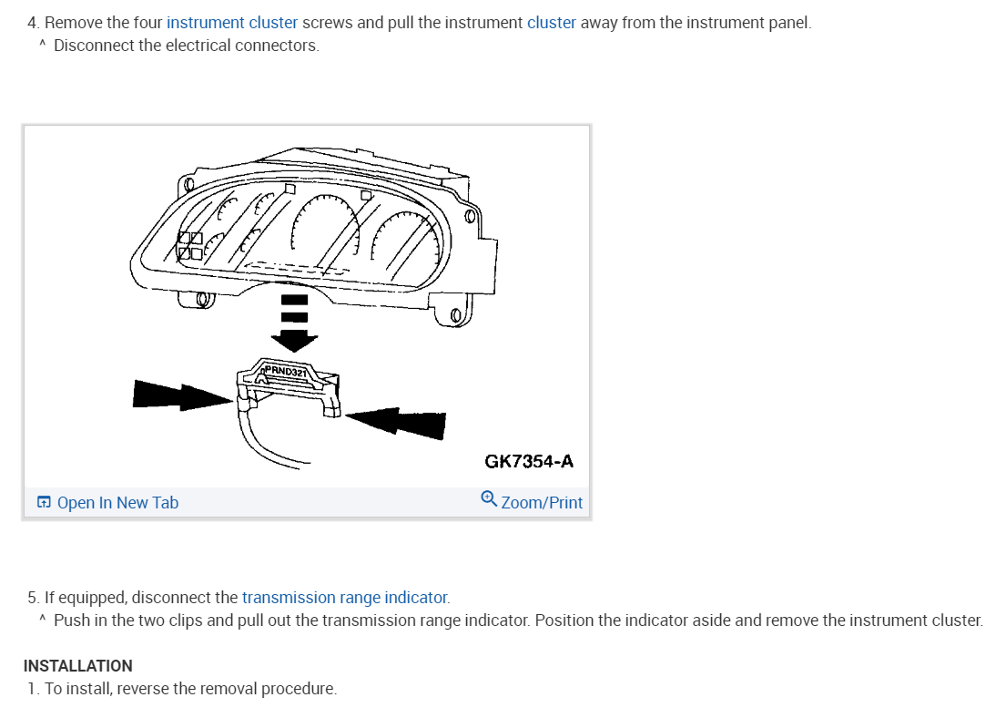

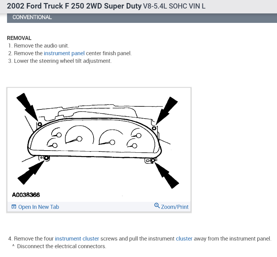

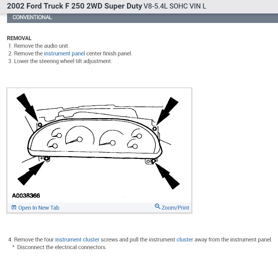

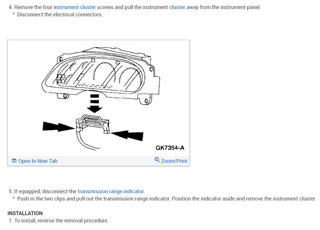

This is common when the cluster goes out. here is a video of the job being done on a similar car with instructions on how to change your out in the diagrams below:
https://youtu.be/_HEC44xENxw
