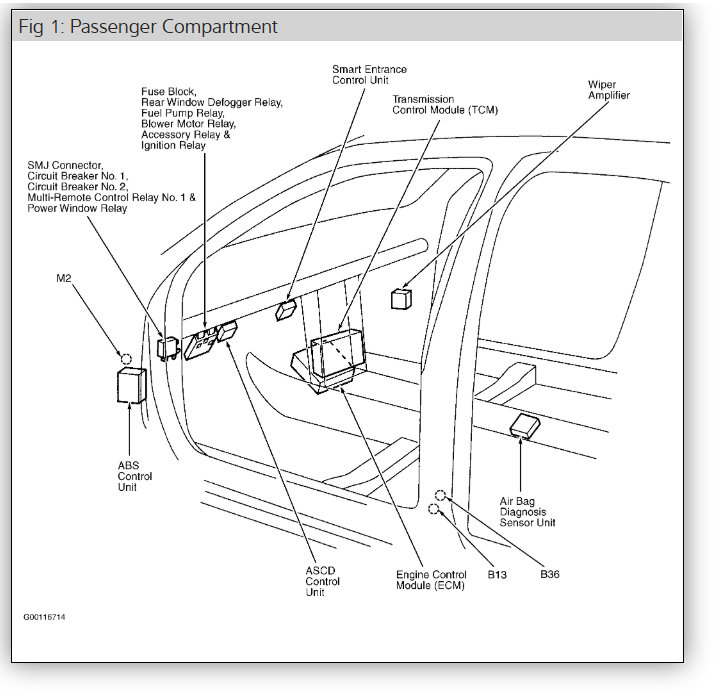

My car has no power to the horn, wiper's, windows, dome light, A/C and wont start. but has a good charged battery.
Sep 24, 2019 at 8:59 AM
There is an accessory relay that needs to be checked. here is a guide and the location of the relay:
Check out the diagrams (below). Please run this test and get back to us.

Where is it on the diagram? it does not say.
Sep 25, 2019 at 1:35 PM
Oops, wrong diagrams I updated it. please recheck and get back to me.

Can you please check the accessory relay? Here is a guide:
Please run down this guide and report back. This relay controls the accessories in question.
