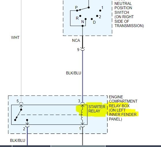

If you tried jumping across the solenoid and nothing happened, either the starter is bad or there is no power direct from the battery.

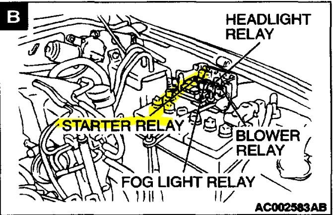

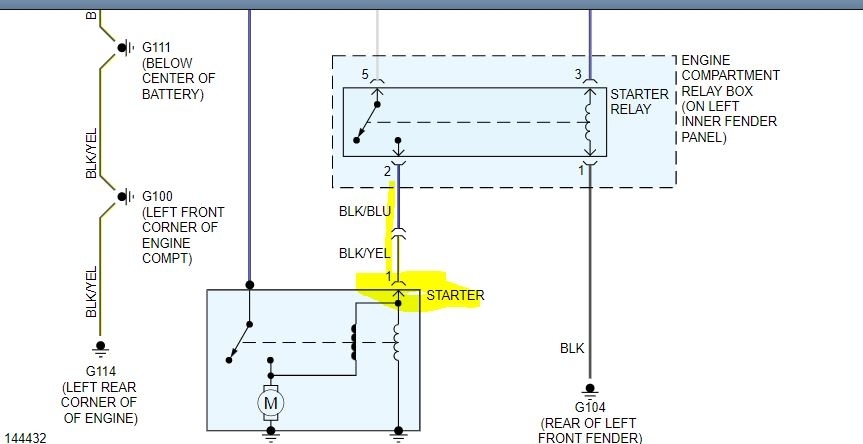

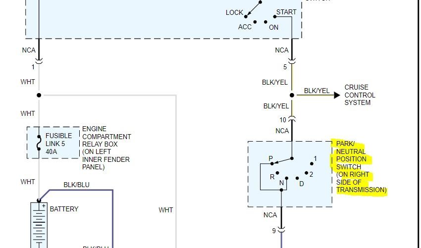

If you take a look at the pics I attached, I started with a picture of the starter relay. Then I cut parts of the schematic which shows for power to reach the smaller wire on the solenoid (the S terminal) it has to go through the park / neutral switch, then the starter relay, and then it makes its way to the starter. The only time that smaller wire should have power is when the key is in the start position. If there is no power to it, the starter won't engage.
The larger wire on the starter comes directly from the battery and should have battery voltage (12v) all the time. So if you tried to jump power from the larger wire to the smaller wire and nothing happened, first make sure there is 12v on the larger wire. If there is, replace the starter.

Again, if there is 12v to the larger wire on the starter and you crossed it to the smaller wire and nothing happened, either there is no connection between the positive battery terminal and the starter or an open circuit within the starter.
