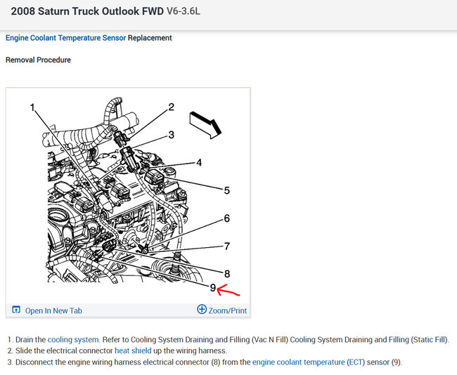

I need to locate the ect sensor on my engine. Please can you tell me where this is?
Dec 29, 2024 at 11:26 AM

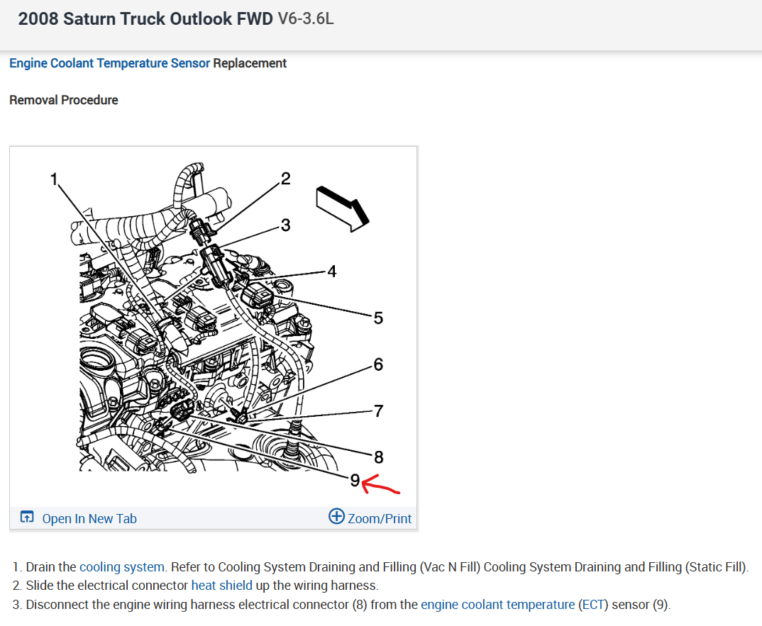

Sure the engine coolant temperature sensor is on the cylinder head on the left side of the engine. Check out the images (below). Let us know if you need anything else.
