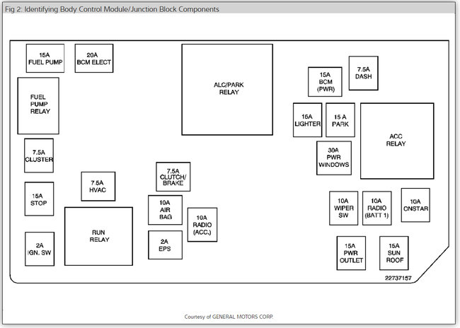

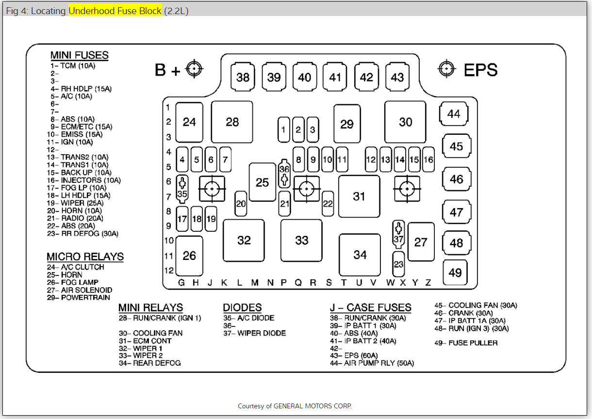

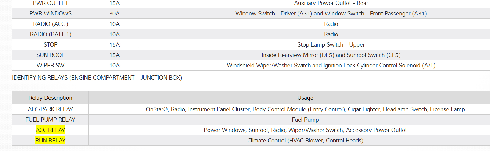

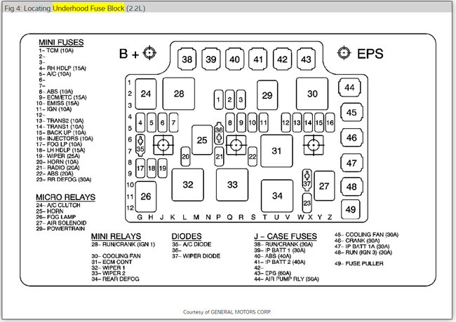

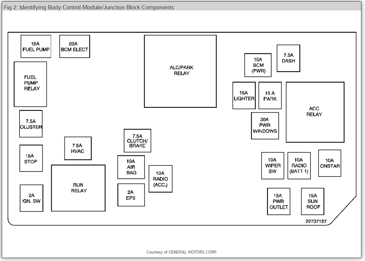

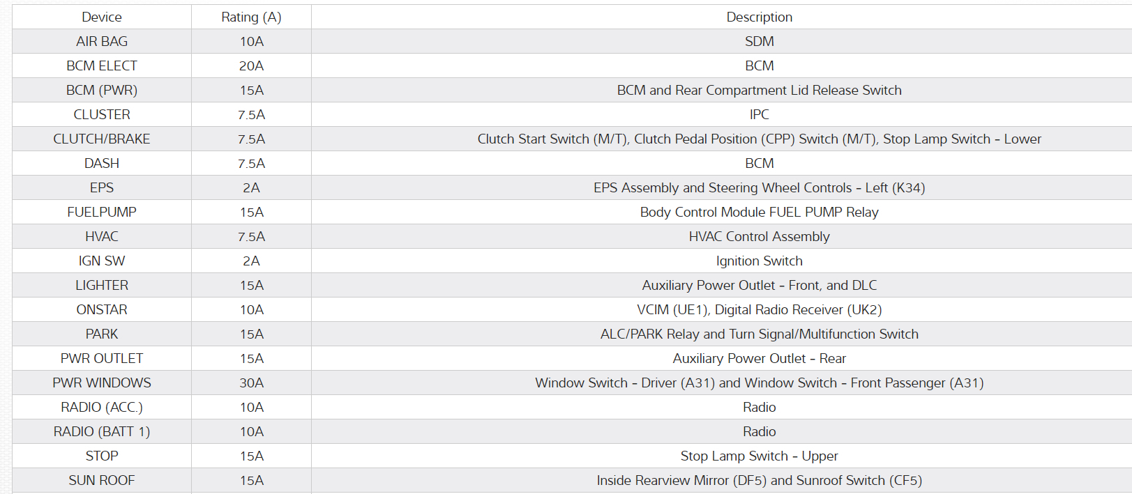

There is an ALC/park relay that needs to be checked also check for power at the park fuse. Here is the wiring diagrams for the running lights so you can see how they work and a guide to help you test the fuse and relay and the relay and fuse locations below:
and
Oct 13, 2018 at 1:32 PM
