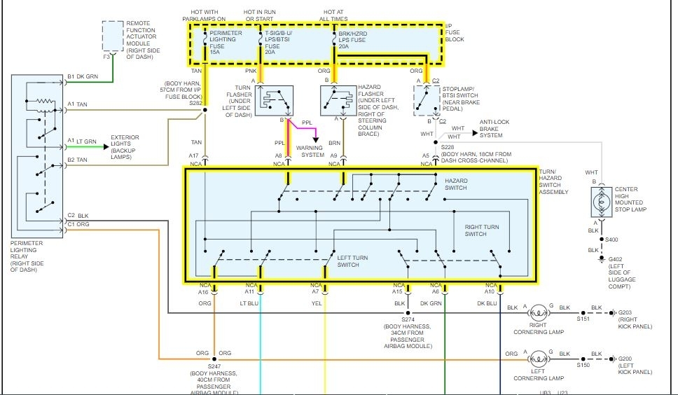

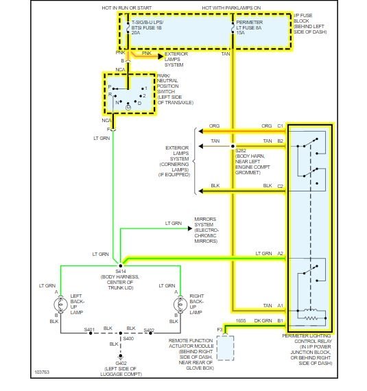

I attached a wire diagram for you to view. Please tell me the exact fuse that fails when you put it in reverse.

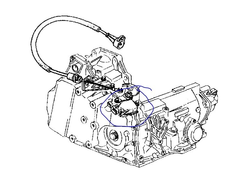

I also attached the location of the reverse switch location.
