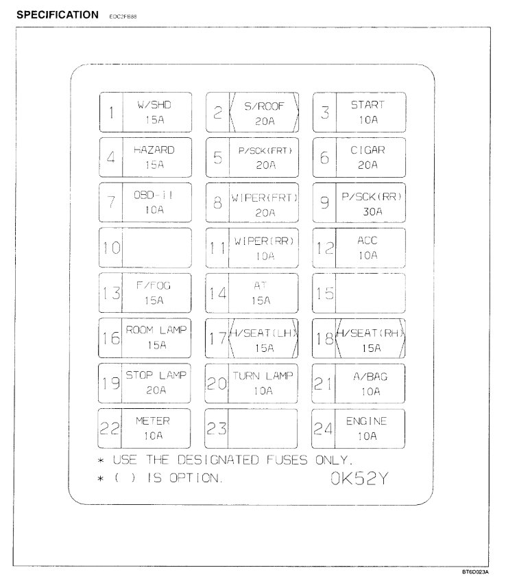

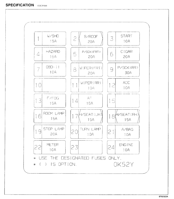

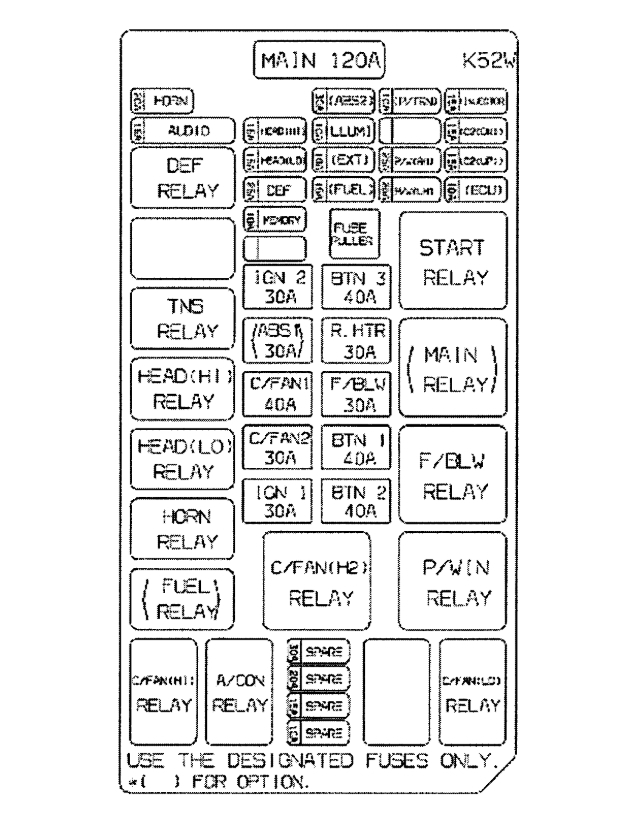

Is there a fuse able link, van decided to stop running, crankshaft position sensor was changed also fuel pump, and new battery, and ignition failure sensor was replaced and still nothing, what can it be all fuses and everything has been checked over an over wires, turns over gets no fire
Jul 9, 2022 at 5:49 AM

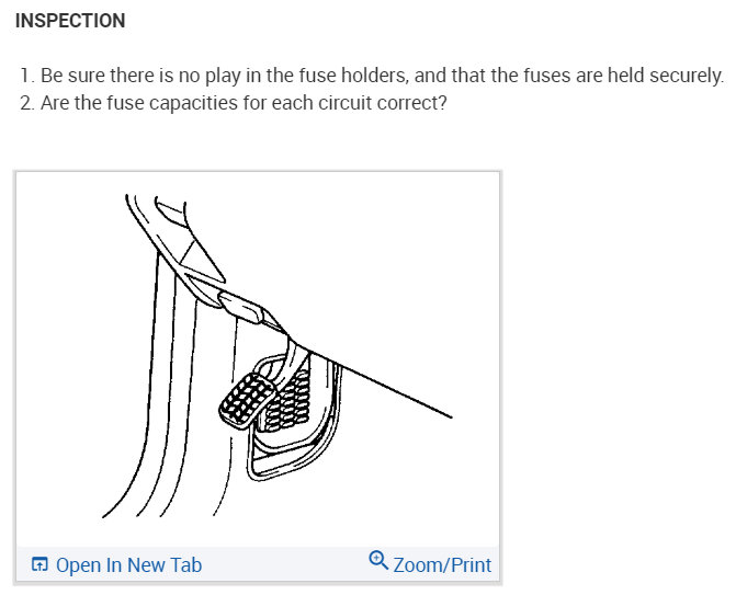

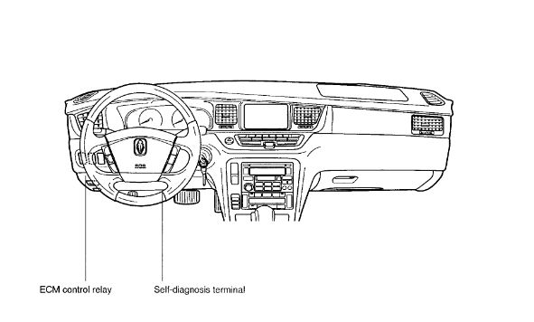

There is a main relay that goes out in these cars which powers the engine electronics but to be sure here is a guide to help you test the relay with the relay location in the diagrams below. Also, we should run the codes to see what comes up.
