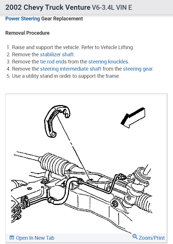

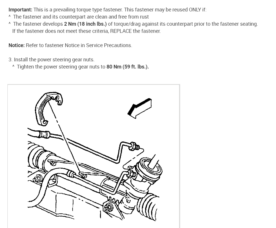

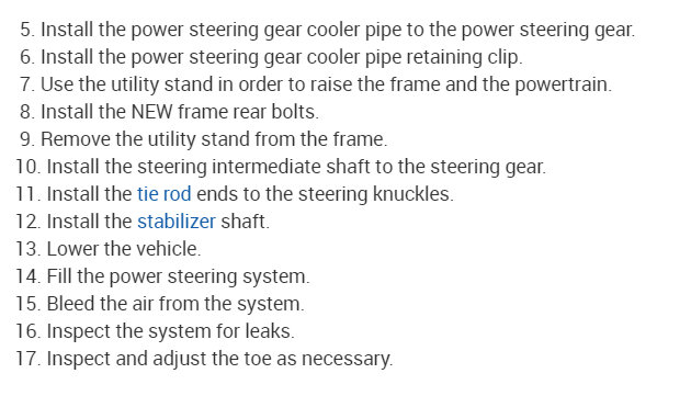

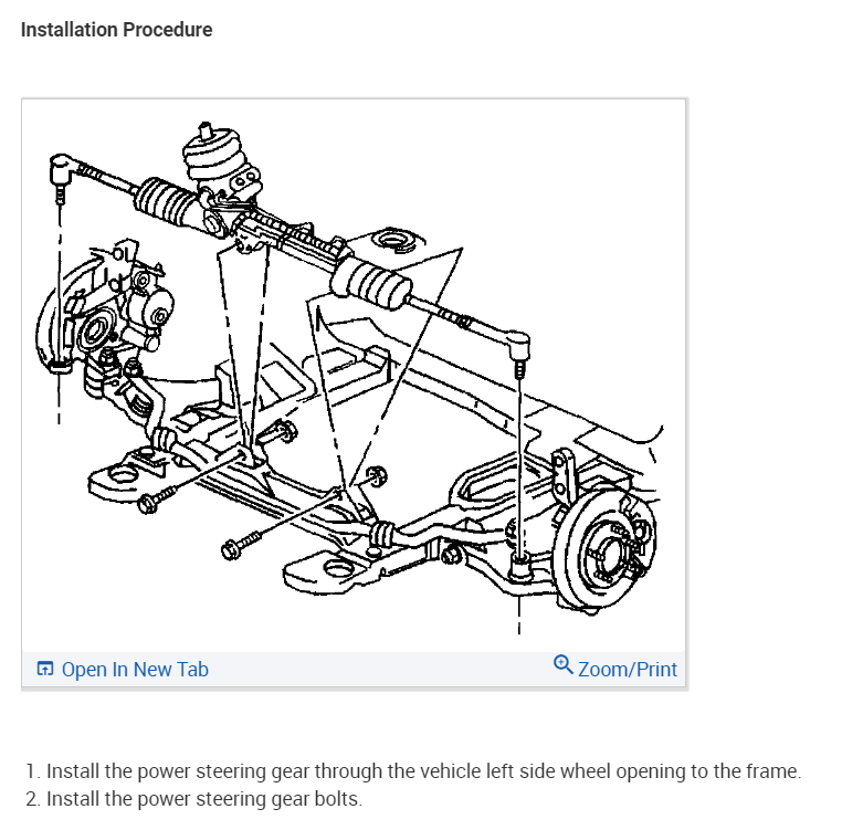

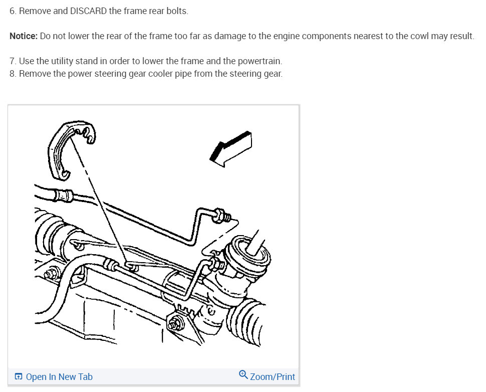

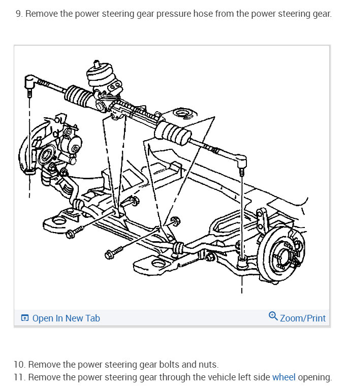

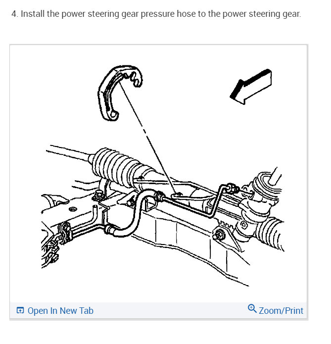

Thanks for the video. Yep, this happens when the power steering rack goes out. Here is how to fix it in the images below. Check out the images (below). Please let us know if you need anything else to get the problem fixed.
