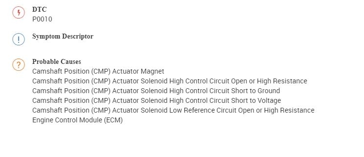

There is no code listed on the work order. It just says camshaft position senor. I need the code.If there is another code, please list it.
The code is for the cam sensor but is most likely electrical. Since they changed the oil and it just happened, I would have the connector checked to see if it is a clean solid connection. It may just be the connection.
I posted possibilities below for you to review.
