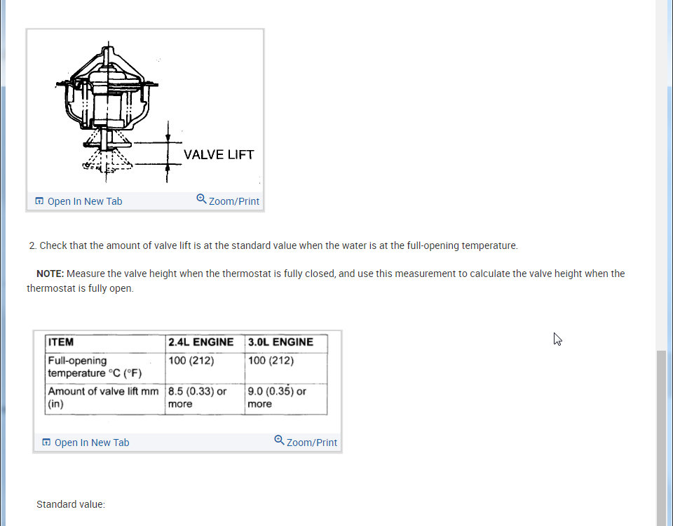

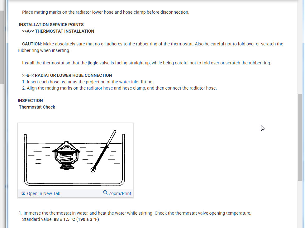

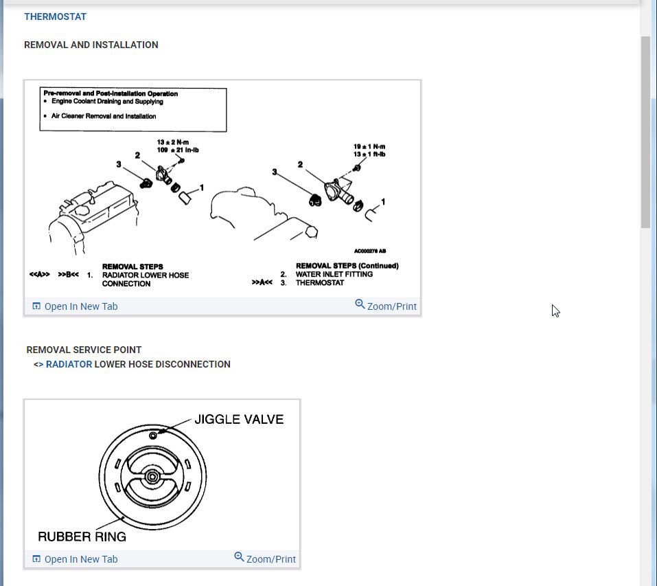

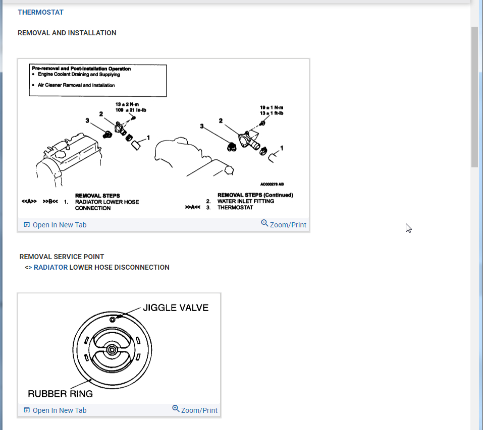

Please see below for the process out of the manual as well.
So let's run through this material and go from there. Let us know what you find. Thanks
