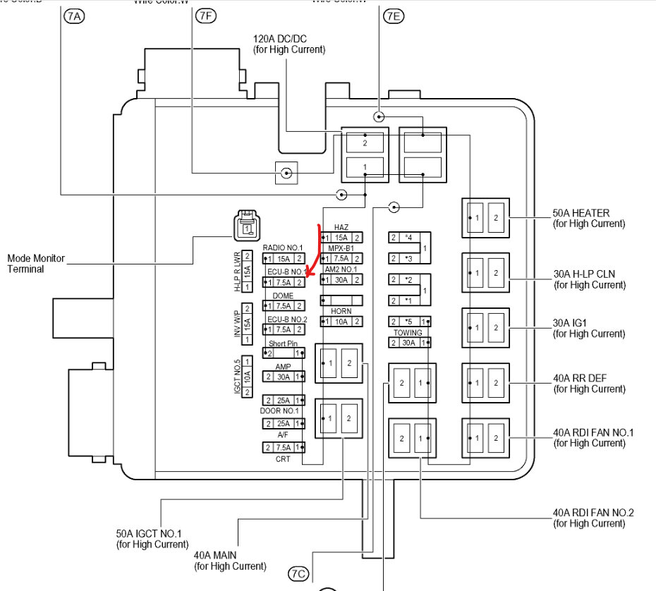

The only circuit that I can see that is shared is the ECU-b1 fuse which we need to see if the fuse is good and that it has power.
Here is a guide to help:
Here is the location of the fuse under the hood fuse panel. Check out the images (below). Please let us know what happens.

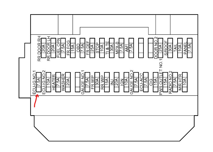

Okay, let's do the same check for the ECU-IG-1 fuse in the fuse panel by left side of the dash. Again, test with the ignition power on. Here is he fuse location. Check out the images (below). Please let us know what happens.

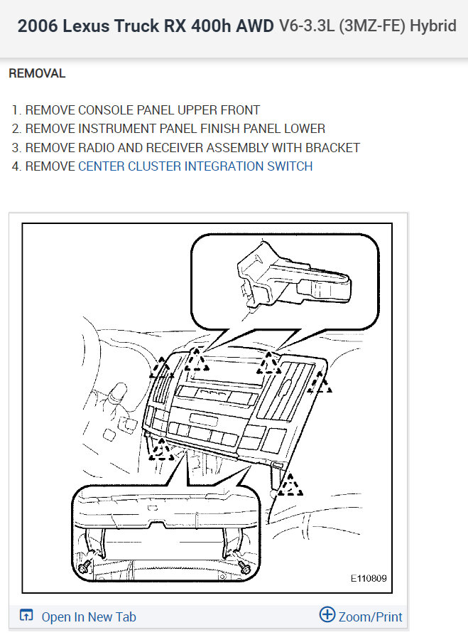

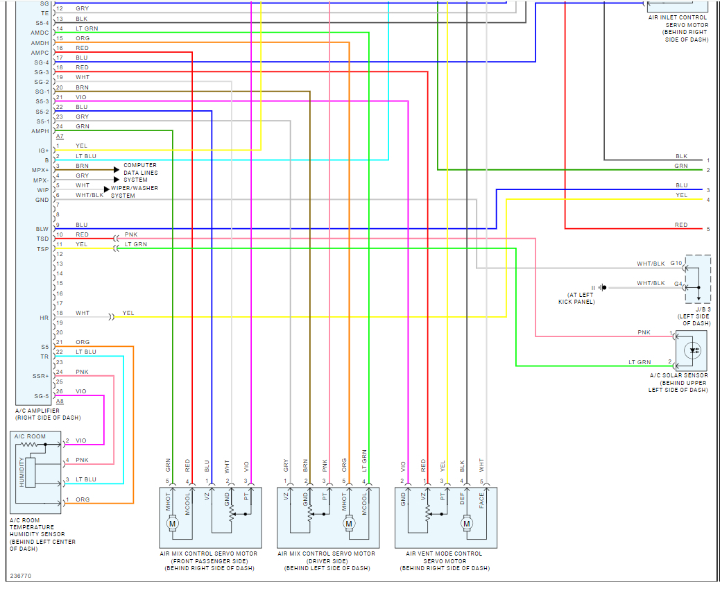

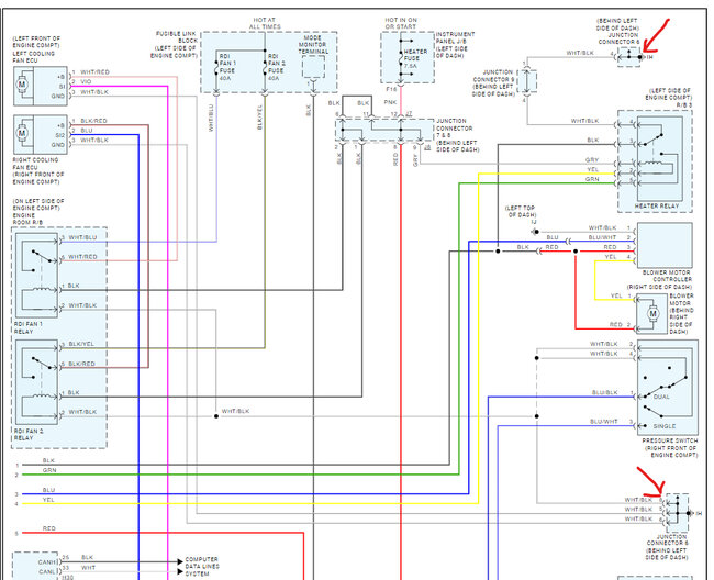

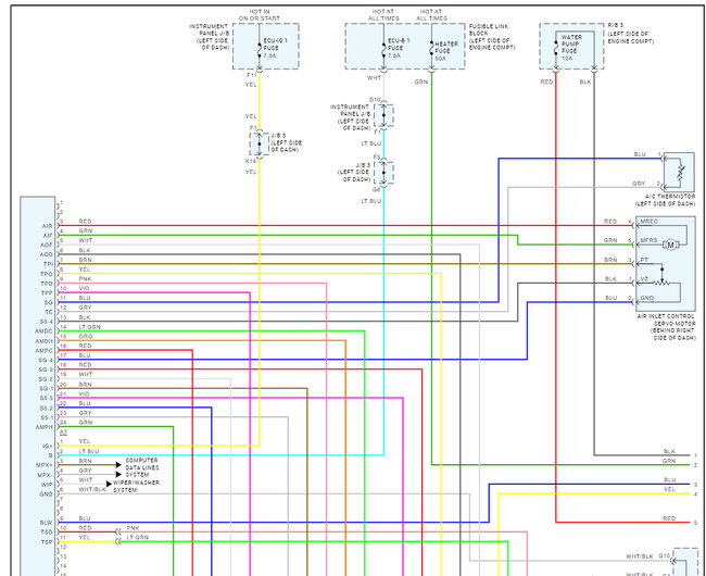

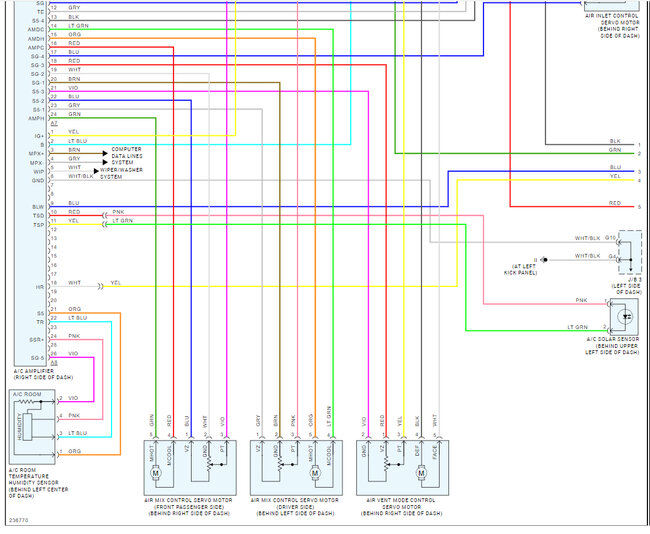

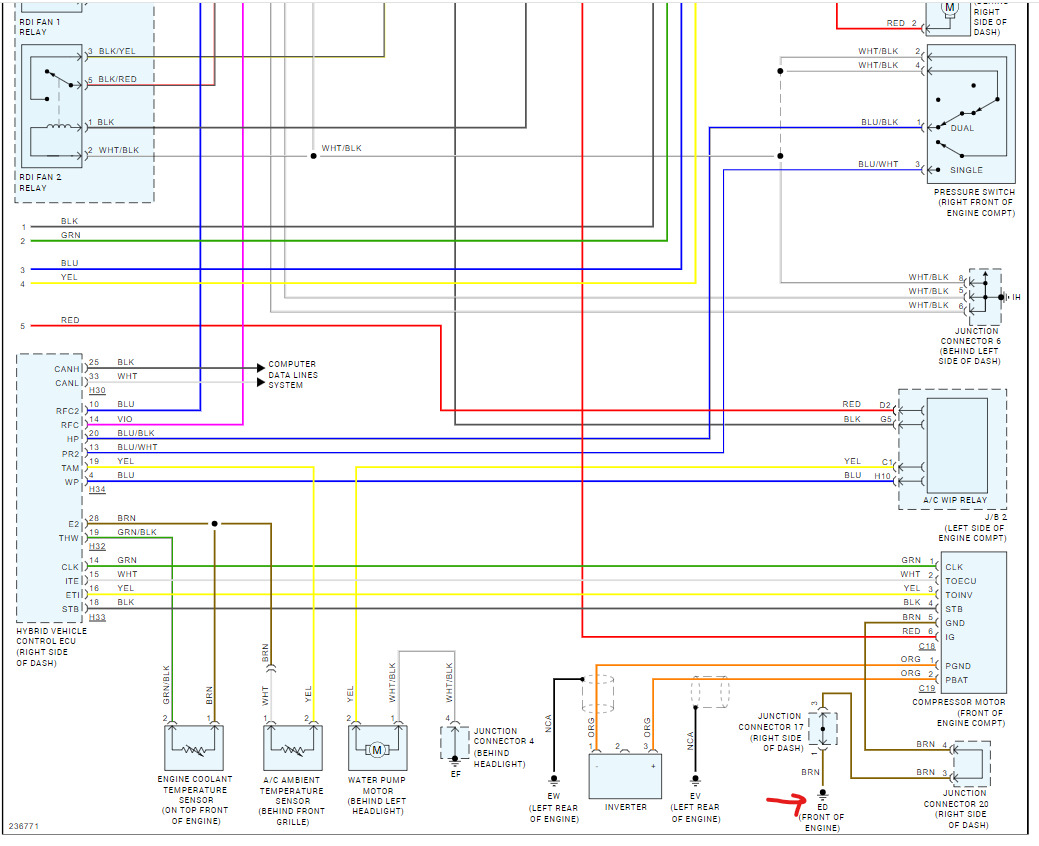

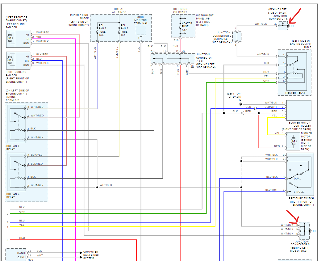

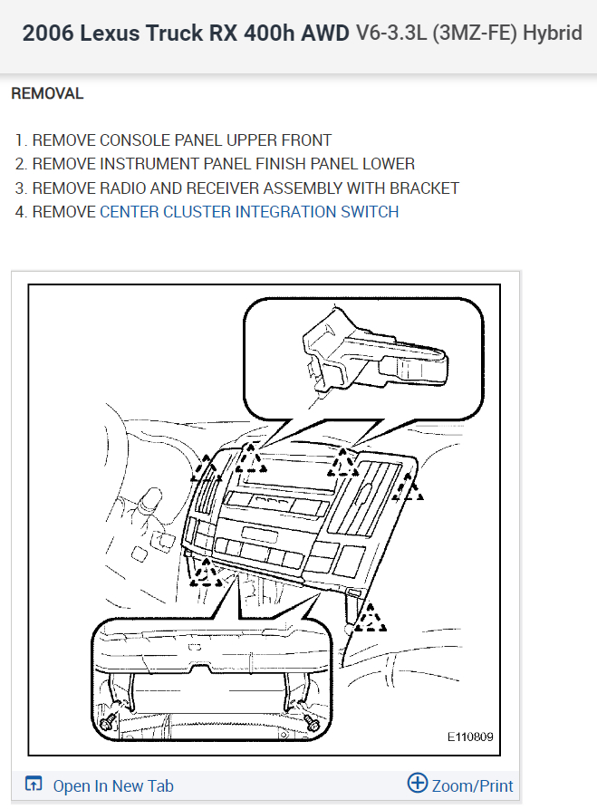

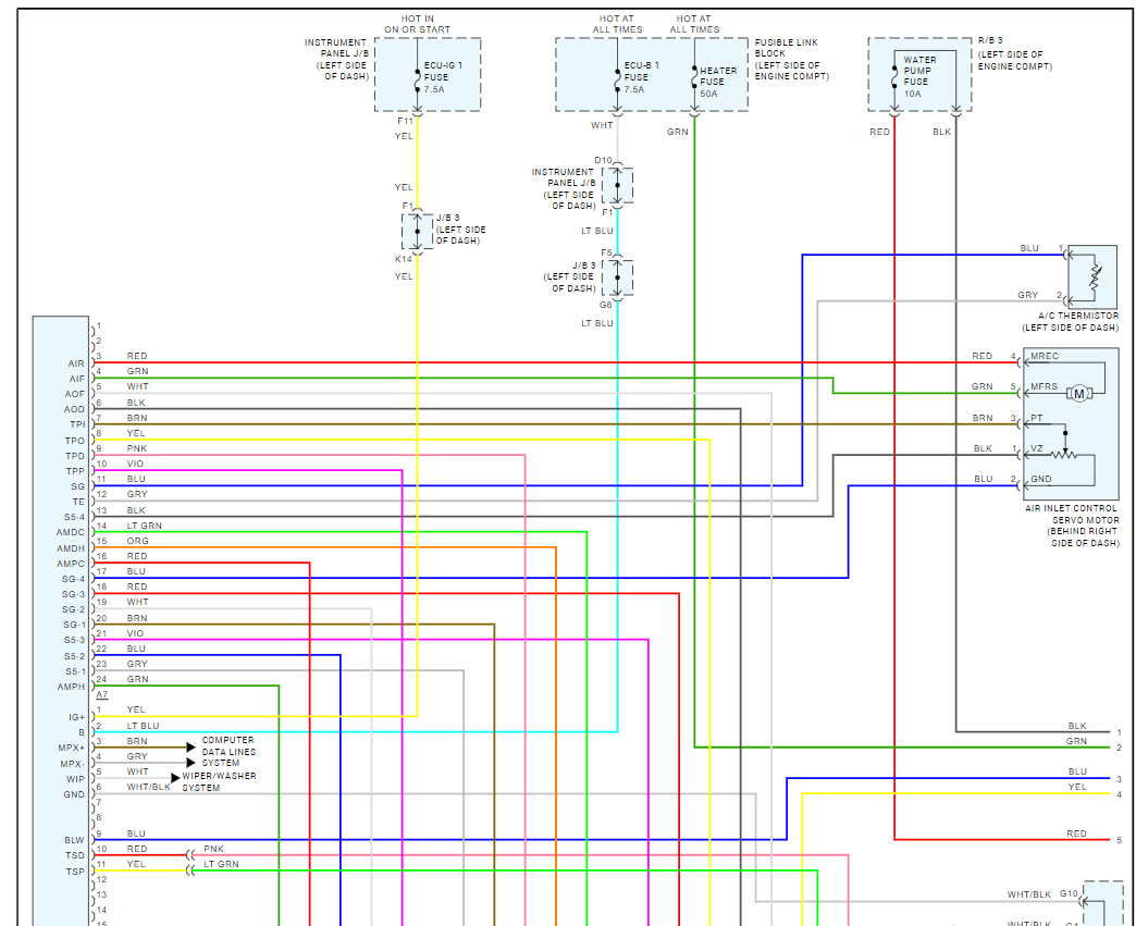

Okay, let check the wht/blk wire at the AC amplifier for ground, this guide will help and I have included the HVAC system wiring diagrams so you can see how the system works and which wires I am talking about, I marked them in red.
Here is how to remove the AC amplifier as well. This part may be bad, if it has power and ground get a used unit from ebay and try it. Check out the images (below). Please let us know what happens.

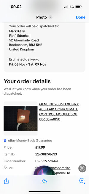

So I’ve had a mechanic look at it and he said I needed to replace climate control system. I have asked him what exactly that is but have not heard back from him. He said to look on eBay and I have bought what’s in the attached photo. Do you think this is what he meant?
Thanks very much,
Mark
Nov 7, 2024 at 7:27 AM
I know you checked the fuses but was there power at the fuse with the systems on? I don't think replacing the HVAC controller will fix the problem because there are two other systems that are not working which means a bad power source or ground, this is why I needed you to check the power source.
