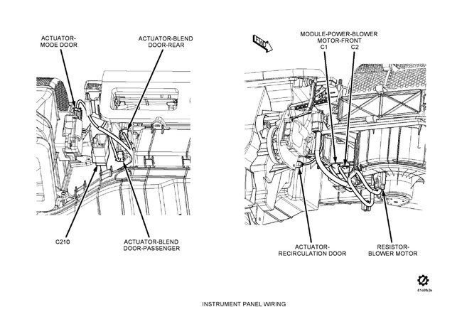

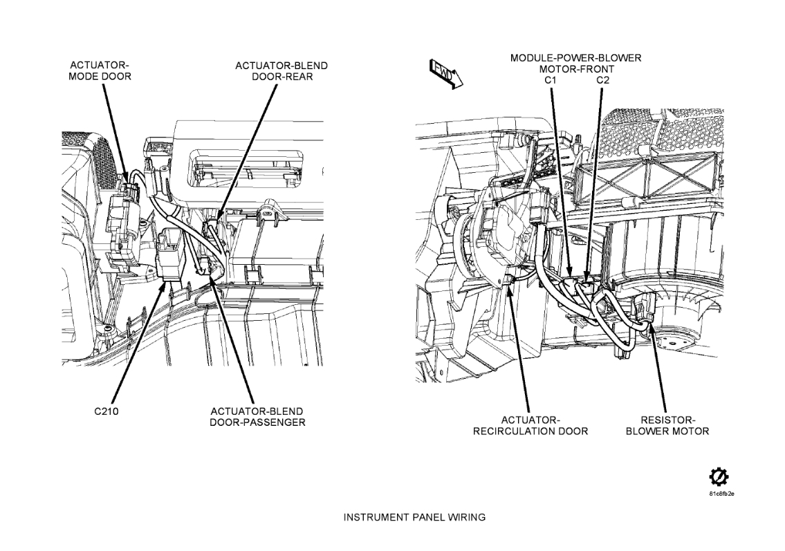

This sounds like the blower motor resistor needs to be replaced. Check out the diagrams (below). Please let us know what you find. We are interested to see what it is.

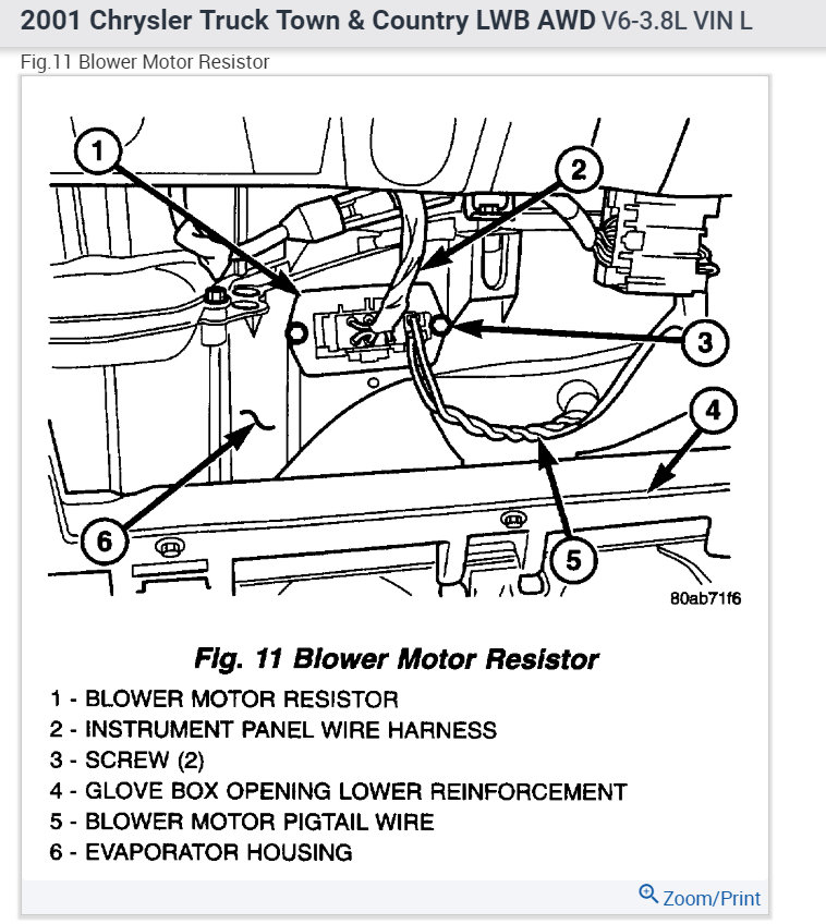

It is located under the dash on the passengers side here is a diagram to show you how to replace it and where it is located. Check out the diagrams (Below). Please let us know if you need anything else to get the problem fixed.
Cheers, caradiodoc

Hello, Sorry you wasted your money on another panel. Under the hood on the passenger side firewall next to the shock tower is your Blower Motor Resistor. Replace it. That is the usual cause of only one or one fan speed going out at a time.
https://www.2carpros.com/forum/automotive_pictures/188069_99towncountryblowerresistor_1.jpg
