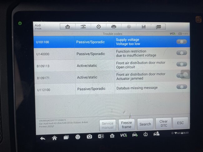

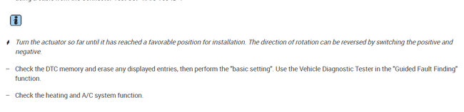

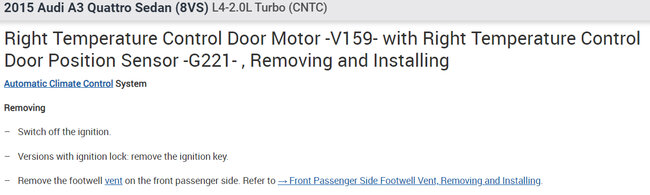

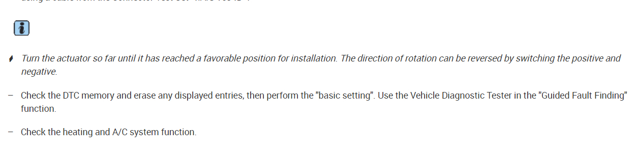

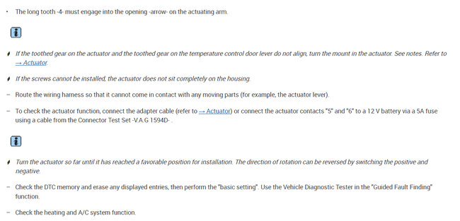

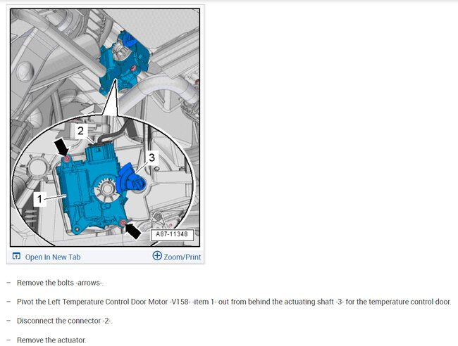

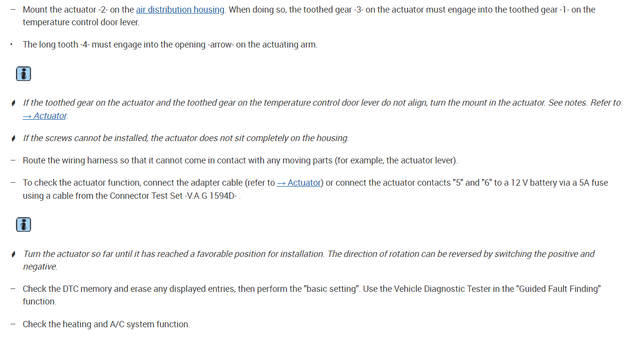

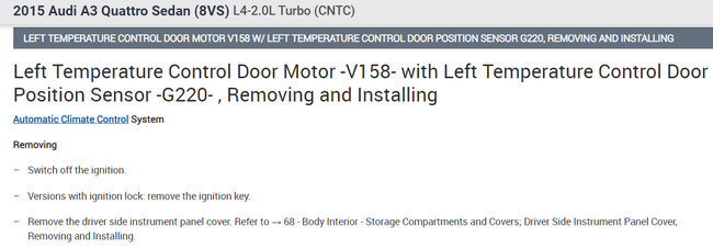

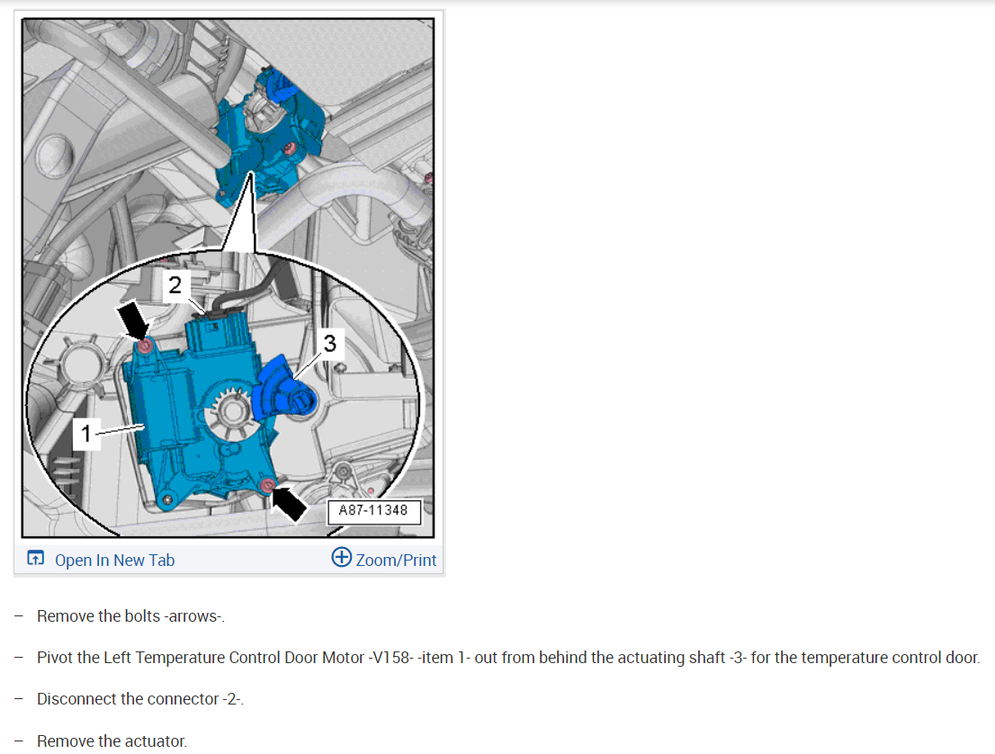

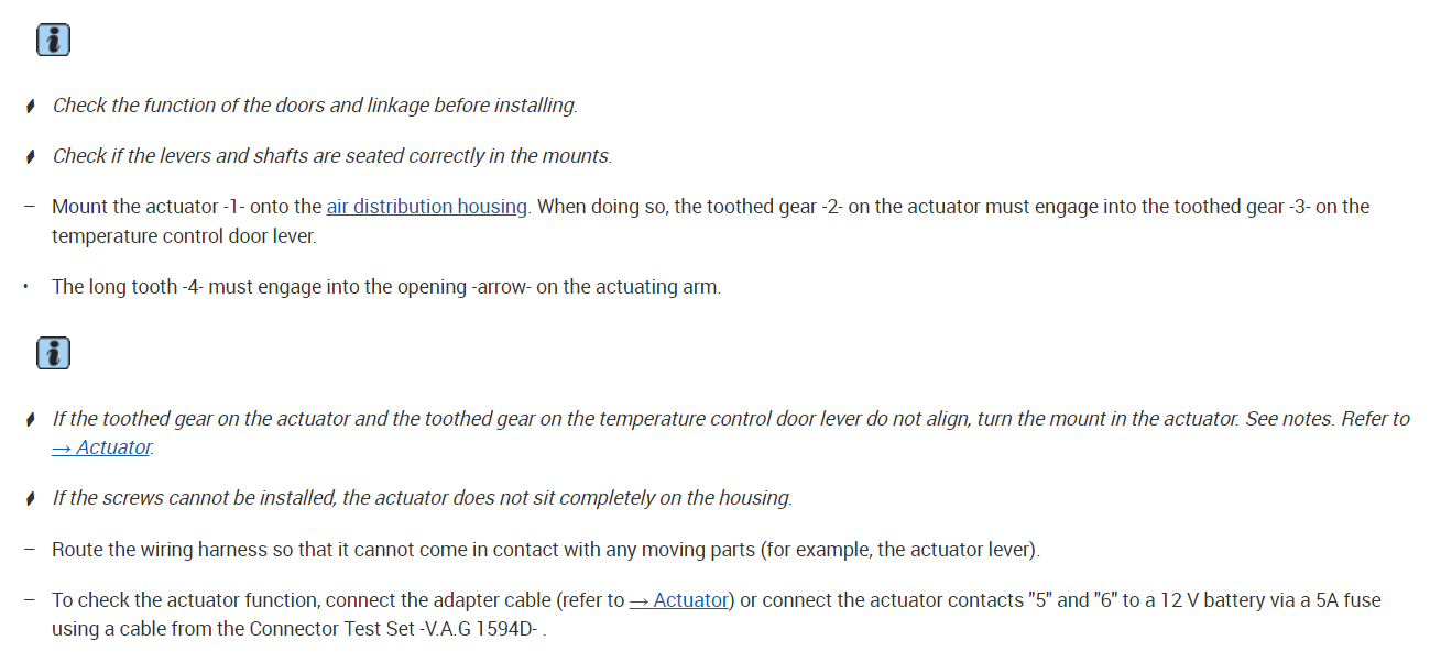

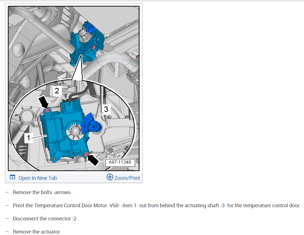

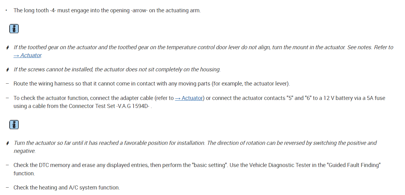

No heat from vents. Scanned it and found these codes. Battery was weak and still is a bit, may replace it, but it still starts every time. Deleted the codes and got heat. When I went to start it, this afternoon I got the same issue, cold air from vents. Where is this door and how to replace it, please? After deleting all the codes only the B109171 remained.
