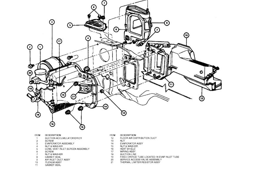

13. Remove one plastic push fastener retaining floor air distribution duct to left end of plenum. Remove left screw and loosen right screw on rear face of plenum. Remove floor air distribution duct.
A/C-heater Core System Components
14. Remove two screws from rear side of floor air distribution duct to plenum. To remove right screw, it may be necessary to remove the two screws attaching lower panel door vacuum motor to mounting bracket.
15. Remove push fastener attaching floor air distribution duct to left end of plenum, then remove floor air distribution duct.
16. Remove two nuts located along lower flange of plenum.
17. Carefully move plenum rearward, so that heater core tubes and plenum case upper stud clear openings in dash panel, then remove plenum from vehicle by rotating upper portion of the plenum forward, down and out from under instrument panel. It may be necessary to carefully pull lower edge of instrument panel rearward while plenum is being removed from behind instrument panel.

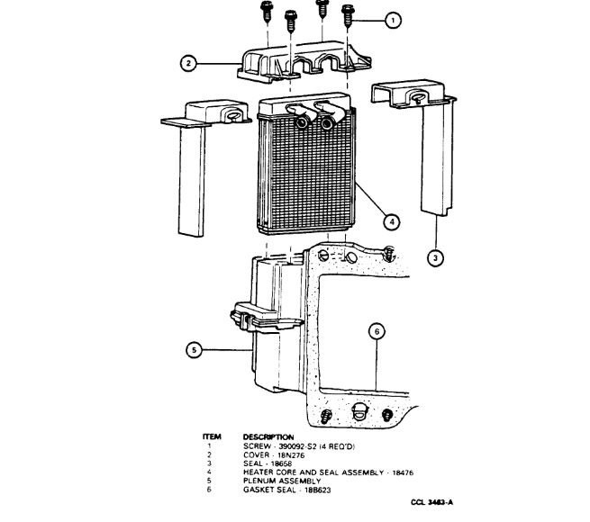

18. Remove retaining screws from heater core cover, then the cover from plenum assembly.
19. Remove retaining screw from heater core inlet and outlet tube bracket.
Heater Core Removal And Installation
20. Pull heater core and seal assembly from plenum assembly.
21. Reverse procedure to install.
