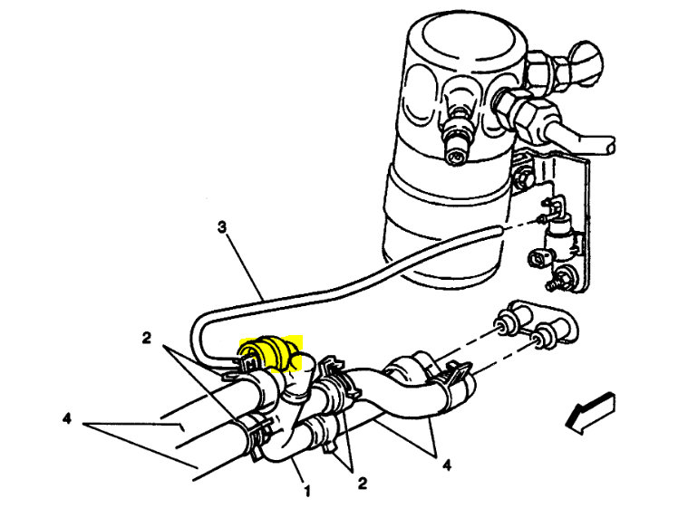

if your system does not have valve, Here's the description of your unit:
Description: System is a blend-air type. Outside air is heated and then mixed with cooler outside air to attain desired temperature. System consists of a blower and an air inlet assembly, heater air distributor assembly and heater control panel. Blower, air inlet assembly and heater hoses are located on the engine side of dash panel while heater core and distributor duct are on passenger side. System has no heater control valve. Coolant circulation keeps heater core hot at all times. Operation of blower motor is controlled by the fan switch. The motor is connected in series with the fan switch and blower resistor assembly.
