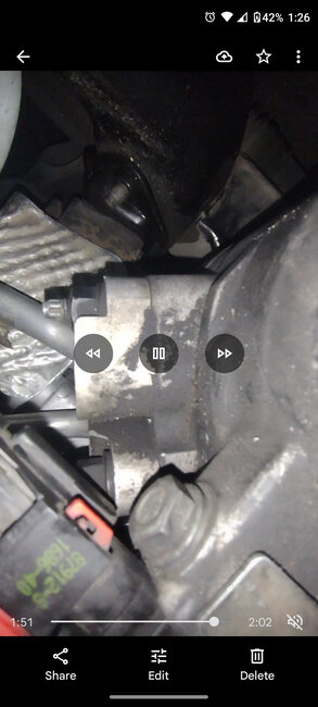

Is this the heater tube? Does it need a new gasket? Do I need to replace the thermostat? I'm losing coolant somewhere and this looks like it might be it.

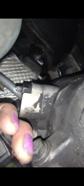

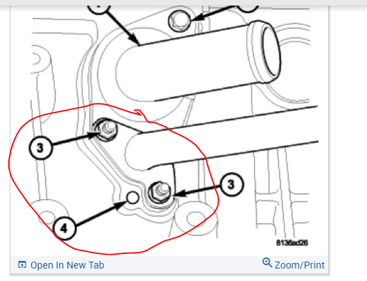

I can't seem to get the right bolt out. I can't even get the right angle to even loosen it. Is it normal to be leaking where it is or is there another issue I haven't found yet?
Dec 6, 2022 at 1:35 AM

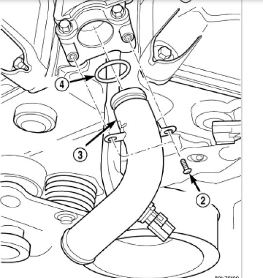

That appears to be the leak. There is an O-ring in there that has likely failed. That is referred to as the coolant outlet tube.
Looking at the video, the nuts appear to be accessible. What are you using to remove them?
See pic below.
Dec 6, 2022 at 2:40 PM

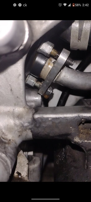

I finally got it loose, but it won't cover completely off. Maybe it's not supposed to.. But I can't get the thermostat out now.
Dec 8, 2022 at 1:53 AM
It should be removable. The problem is there is little room to work. Have you been able to identify if the gasket/o-ring is damaged?
As far as the thermostat goes, you need to remove the heater tube. Have you done that?

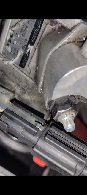

It definitely discharged from the top connectors. Maybe they loosened when I was lowering it. I don't know but A lot of Freon came out. Should I be worried?
Dec 11, 2022 at 6:54 PM
Don't be worried. However, I do need to know which connectors. If they leaked, they would likely need to be replaced. This will require the AC system to be vacuumed and recharged. Based on the connectors, we may also need to add PAG oil to the system.

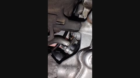

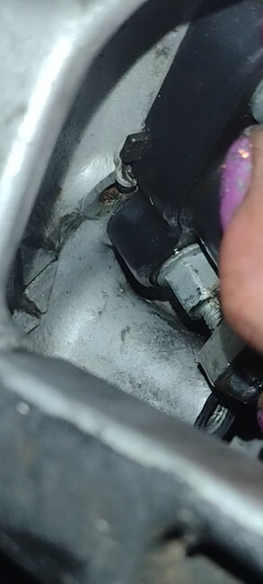

They are the two on the top of the unit. See pics
Dec 12, 2022 at 12:37 AM
That appears to be right at the compressor. The second pic above is a video, but I'm unable to play it.
If the two connectors you indicated leaked, first make sure the steel tubing wasn't damaged. If they are good, then there is an o-ring on each one that will need to be replaced.

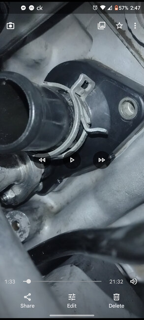

I started the car. The RPM is high at first then steadily drops until it sounds like it's going to keep dropping but I turned it off before then because I saw a leak at the coolant reservoir. The upper tube coming from the reservoir was leaking. Easy to fix but why? The clamp is on it... I'm going to upload a video after I fix that. Do I have to wait for it to cool now?
Dec 14, 2022 at 10:03 PM
make sure the hose wasn't damaged when you had things apart. It may have been stretched or cut by accident.
If the clamp being on, if pulled hard enough, it can still allow the hose to move, so check that as well.
Let me know what you find.
