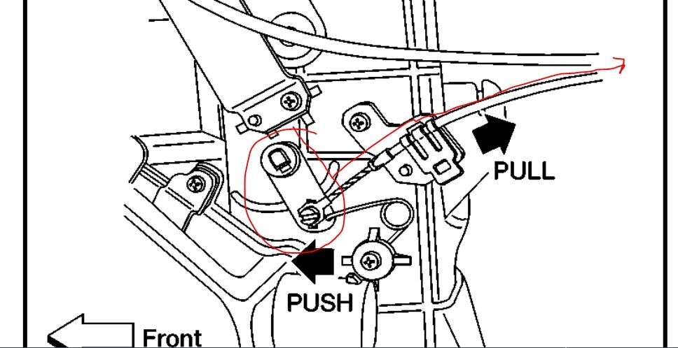

Now the good news. On this vehicle, the air temp door is mechanically operated by a cable that connects the door to the temperature switch on the dash. The door is located under the dash to the right of where your right leg would be. I attached a picture of the actuator and the directions for adjustment. Before going to the trouble of adjusting it, make sure when you adjust temp at the controller it moves.
Here are the adjustment directions. Often times, the cable mount will come loose and allow the cable to move rendering the it not functional.

2003 Nissan-Datsun Sentra L4-1.8L (QG18DE) ULEV
Air Mix Door Motor
Vehicle Heating and Air Conditioning Air Door Actuator / Motor Adjustments Air Mix Door Motor
AIR MIX DOOR MOTOR
Temperature Control Linkage Adjustment
pic 1
Temperature Control Cable
- Turn temperature control knob to the full cold position.
- Set the air mix door lever in the full cold position by hand.
- Pull on cable cover in the direction of the arrow and then clamp cable cover.
After positioning air mix door control cable, check for proper operation.
