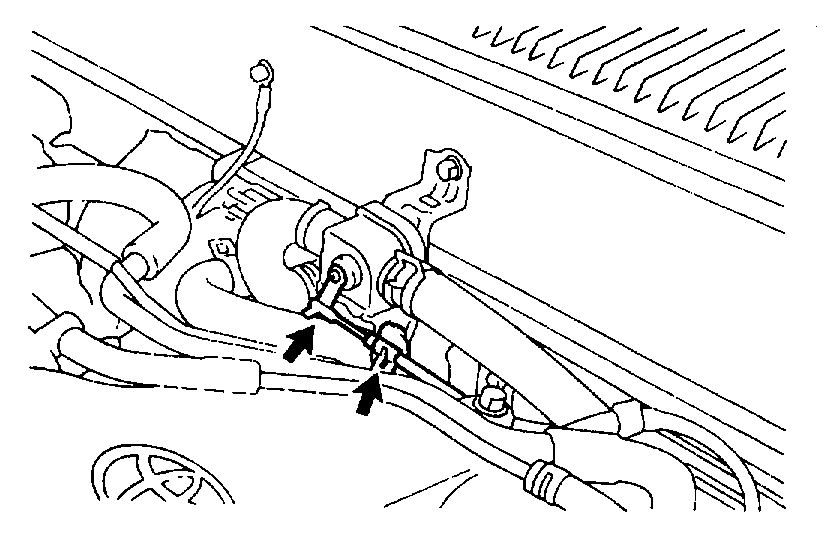

2. DISCONNECT WATER VALVE CONTROL CABLE FROM WATER VALVE
See picture 1

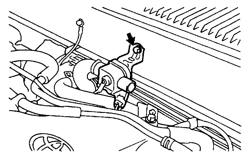

HINT: Manual A/C only: At the time of installation, please refer to the following item.
After connection, adjust the control cable
See picture 2

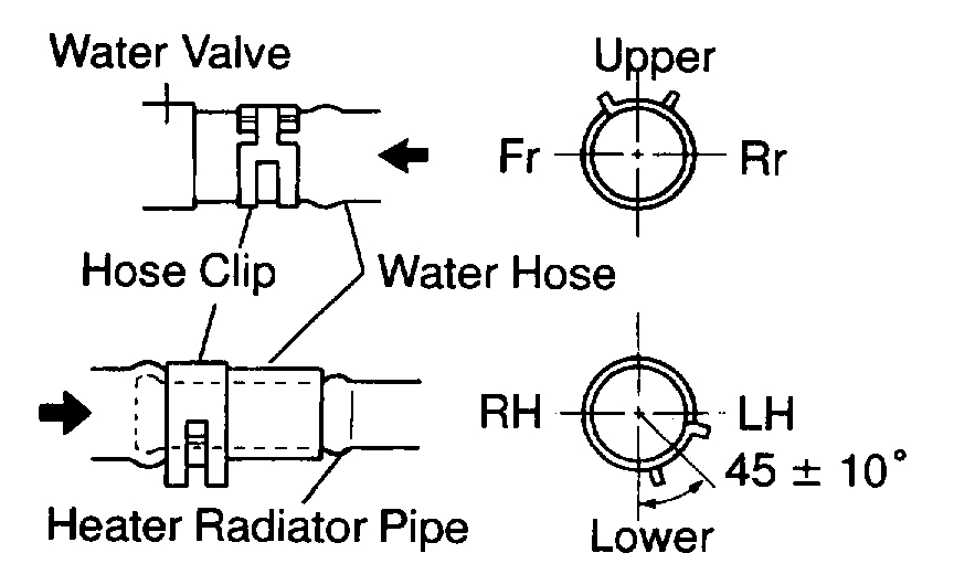

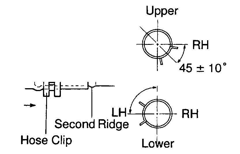

3. DISCONNECT WATER HOSES
a. Using pliers, grip the claws of the hose clip and slide the hose clip along the hose.
b. Disconnect the water hose.
See picture 3

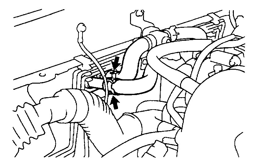

HINT: At the time of installation, please refer to the following item.
- Heater radiator pipe:
Push the water hose onto the heater radiator pipe as far as second ridge on the pipe.
- Water valve:
Push the water hose onto the water valve pipe as far as water valve.
- Install the hose clip in a position, as shown in the illustration.
See picture 4

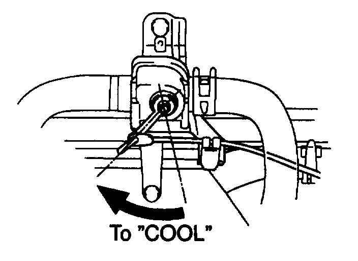

See picture 5
Auto A/C:
AFTER INSTALLATION, ADJUST WATER VALVE CONTROL CABLE
a. Ignition switch ON.
b. Set the temperature control door to "COOL" position and connect the control cable and lock the clamp.
HINT: Lock the clamp during lightly pushing the outer cable in the direction, as shown in the illustration by an arrow.

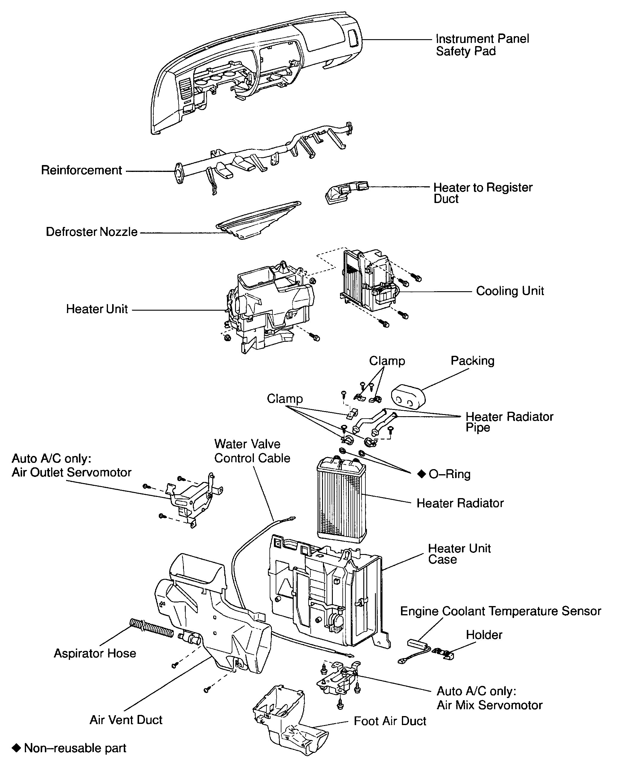

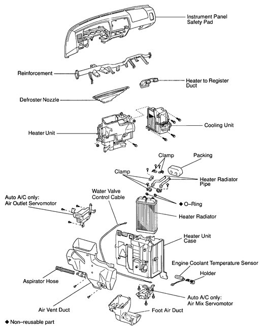

Here are the directions specific to your vehicle for core replacement:
__________________________________________

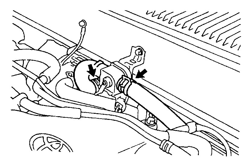

REMOVAL AND INSTALLATION
See picture 6
COMPONENTS
REMOVAL
1. REMOVE COOLING UNIT
2. DRAIN ENGINE COOLANT FROM RADIATOR
HINT: It is not necessary to drain out all the coolant.
See picture 7
3. DISCONNECT WATER HOSES FROM HEATER RADIATOR PIPES
a. Using pliers, grip the claw of clip and slide the clip along the hose.
b. Disconnect the water hoses.
See picture 8
HINT: At the time of installation, please refer to the following items.
- Push the water hose onto the heater radiator pipe as far as the second ridge on the pipe.
4. REMOVE INSTRUMENT PANEL AND REINFORCEMENT
5. REMOVE DEFROSTER NOZZLE AND HEATER TO REGISTER DUCT
6. REMOVE HEATER UNIT
a. Auto A/C models:
Disconnect the connector from mode control servomotor.
b. Auto A/C models:
Disconnect the aspirator hose from room temperature sensor.
c. Auto A/C models:
Disconnect the water valve control cable.
d. Remove the 2 nuts and heater unit.
