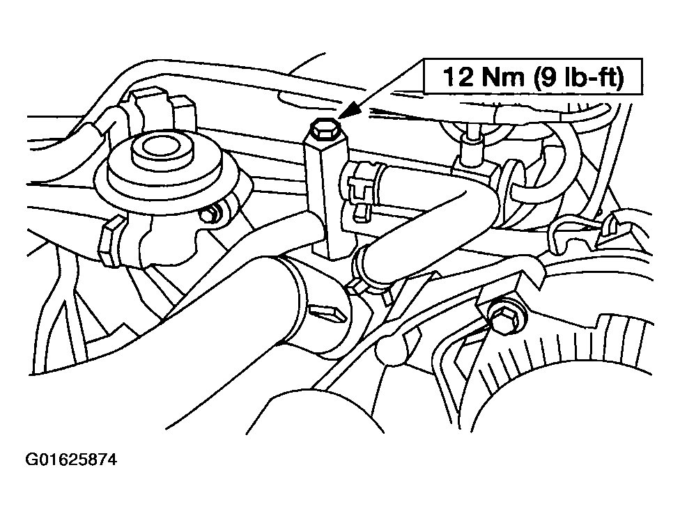

If 3.8L see pic for location of vent. run add coolant until coolant flows from vent
