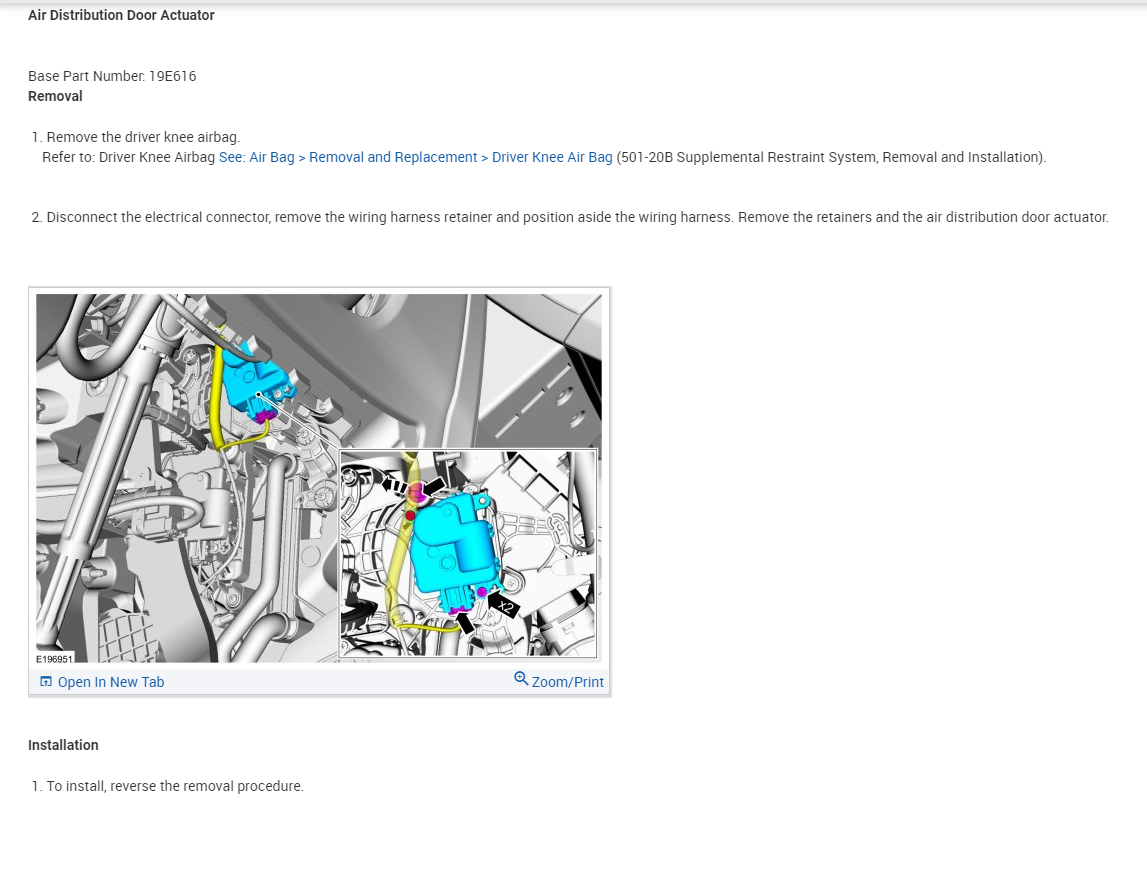

There is a mode door actuator that controls the air distribution. It is the most common failure for this issue.
I attached the procedure below for you to view.
Let me know if you have any other questions.
