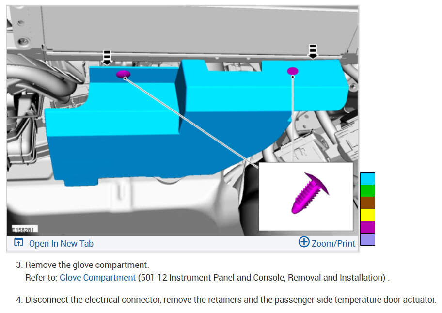

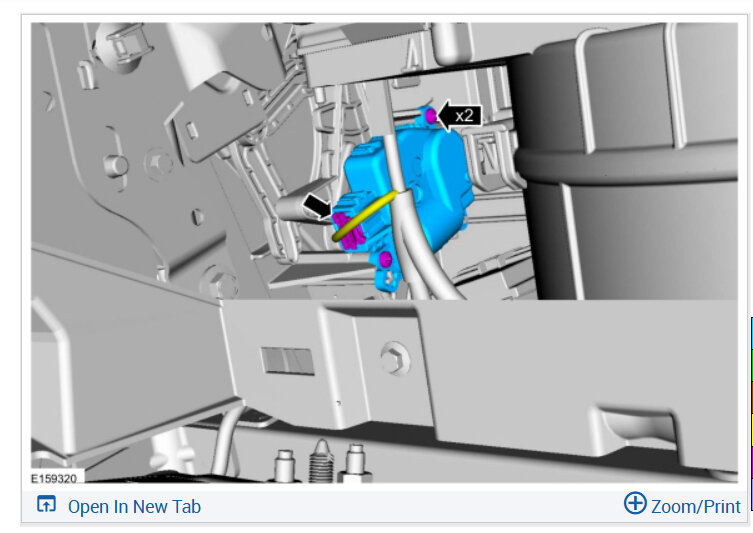

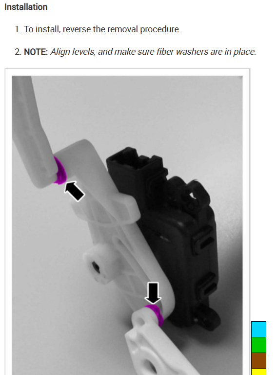

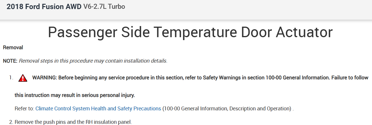

First we need to make sure you replaced the correct part, here is the location of the passenger's side blend door actuator. Also, when the actuator is removed work the blend door pivot by hand to see if anything changes. Also, work the HVAC controls while the actuator is still plugged in to see if it works. Check out the images (below). Please let us know what happens.
