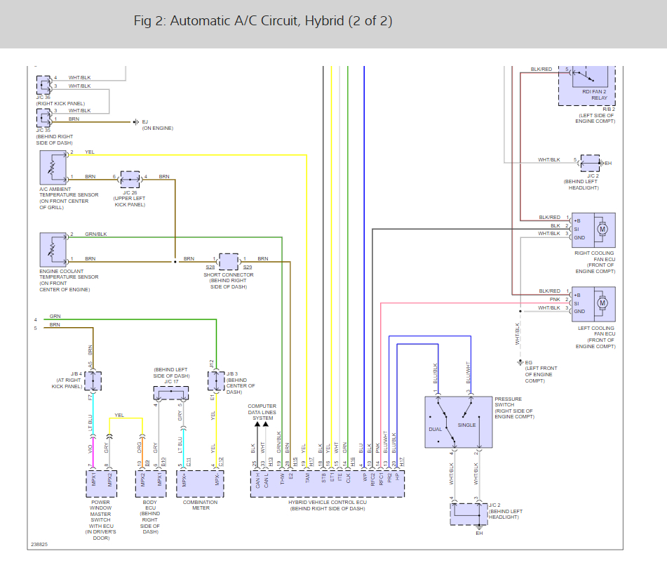

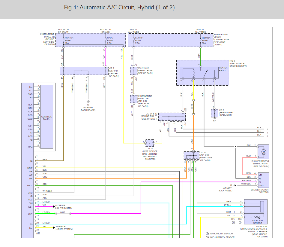

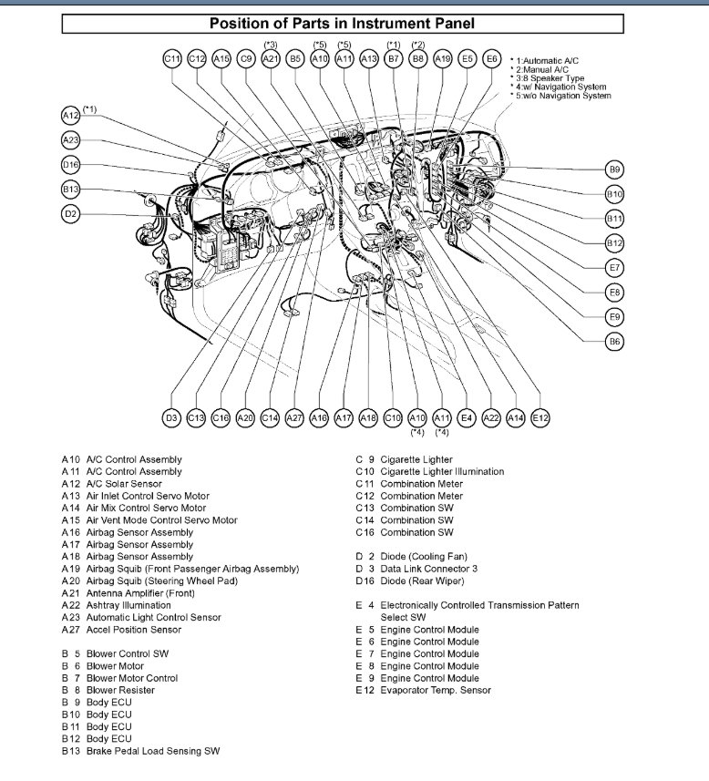

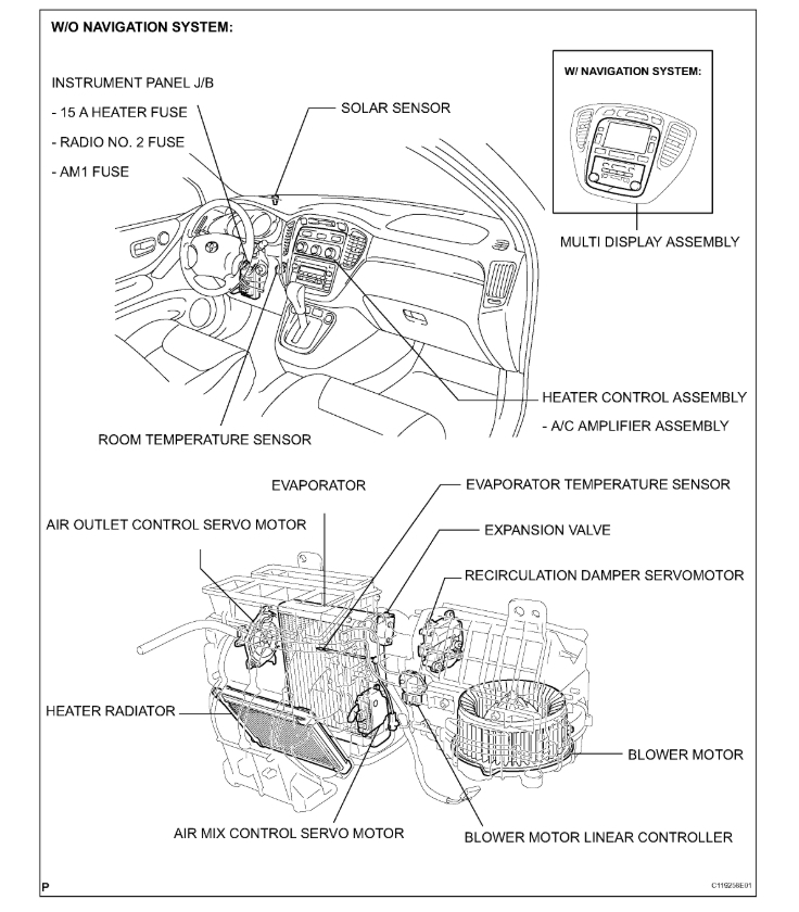

It sounds like you got the wiring connected incorrectly. here is a guide to help you test the connections and the HVAC wiring diagrams so you can see how the system works:

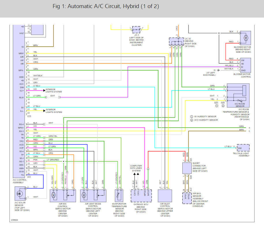

So it is still not fixed. I looked over the wiring diagrams and thought about the problem and decided that it could be one of the servo motors not working. I then took the easy route and asked the local Toyota dealer to look at it. They said that in their opinion, I damaged the circuit board when I re-soldered the wires on the temperature control. They wanted $1,200.00 for a new controller. Thinking they knew more than I did, I ordered a controller and put it in. Didn't fix it. I went back to my original thought of a bad servo motor likely on the blend door. I found it and after removing it, it tested bad. I have a new one coming so I will update you when I get it in.

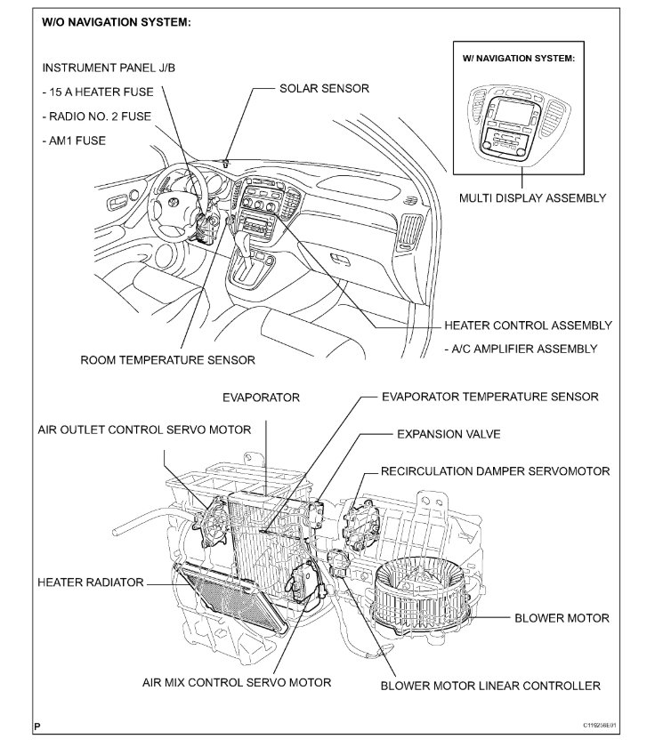

Good work, please let me know what happens, 9 times out of 10 it is the blend door actuators. Here is a guide to help walk you through the repair with diagrams below to show you on your car:

Thank you for your help. I had two issues that are now resolved. There were wires broken on the control panel controlling the temperature and the blend door servo motor was not working. I replaced both items and now can control the heat settings. I did take the servo motor apart to see what had happened. There was a black coating on the armature that resembles carbon. I cleaned it off and the motor works now but of course I had to cut the motor apart so it isn't usable. Thank you again for your help, I learned a lot on this one.
