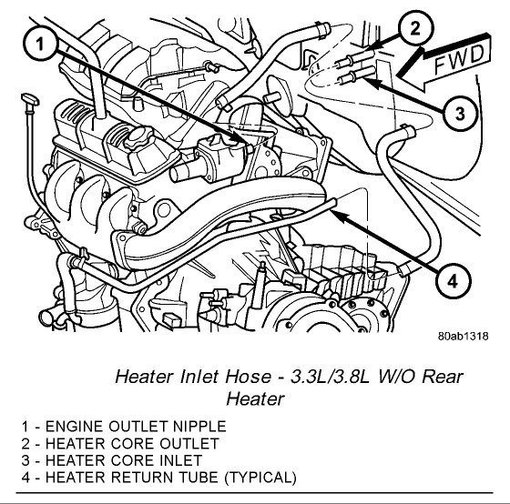

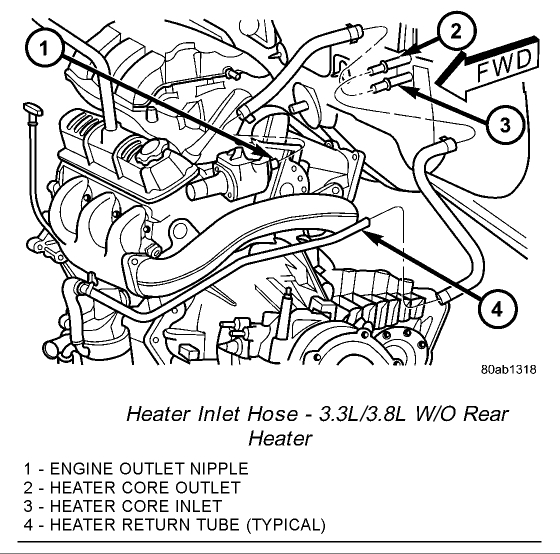

(Image1) The upper hose is the inlet hose, if it is getting hot but the lower one is not you have a plugged heater core. If you have the rear heat option and feel no heat from either front or rear heating systems then this is the problem as the coolant goes through the front core then out and to the rear core and back to the engine. It could be a damaged tube under the vehicle as well. A plugged core is also the most likely issue if you have the split passenger/driver heat system with no heat to either side as both sides use the same heater core.

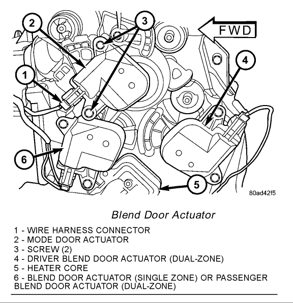

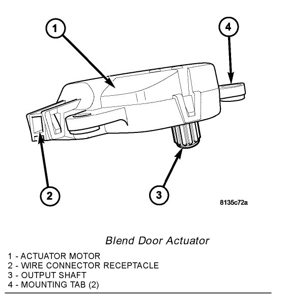

If both heater hoses are hot, then it is more likely the temperature blend door actuator that has failed. (image 2) On this van this is not a hard repair. You start by disconnecting the negative battery terminal. Next you remove the isolation panel that is above the drivers side foot-well. Once it is off you can look above the gas pedal and you will see the actuators on the end of the HVAC case. (image 3) The one marked with the 6 is for the blend door in the non-split system. To remove it you disconnect the wire connector, remove the two screws and pull it straight out. Reverse the process to install the replacement.
Once it is replaced you need to re-calibrate the system.
1 - Re-connect the battery.
2 - Turn the ignition switch to the "on" position.
3A - If equipped with the manual temperature control, press and hold the rear wipe/wash and re-circulation buttons for at least five seconds. The A/C heater control rear wipe/wash button LED and re-circulation button LED's will begin to flash when the calibration has begun. The process should complete in under two minutes.
3B - If equipped with the automatic temperature control, simultaneously press and hold the power and re-circulation buttons on the A/C heater control for at least five seconds. the ATC A/C-heater control delay and re-circulation graphics will begin to flash when the calibration procedure has begun. The process should complete in twenty seconds.
In both systems if the LED's or graphics continue to flash beyond the stated calibration times, it indicates that the controller has detected a problem and set a code. The LED's or graphics will continue to flash until a successful calibration is completed or until the vehicle has been driven about ten miles.
A faster way to determine if it is a faulty actuator without swapping anything out is to use a factory level scan tool to read the any codes stored in the HVAC control module. A bad unit will set a code.
Another thing you can try would be to run the re-calibration on it as it is. It may re-calibrate and start working if the system just lost the position of the actuator or if there is a code stored it will flash the LED's until you drive it the ten miles. Might help you pin it down as a plugged core would not set a code.
