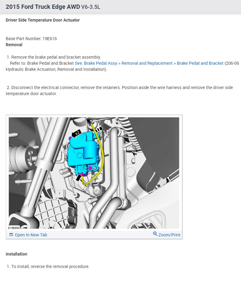

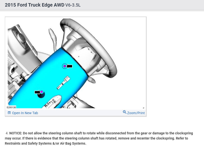

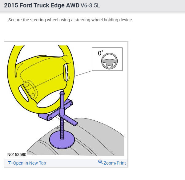

My heater is no longer working on just the front driver's side. It blows cool air out of all vent options. The passenger side and all vents in the back blow hot. Coolant level is where it should be, I’ve tried a reset trick I’ve seen online, and it won’t work.
