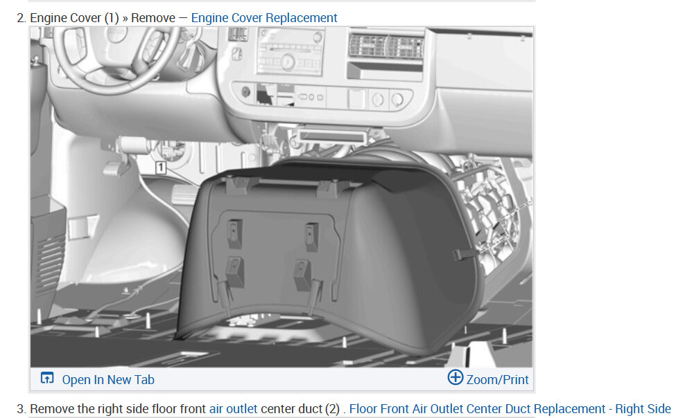

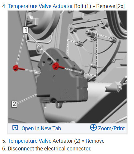

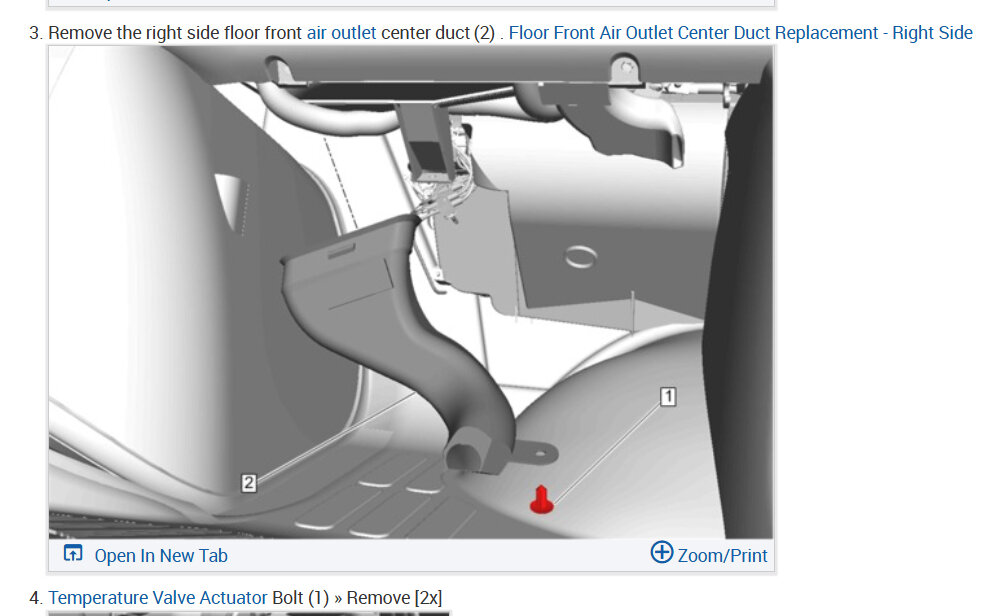

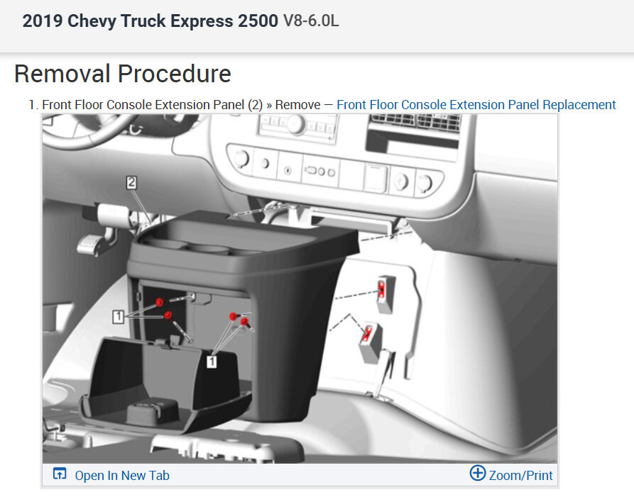

My van listed above will not blow heat out of the floor setting. I can change it to air, and it blows out the floor fine. The heat will come out anywhere else I want it to besides floor. Any Help is appreciated. Thank you!
