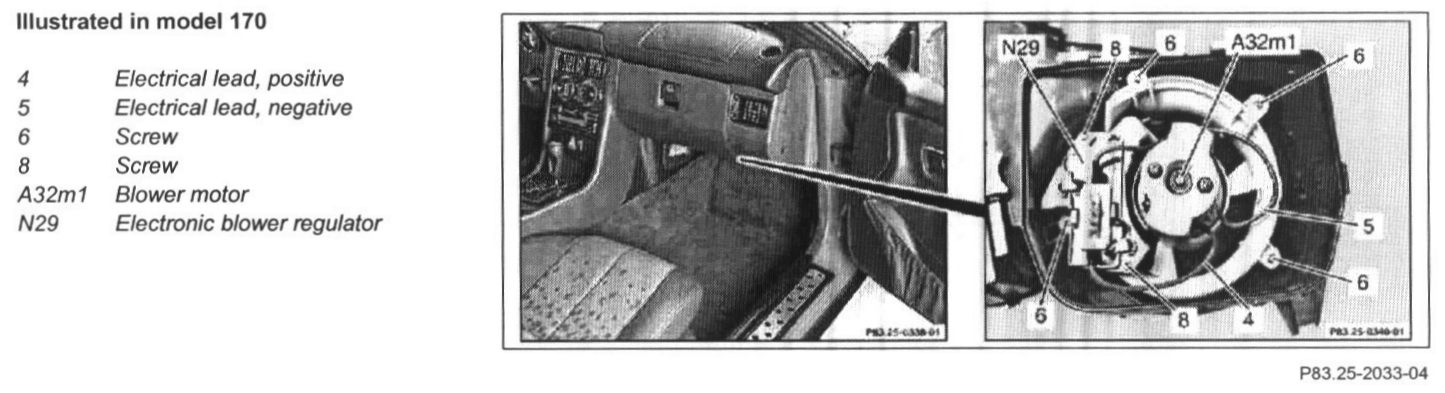

Here are the directions specific to your vehicle for replacement. Picture 1 correlates with these directions.
REMOVE/INSTALL BLOWER MOTOR
Removing and Installing Blower Motor
Picture 1
1 Remove electronic blower regulator (N29)
2 Unscrew screws (6)
3 Remove blower motor (A32m1)
4 Install in opposite order.
___________________________
Let me know if this helps or if you have other questions. Based on your description, it seems the bearing in the blower motor is dry or going bad.

When you take out the motor check the fan to make sure there are no leaves or other things that would make noise when the fan is turned on.
