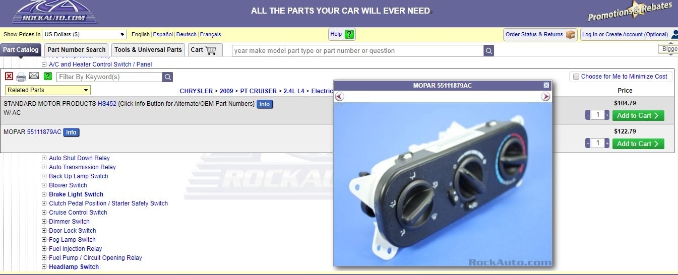

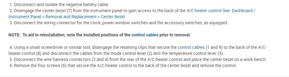

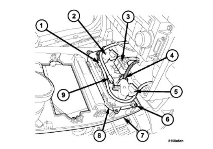

Good afternoon,
I do not see a procedure for the switch. only the control head itself.
I posted the procedure for removing it and posted the part as well.
Feb 17, 2020 at 10:32 AM
