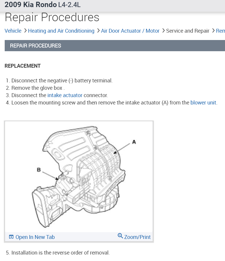

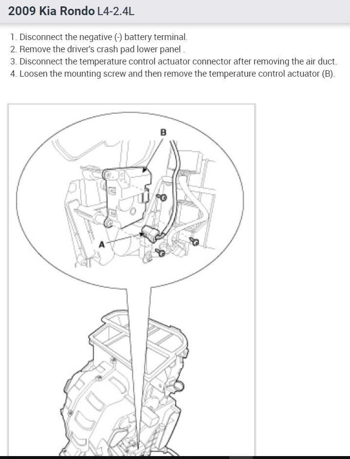

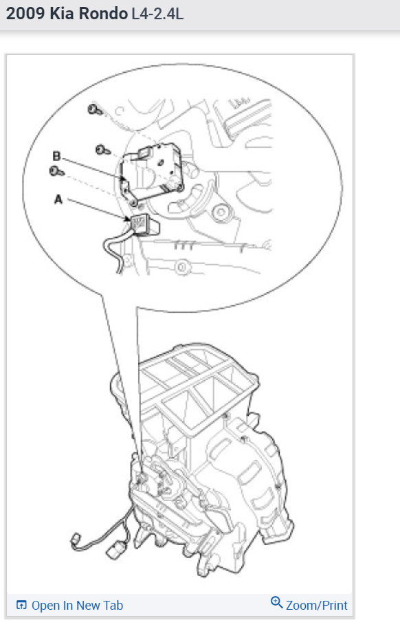

It sounds like the mode blend door actuator is going out. here is the location of all the blend door actuators so you can see how the system works and which actuator to replace with a guide to help walk you through the repair:
