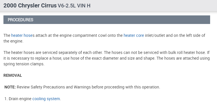

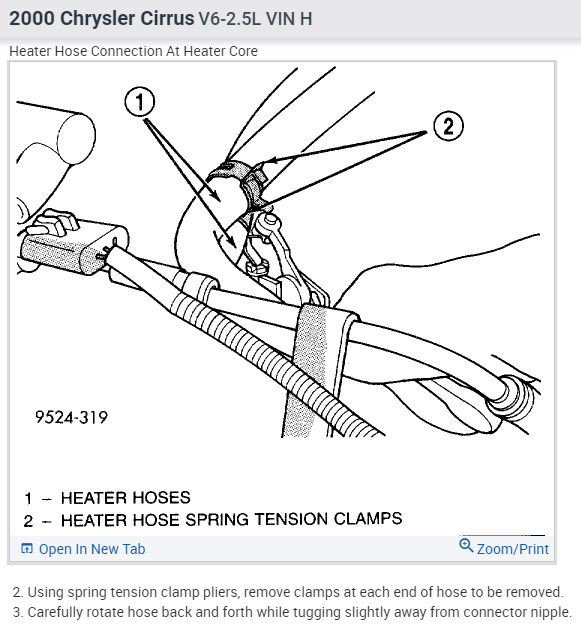

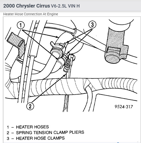

Here are a few tutorials for you to read to get you started:
https://www.2carpros.com/articles/replace-heater-hoses
I can also include heater core instructions/pictures if needed. I've attached step by step pictures below.Hope this helps and thanks for using 2CarPros.

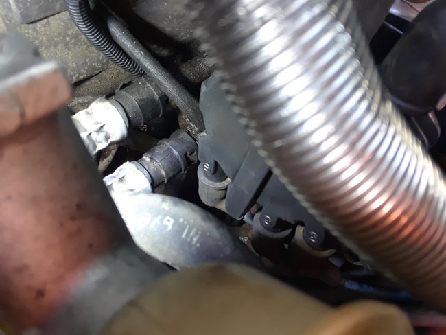

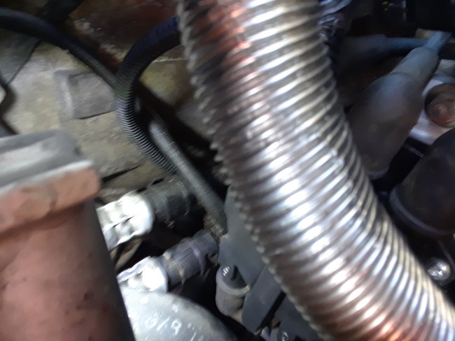

JAMIE SHIELDS
  • 28 POSTS
I'm taking a couple pictures of the heater hoses coming out of the engine block. I am going to send them to you right now. there's a couple couplers on never seen before. how to get them off?
Aug 19, 2019 at 11:30 AM
Those are quick connect fitting which just push on at the factory, it will have a small safety and you will need to squeeze the connector to remove.
Aug 22, 2019 at 11:59 AM
