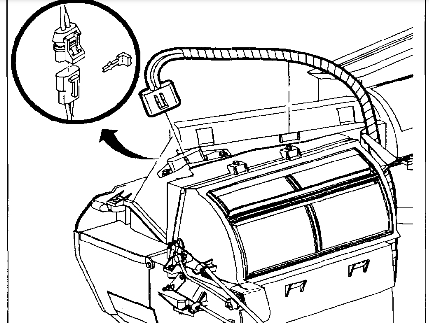

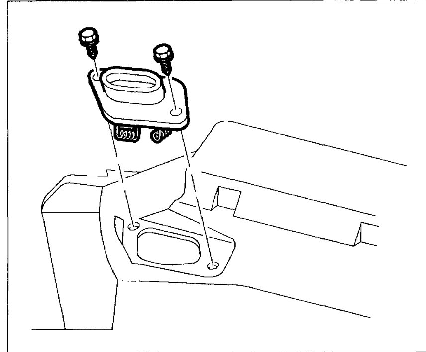

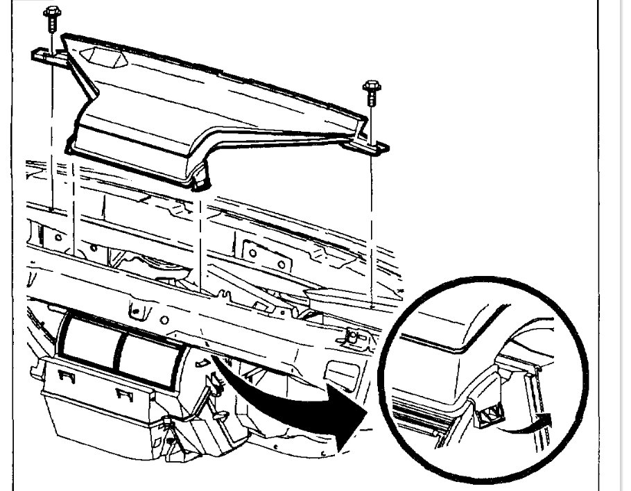

The resistor is located under the defroster grille on the HVAC box. I'll post the steps and pictures below on how to access it.
1. Disable the SIR system. (Remove negative battery cable and wait ten minutes)
2. Remove screws and unsnap windshield defroster duct from mode valve assembly. Lift up on defroster duct and move it to the right. This will allow access to resistor assembly.
3. Disconnect blower motor resistor connector.
4. Remove screws and blower motor resistor.

Can you clarify whether you are accessing the resistor from inside the car or from under the hood?
Feb 24, 2019 at 9:33 AM
KENW1
  • 213 POSTS
You'll be gaining access inside the car via removing the defroster duct.
