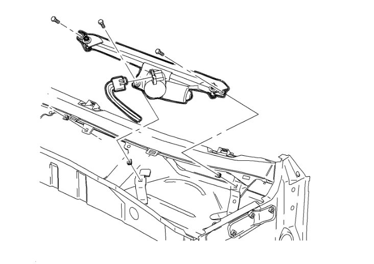

Below is the procedure and some pictures for you to view.
It is outside the car under the wipers.
REMOVAL PROCEDURE
1. Select the following settings:
1. Turn the ignition ON
2. Select Recirc in the OFF setting
3. Turn the ignition OFF
2. Disconnect the negative battery cable.
3. Remove the wiper arm assemblies.

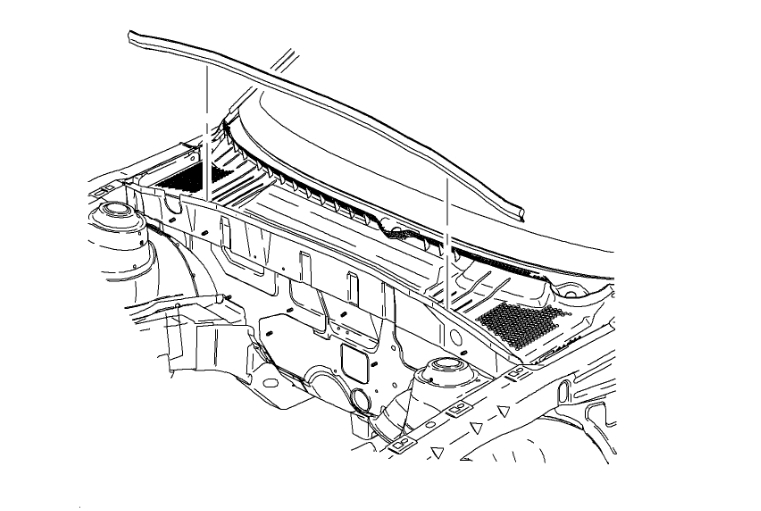

4. Remove the weatherstrip at rear of the engine compartment.
CAUTION: A sharp edge is revealed once the weatherstrip is removed.

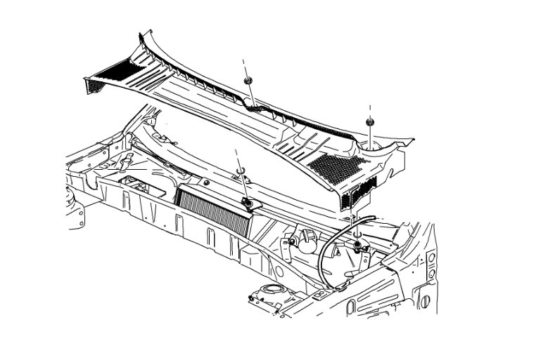

5. Remove the cowl retaining nuts.
6. Remove the cowl screen assembly.

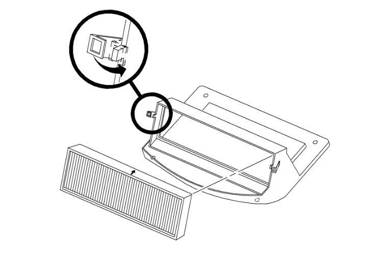

7. Rotate the locking tabs outward to release the filter assembly.
8. Remove the filter by lifting straight up.

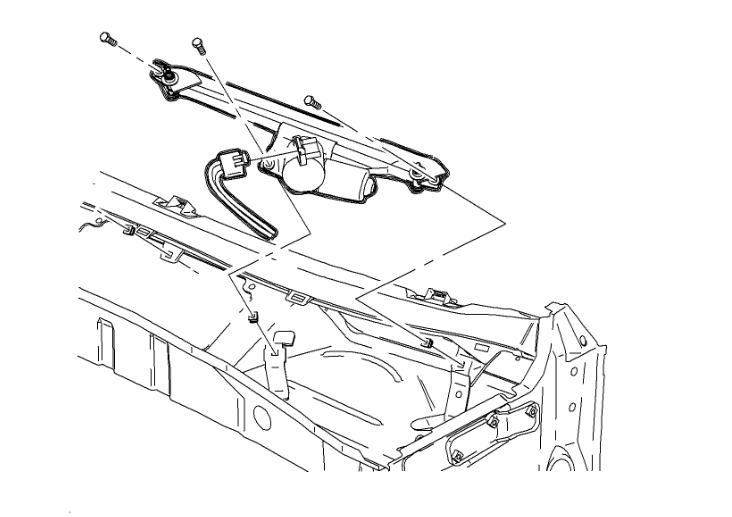

9. Remove the wiper module retaining bolts.
10. Reposition the wiper module to the right.

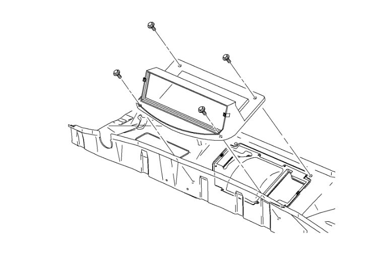

11. Remove the filter housing attachment bolts.
12. Remove the filter housing.

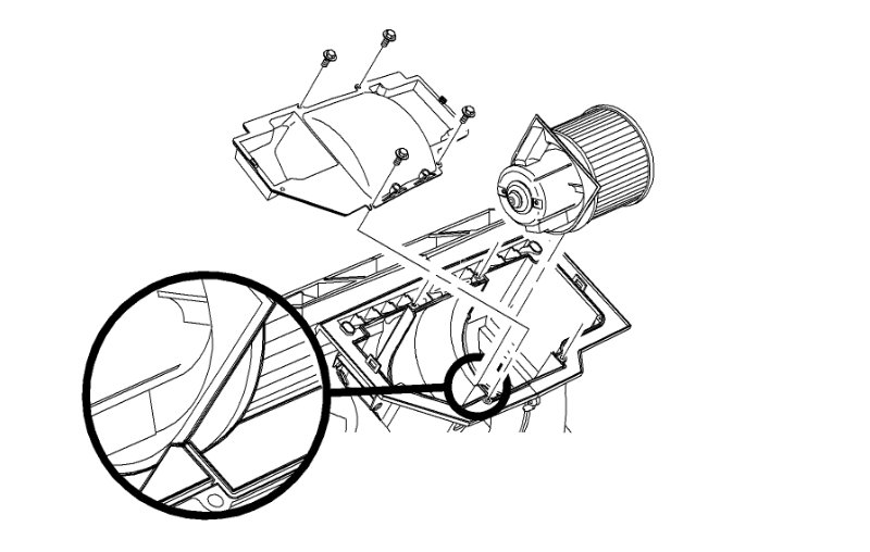

13. Remove the blower motor housing:
1. Remove the blower motor housing screws
2. Release the locking tabs and remove the fan housing
14. Disconnect the blower motor electrical connector.
15. Squeeze the bottom of the connector and pull downward.
16. Remove the blower motor assembly by lifting straight out.
