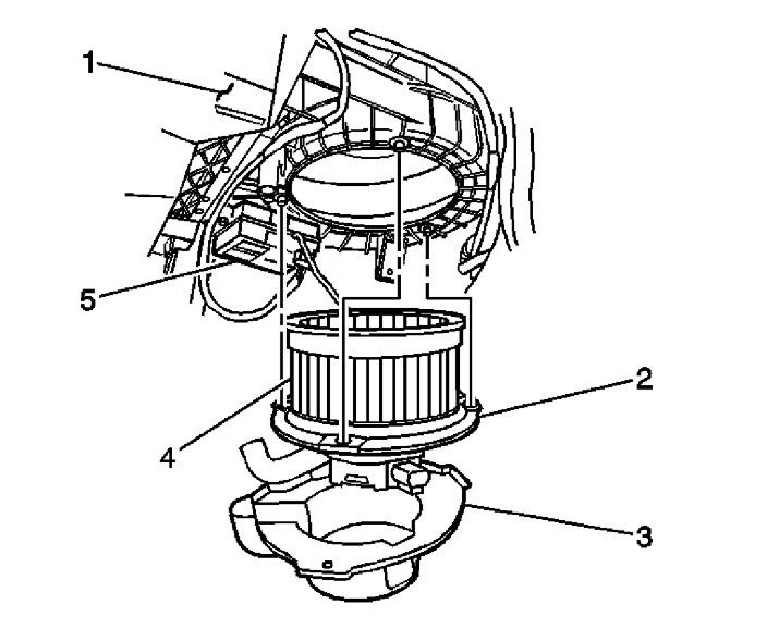

Also where is blower fan located? it is my parents did not look at yet usually it is on firewall under hood possibly under dash on passenger side.

Good morning,
I attached a picture and the procedure for you for the blower motor.
REMOVAL PROCEDURE
1. Remove the right closeout/insulator panel.
2. Remove the I/P storage compartment door.
3. Disconnect the blower motor electrical connector.
4. Remove the blower motor mounting screws.
5. Remove the blower motor cooling tube.
6. Remove the blower motor (2).
