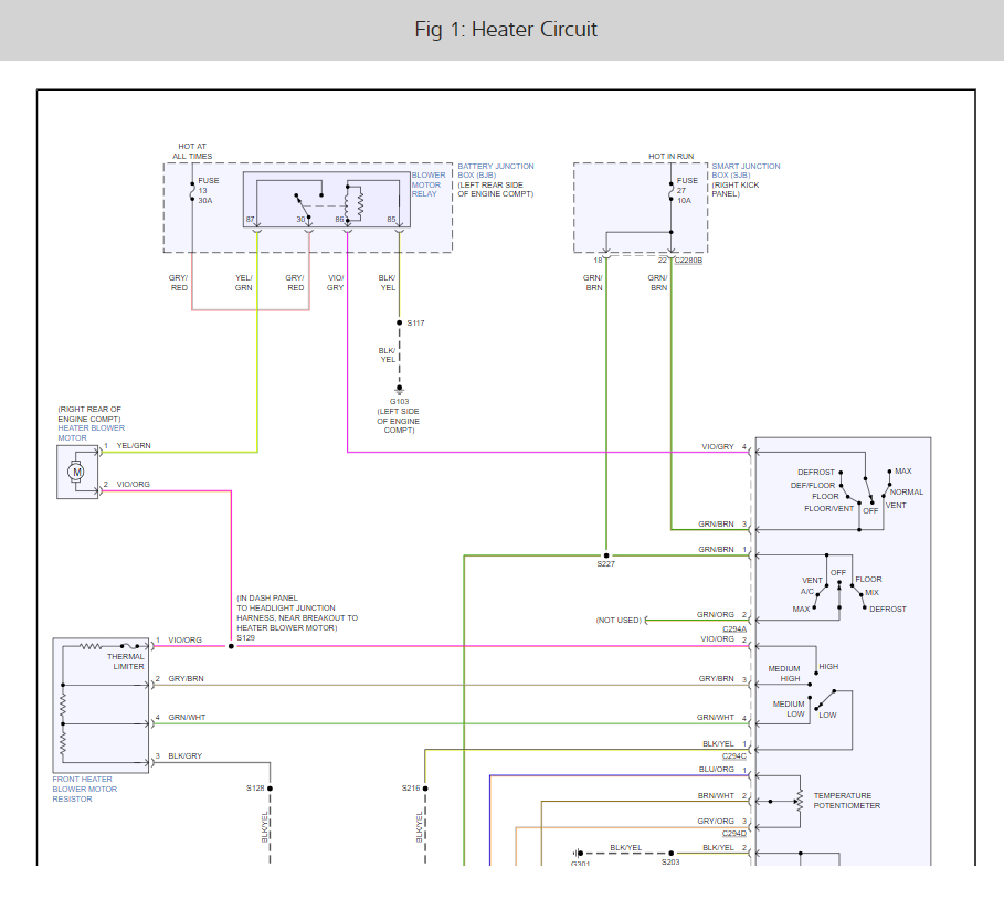

Replaced blower motor resistor, fan still will not come on.

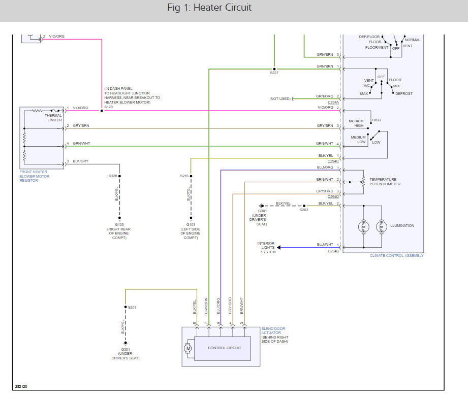

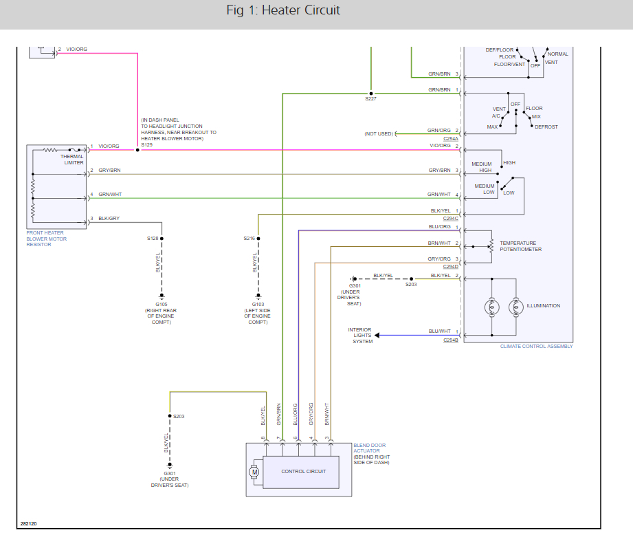

Have you tested the blower motor itself to see if working? Hope this helps and feel free to ask any questions. I have attached a tutorial to show what is involved. Thanks for using 2CarPros.
Danny-
https://www.2carpros.com/articles/blower-fan-motor-works-on-high-speed-only
and
Check out the diagrams (Below). Please let us know what happens.
