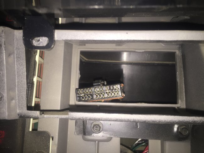

I've got the meter and control disconnected
Jan 9, 2017 at 4:13 PM
SCOTTSCOTT07
  • 21 POSTS
The 3 on the top left and the top and bottom far right are hot
Jan 9, 2017 at 4:27 PM
DOCFIXIT
  • 18,828 POSTS
Then it is not an electrical issue so looks like control module is faulty
