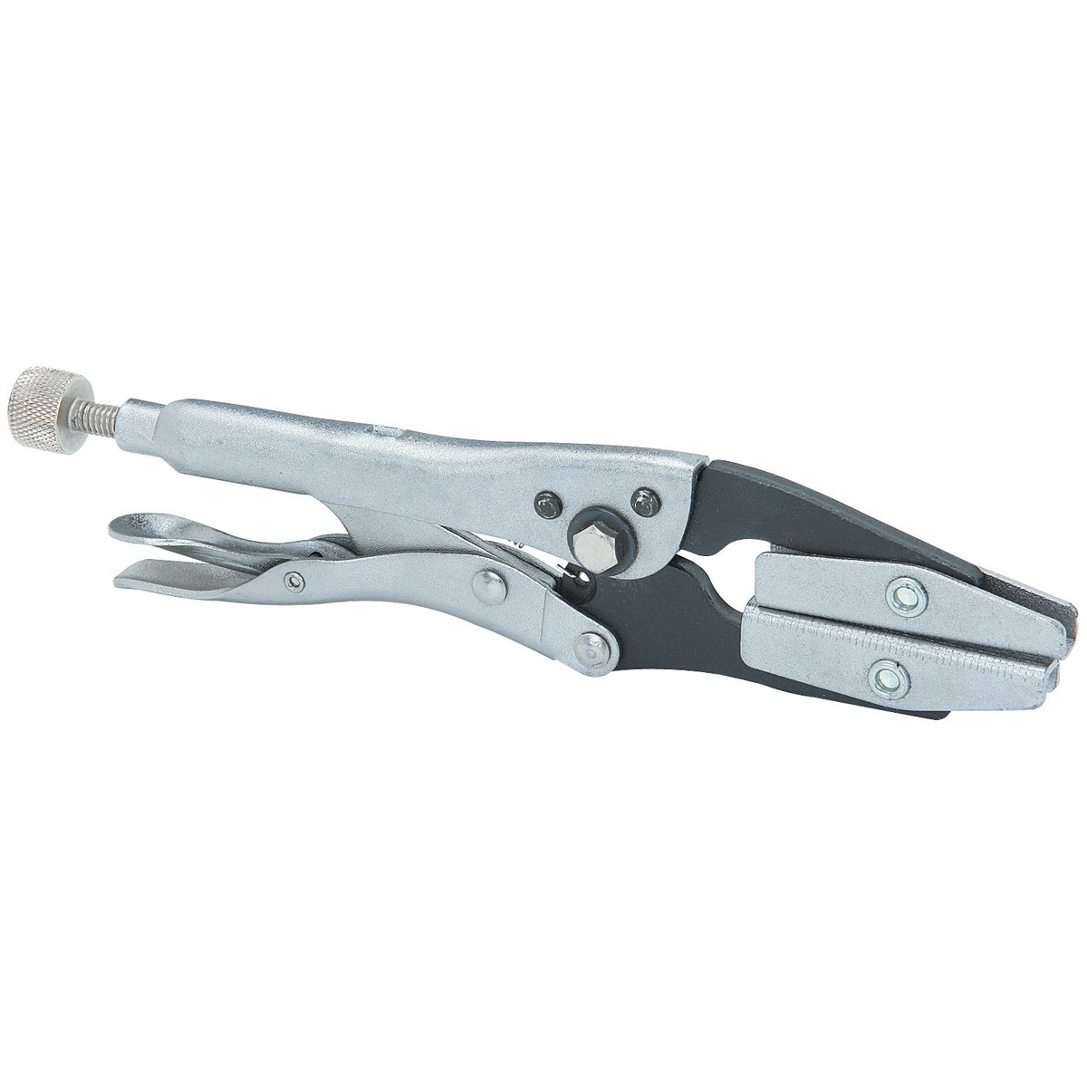

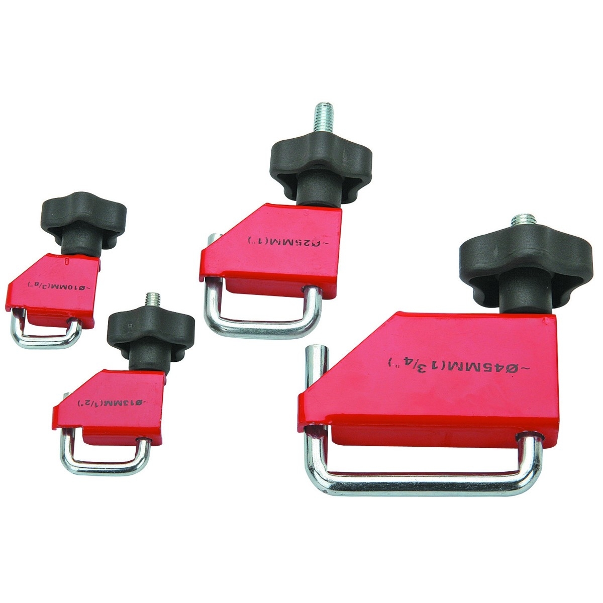

I would probably go under the hood and loop the core out of the system. Breathing that stuff can make you really sick. At the very least turn the temperature to cold and keep a window open if possible. The issue is that it could leak much worse at any time and dump hot coolant into the vehicle. A way to stop that would be to get a couple hose clamping pliers and just pinch the hoses closed. Something like what is pictured would work. Plus they would allow you to remove the core without draining the cooling system.
