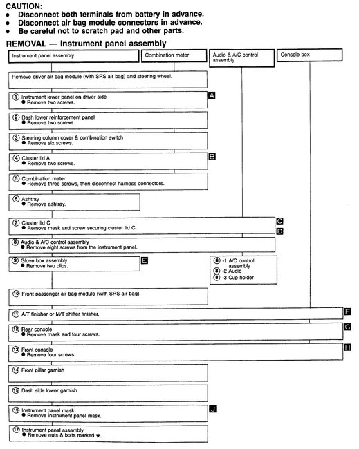

I do not have a video, but here are the directions. First, the core information:
Note: that the heater core is an integrated part of the heater unit, which is not a serviceable component and must be replaced as an assembly.
1. Drain and discharge cooling and A/C systems into approved recovery/recycling containers.
2. Remove instrument panel as outlined under "Dash Panel Service".
3. Remove instrument panel reinforcement.
4. Remove cooling unit, Fig. 10.
5. Remove heater unit.
6. Reverse procedure to install.

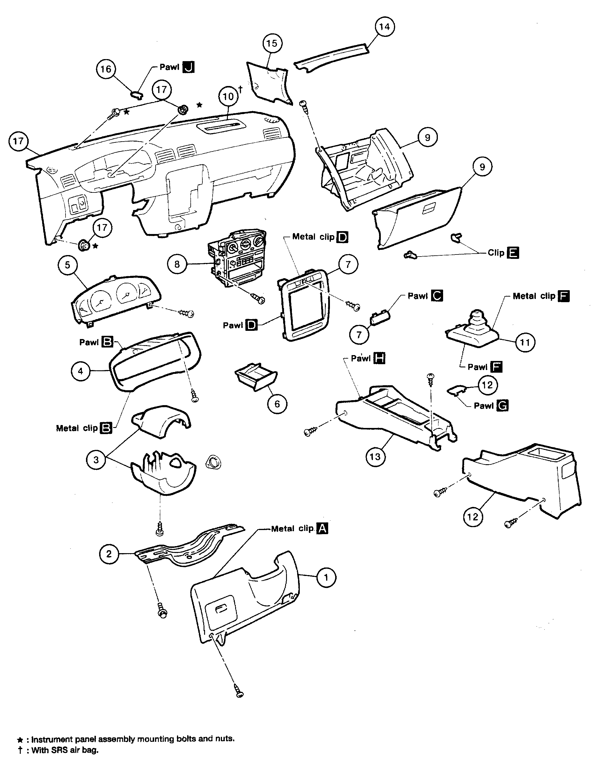

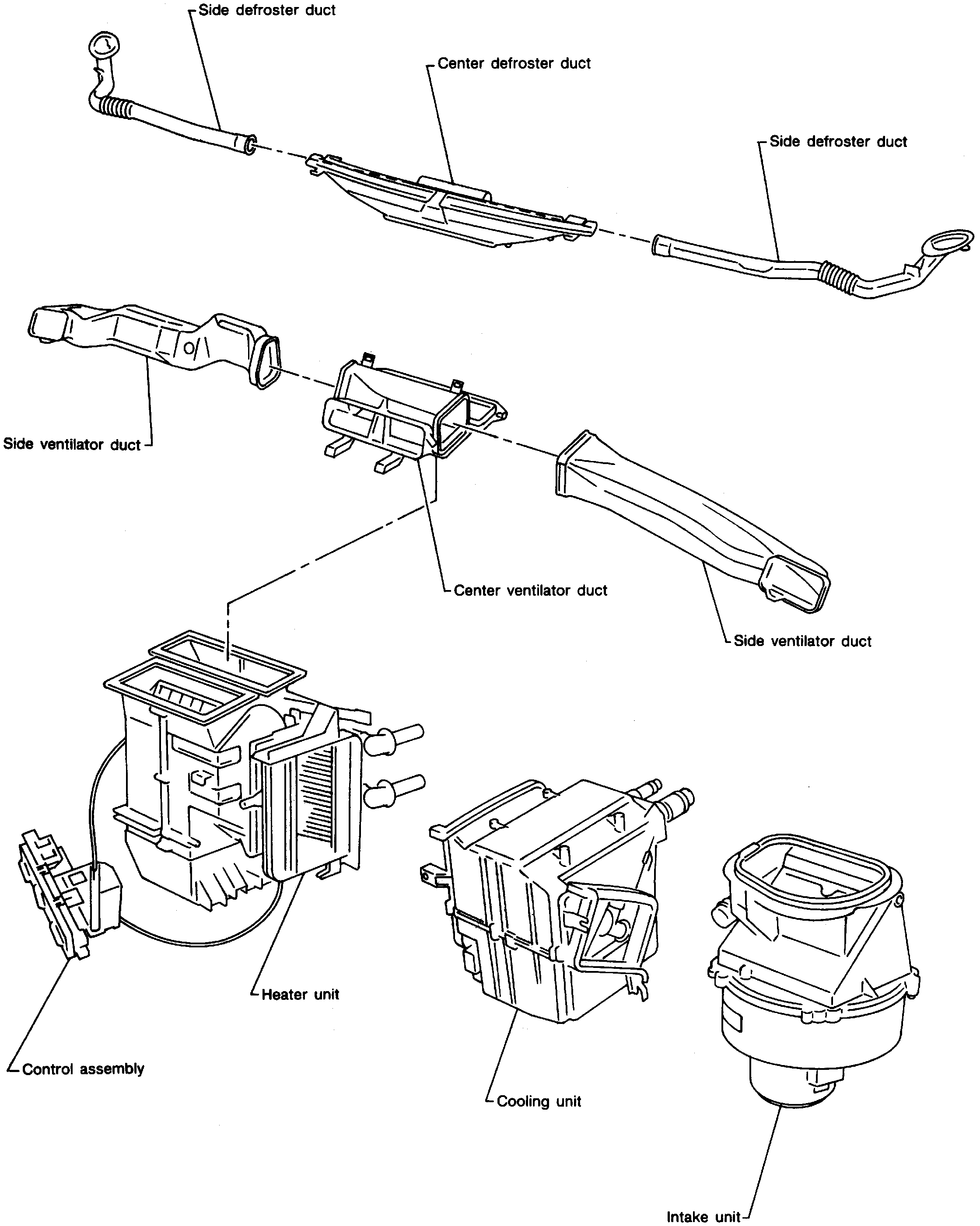

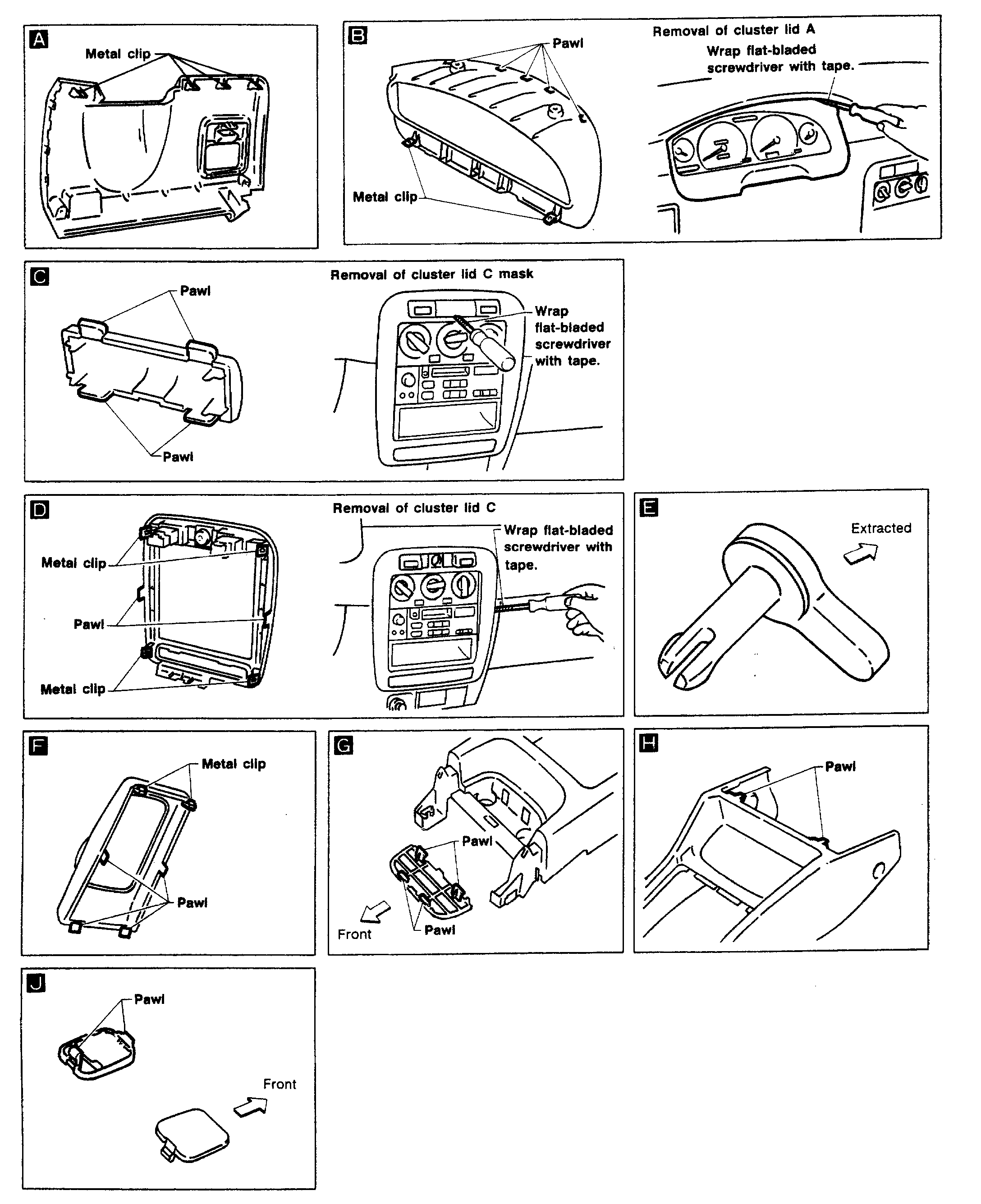

For dash panel removal, refer to pics 2, 3, 4

Check out the images (Below). Please let us know if you need anything else to get the problem fixed.
