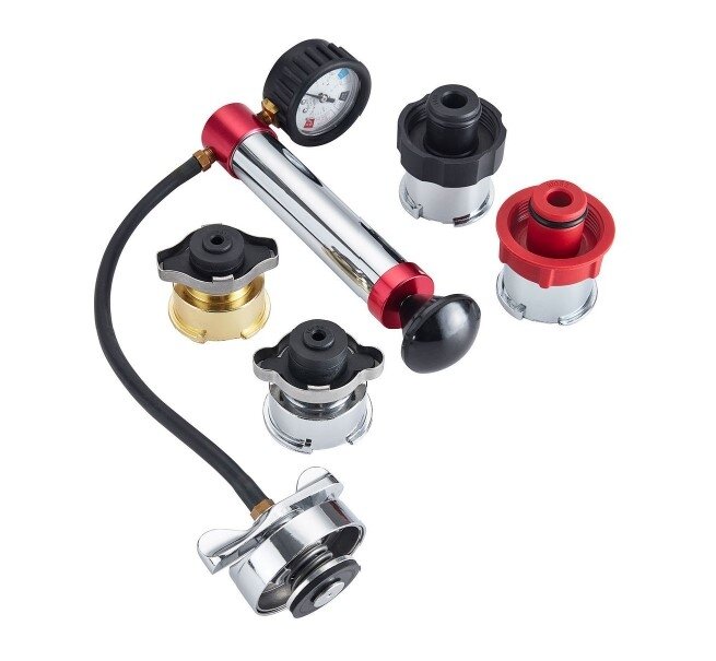

You will then need to refill with coolant and pressure test the system for any leaks. I will add a picture of this tool. It can be rented at your local auto parts store and is also available online. This will also help force coolant into the entire cooling system eliminating any air bubbles.
