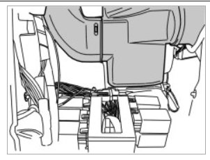

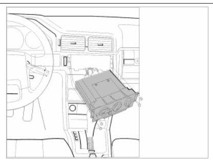

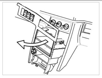

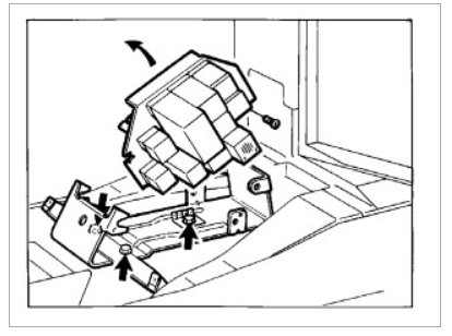

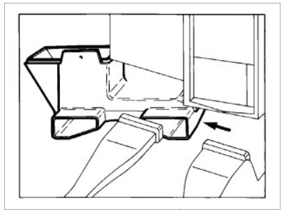

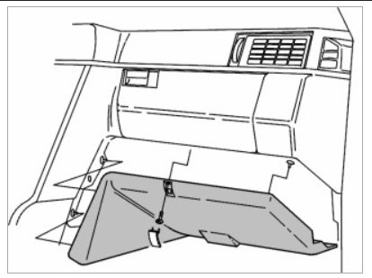

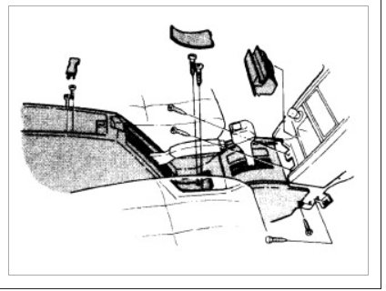

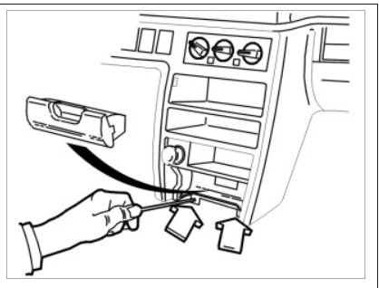

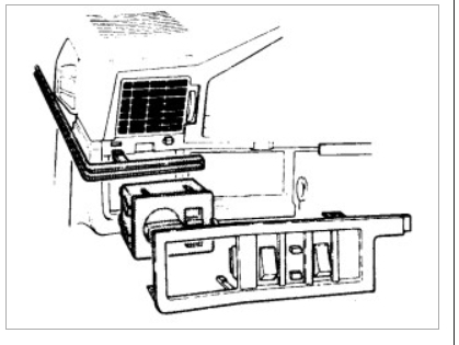

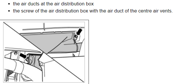

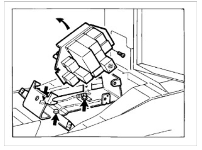

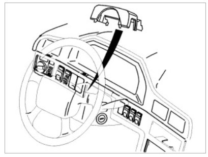

It is like my dad says it only nuts and bolts so you can do it if you set some time aside and we will be here for you if you run into trouble. Here is a guide that give you an idea of what you are in for when doing the job:
https://www.2carpros.com/articles/replace-heater-core

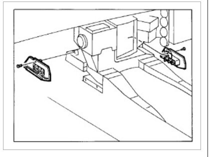

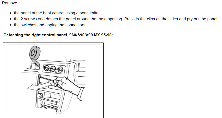

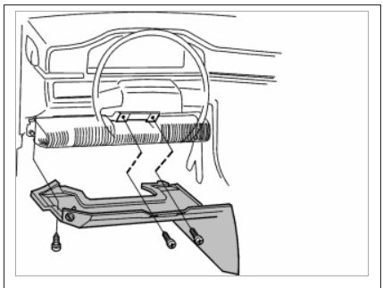

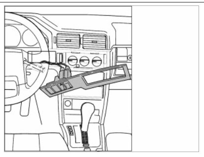

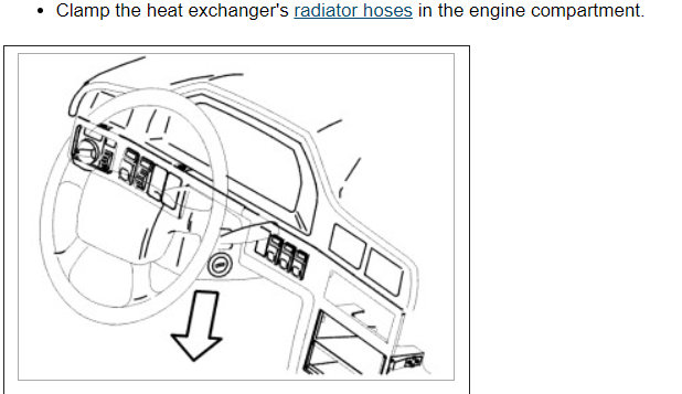

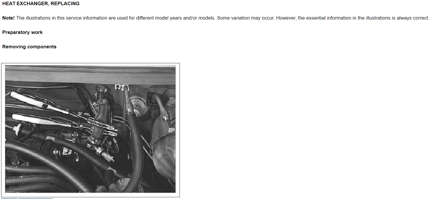

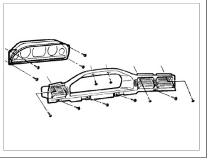

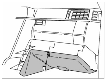

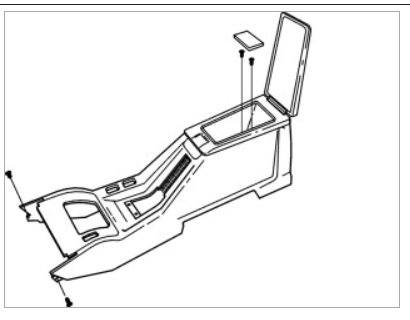

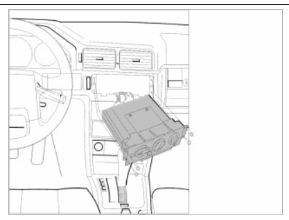

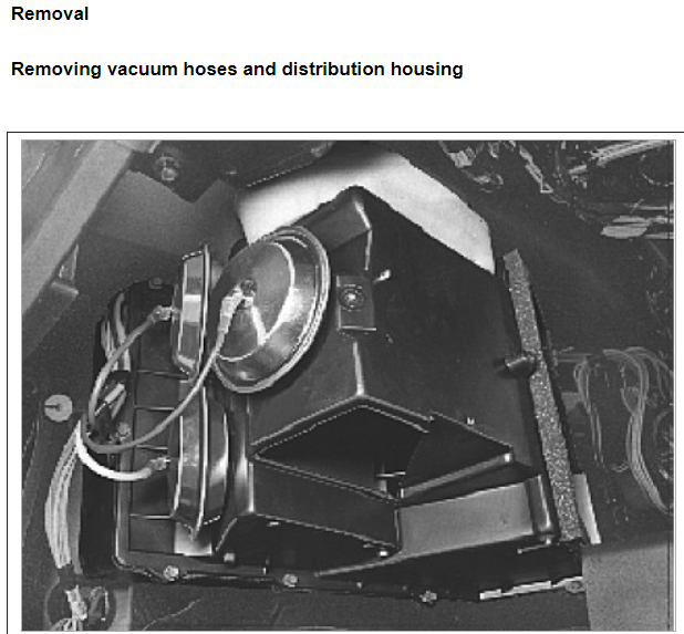

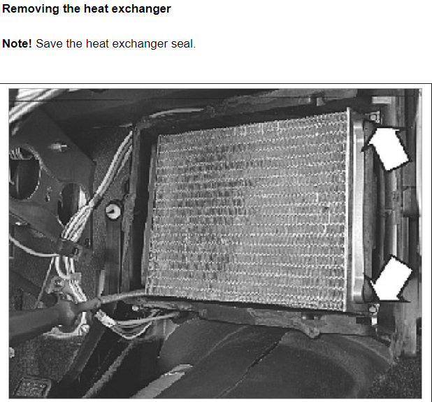

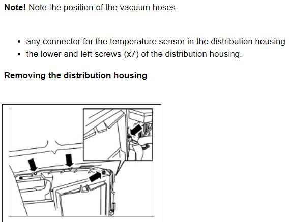

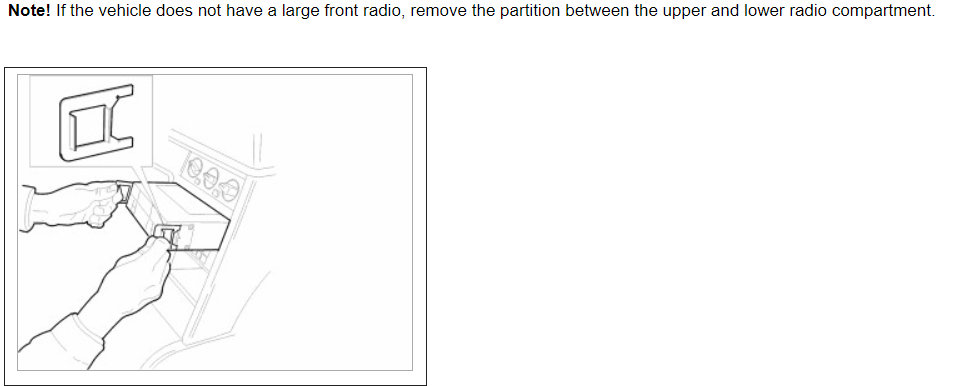

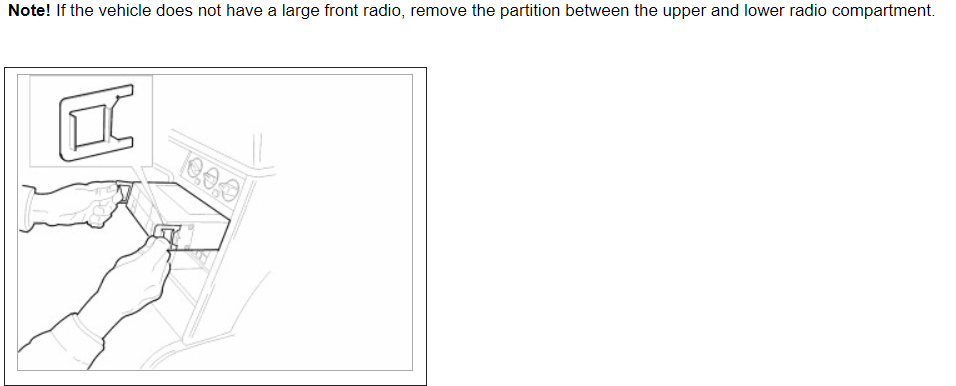

Here are diagrams (below) that show you what you are in for when doing the job on your car.
Check out the diagrams (below).
