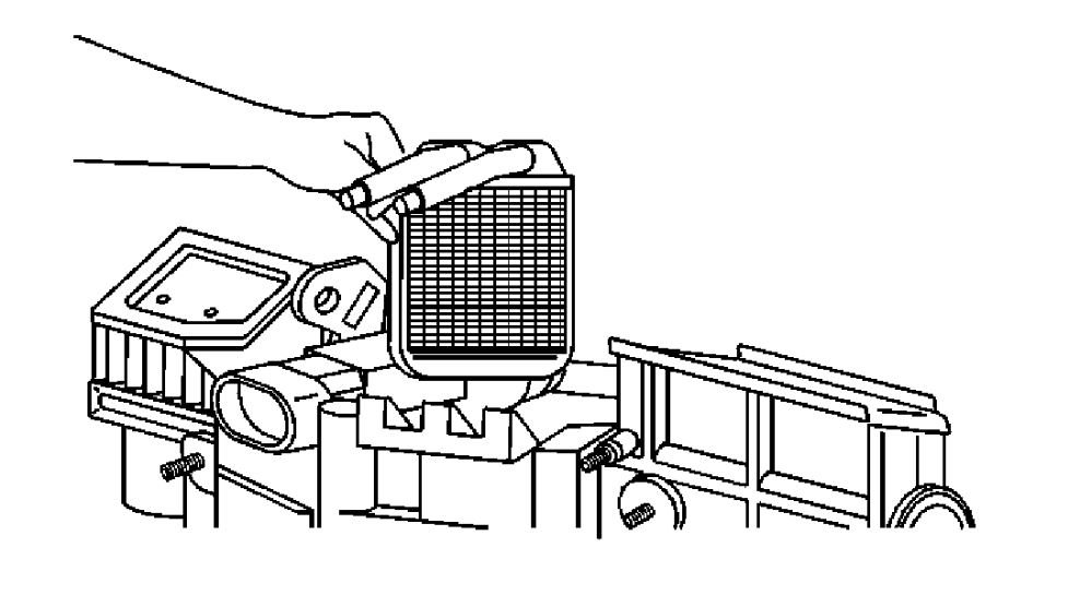

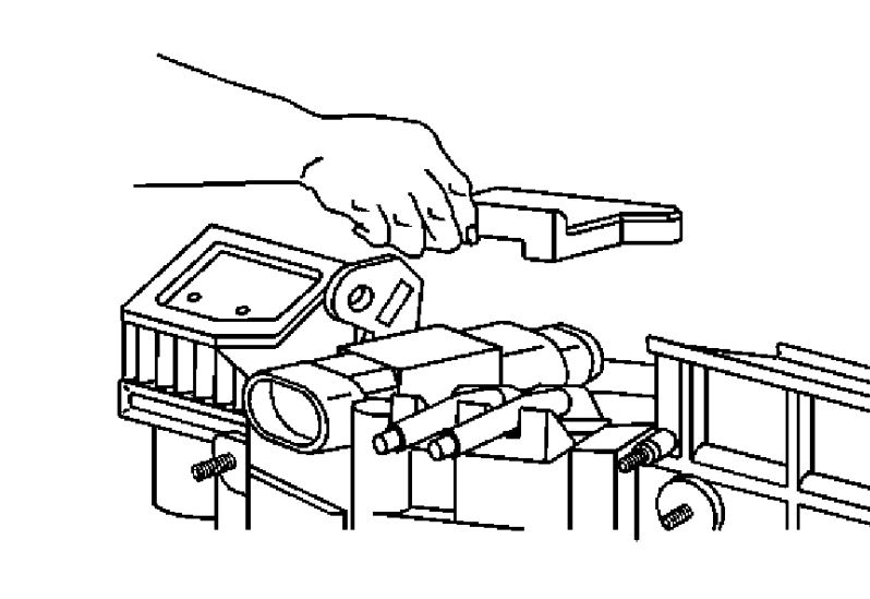

I have removed dash and fire wall nuts and screw but I still can't get to heater core.
Dec 25, 2019 at 1:33 PM
Good afternoon,
Do you have the heater box released? If not, can you post some pictures of where you are?
Dec 25, 2019 at 2:03 PM
I attached a YouTube video of the procedure for you.
It is better than the pictures that are provided in the manuals. It is an hour long but very good information.
https://www.youtube.com/watch?v=p9t7fRUs3uA
Let me know if you have any other questions.
