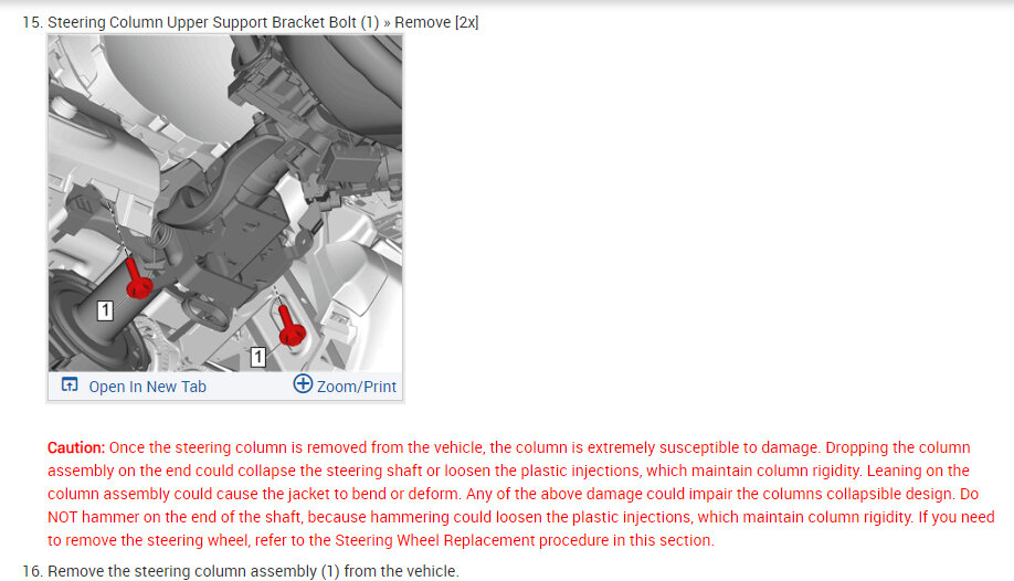

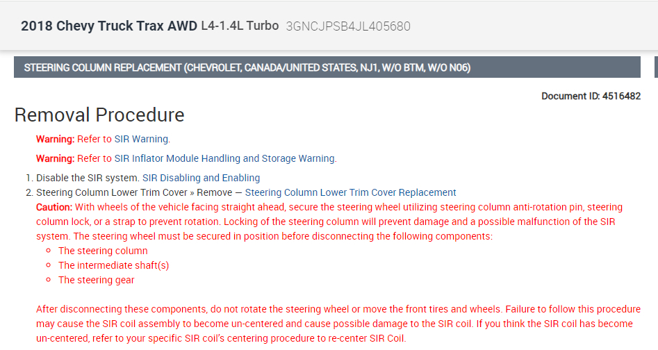

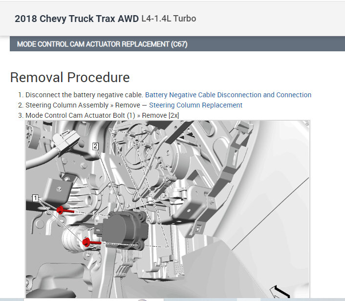

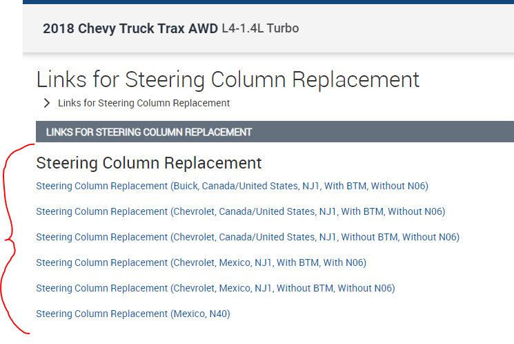

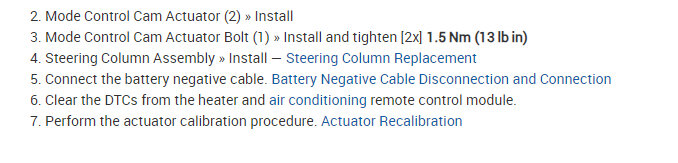

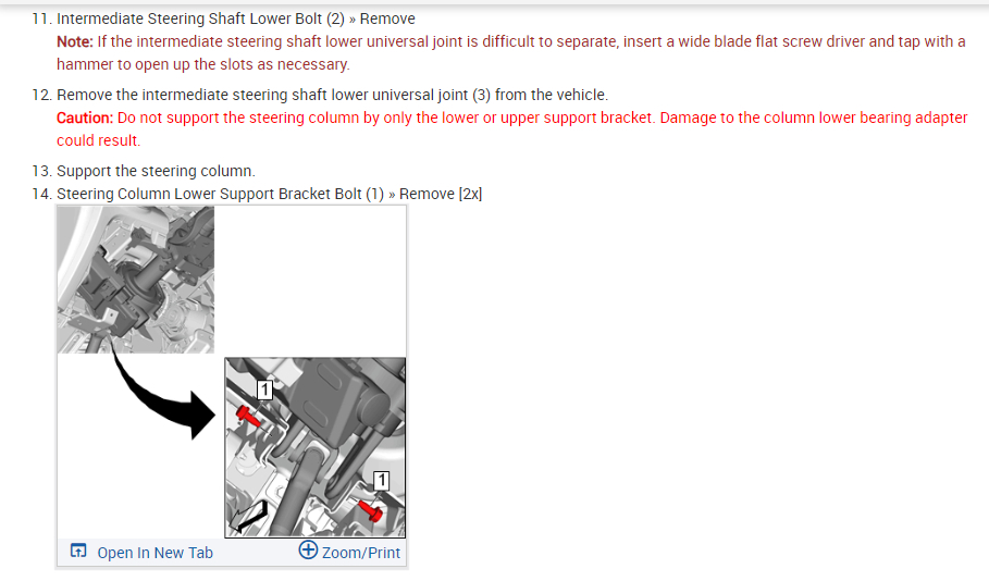

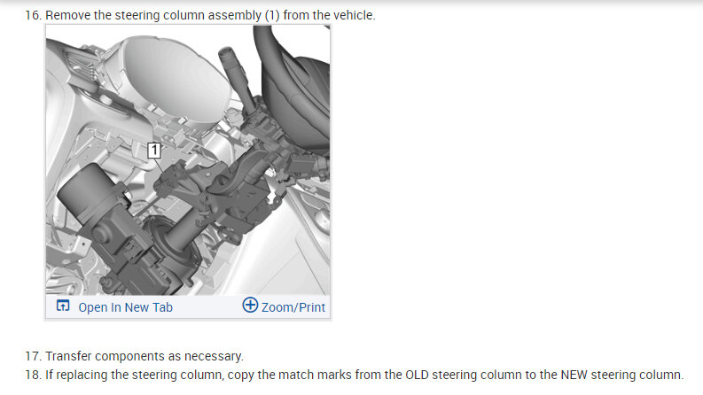

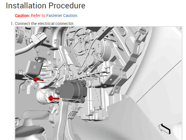

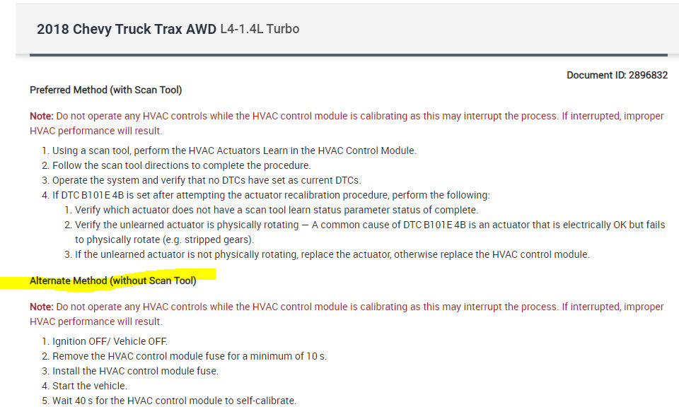

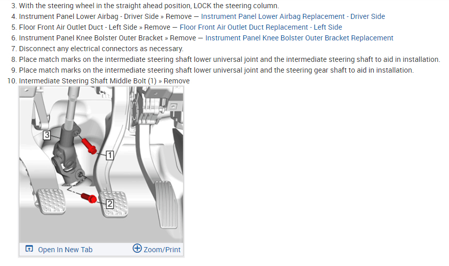

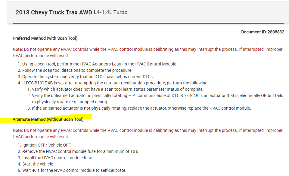

The first few pictures below are the directions for the actuator, once the column is removed. I ran into another roadblock. I need to know which column you have in your vehicle to get the correct directions. See last pic below. If you provide the VIN number, it should narrow that down for me. Otherwise, we will need to determine what the RPO numbers are for your vehicle.
Pic 5 provides the recalibration procedure without a scan tool.
See pics below.

Here's my VIN 3GNCJPSB4JL405680. Yeah, I can see this is not going to be fun.
Sep 19, 2024 at 4:30 AM
I believe I got the right one. It didn't narrow it down as much as I expected. When you do this, make sure the directions fit what you see. If they don't, let me know what is different. However, these should work.
See pic below.
